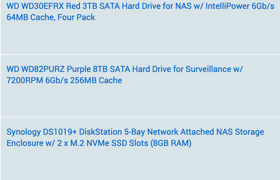

joth Posted August 26, 2020 Share Posted August 26, 2020 On 13/05/2020 at 10:05, joth said: On 12/05/2020 at 22:20, Thorfun said: I wouldn't bother with using 4 disks in a Raid 1 configuration though. the chances of 2 disks going in the time it takes to buy a new disk and replace a single failed drive is very slim! if you want a single disk just for the NVR then just configure 3 disks in a Raid 5 configuration leaving the one disk for the NVR. You'll end up with the same total capacity but still have a dedicated drive just for the NVR. Yeah - I went for Raid 10 across 4 drives mostly because my NAS is on Linux and I'm using btrfs which I love, but I don't fully trust its RAID 5 support (and probably never will as it looks like the winds are blowing towards zfs these days). Also I had some bad experience with Raid 5 on my old Infrant ReadyNAS that got slower over time but was a real pickle to convert back from. With the 1019+ my inclination would be same -- even start out with 4 or even three drives in Raid 5, put the NVR on it too, see how that goes and consider how to use the remaining 2 bays as space and speed demands evolve. On 13/05/2020 at 08:56, pocster said: Clicked the basket and went for the 1019+ I'll watch how you get on with interest! I'm sure 8GB RAM is plenty, but having seen the table above the lack of future expansion on this is the only hesitation I'd now have on it. (Full disclosure, I installed Home assistant on a Virtual Box VM (on ubuntu) yesterday , as they're deprecating the docker install I was using, and while it runs absolutely fine the act of carving out 2GB dedicated to the VM did make me twinge rather). Well... roll on a couple months (and a few surprise tangents in the conversation here : ) and I'm thinking about this topic again. Bizarrely because I decided to sell all my current AV and Sonos stuff and start over in the new house, and LMS (nee Squeezeserver) seems to be the winner, which is hilarious as this is what I used 15 years ago for multi room audio and it looks like I've gone full circle! It was a joy to unpack my old gen2 SqueezeBox and setup again, I bought it in 2006 and still supports every useful file format, and and now even Spotify streams to it great. (Alongside Sonos, it's the only system to let you mix and match local and spotify media. Even use local playlists as input to have spotify suggest variations) Anyway point here is I had to go through the motions on reinstalling software stacks few time, and tried out proxmox.com for managing VMs which I found really nice, along with portainer.io to manage docker containers. So I think this is the path for me rather than a proprietary NAS solution. But the i7 machine I put it on keeps burning out SSD drives so it will soon be time to get a proper server to host it all on. I'm looking at these 16-core Atom machines, may even enough to host my BlueIris Win10 VM too, TBC https://www.broadberry.co.uk/intel-atom-rackmount-servers/cyberserve-atom-104s Nice thing with that vs Xeon is it's very low energy draw when idle, and can spin up more cores as needed. (And it's several k£ cheaper) 1 Link to comment Share on other sites More sharing options...
