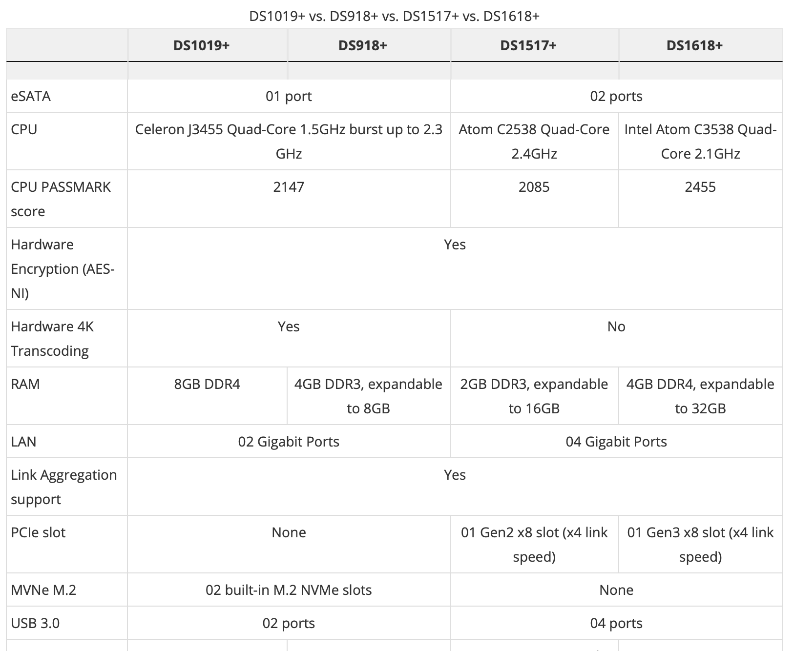

Pocster Posted May 12, 2020 Author Posted May 12, 2020 1 hour ago, pocster said: Think I'm leaning back to the 1019+ My plan was 4 drives for NAS allowing for upto 2 drives failling simultaneously. (so shr) 1 drive just for cctv (purple drive) so continually recoding ( so basic ). Is 1 drive likely to be a problem for 4/5 3MP ip camera's? oops! Wrong piccy!!
Thorfun Posted May 12, 2020 Posted May 12, 2020 1 hour ago, pocster said: oops! Wrong piccy!! it's hard to recommend what to get as it's such a personal thing and all depends on how much you want to spend and what it will also be used for etc. i.e. if you're going to use it for a media server using something like Plex for example, are those processors good enough to transcode video on the fly? or would you be better off trying to find something with an i3 or better cpu? I'm not sure how the Atom processors compare with the Celerons either but I'm sure there are benchmarks out there that can tell you. Although the specs seems to allude that if you are going to use it for something like that then the Celeron cpu seems to be able to handle it, assuming you believe the marketing that is! I'd say 2 network ports should be fine and having the 2 M.2 NVMe slots will help as you can add some SSD storage if/when funds become available. I use my slots (albeit via a PCIe card) as an SSD cache to speed up access to the HDDs but I don't know if Synology have this feature. so, all in all, on a basic comparison of those above I'd say the 918+ or 1018+ would suffice. I wouldn't bother with using 4 disks in a Raid 1 configuration though. the chances of 2 disks going in the time it takes to buy a new disk and replace a single failed drive is very slim! if you want a single disk just for the NVR then just configure 3 disks in a Raid 5 configuration leaving the one disk for the NVR. You'll end up with the same total capacity but still have a dedicated drive just for the NVR. if you are worried about losing all your data with 2 drives going then I'd simply advise to get some form of external HDD to backup your critical data to. I do this for my documents and photos. stuff that is too valuable to potentially lose. my movies and music and software can all be replaced but the photos and docs are irreplaceable. hope this helps. 1 1
Pocster Posted May 13, 2020 Author Posted May 13, 2020 10 hours ago, Thorfun said: it's hard to recommend what to get as it's such a personal thing and all depends on how much you want to spend and what it will also be used for etc. i.e. if you're going to use it for a media server using something like Plex for example, are those processors good enough to transcode video on the fly? or would you be better off trying to find something with an i3 or better cpu? I'm not sure how the Atom processors compare with the Celerons either but I'm sure there are benchmarks out there that can tell you. Although the specs seems to allude that if you are going to use it for something like that then the Celeron cpu seems to be able to handle it, assuming you believe the marketing that is! I'd say 2 network ports should be fine and having the 2 M.2 NVMe slots will help as you can add some SSD storage if/when funds become available. I use my slots (albeit via a PCIe card) as an SSD cache to speed up access to the HDDs but I don't know if Synology have this feature. so, all in all, on a basic comparison of those above I'd say the 918+ or 1018+ would suffice. I wouldn't bother with using 4 disks in a Raid 1 configuration though. the chances of 2 disks going in the time it takes to buy a new disk and replace a single failed drive is very slim! if you want a single disk just for the NVR then just configure 3 disks in a Raid 5 configuration leaving the one disk for the NVR. You'll end up with the same total capacity but still have a dedicated drive just for the NVR. if you are worried about losing all your data with 2 drives going then I'd simply advise to get some form of external HDD to backup your critical data to. I do this for my documents and photos. stuff that is too valuable to potentially lose. my movies and music and software can all be replaced but the photos and docs are irreplaceable. hope this helps. All help appreciated Clicked the basket and went for the 1019+ 1
Thorfun Posted May 13, 2020 Posted May 13, 2020 16 minutes ago, pocster said: All help appreciated Clicked the basket and went for the 1019+ sounds like you're as impatient as I am sometimes! enjoy and I hope it does the job. 1
Pocster Posted May 13, 2020 Author Posted May 13, 2020 14 minutes ago, Thorfun said: sounds like you're as impatient as I am sometimes! enjoy and I hope it does the job. The thing is with this and everything else with building a house you can go round and round . Reading , asking questions , then reading more ! . Eventually you have to purchase . I read up on those nas reviews last night ; watched some videos - so at some point gotta put your money where your mouth is ! Will report back once setup 1
Thorfun Posted May 13, 2020 Posted May 13, 2020 2 minutes ago, pocster said: The thing is with this and everything else with building a house you can go round and round . Reading , asking questions , then reading more ! . Eventually you have to purchase . and I'm sure I'll learn this as things progress for me.
joth Posted May 13, 2020 Posted May 13, 2020 11 hours ago, Thorfun said: I wouldn't bother with using 4 disks in a Raid 1 configuration though. the chances of 2 disks going in the time it takes to buy a new disk and replace a single failed drive is very slim! if you want a single disk just for the NVR then just configure 3 disks in a Raid 5 configuration leaving the one disk for the NVR. You'll end up with the same total capacity but still have a dedicated drive just for the NVR. Yeah - I went for Raid 10 across 4 drives mostly because my NAS is on Linux and I'm using btrfs which I love, but I don't fully trust its RAID 5 support (and probably never will as it looks like the winds are blowing towards zfs these days). Also I had some bad experience with Raid 5 on my old Infrant ReadyNAS that got slower over time but was a real pickle to convert back from. With the 1019+ my inclination would be same -- even start out with 4 or even three drives in Raid 5, put the NVR on it too, see how that goes and consider how to use the remaining 2 bays as space and speed demands evolve. 1 hour ago, pocster said: Clicked the basket and went for the 1019+ I'll watch how you get on with interest! I'm sure 8GB RAM is plenty, but having seen the table above the lack of future expansion on this is the only hesitation I'd now have on it. (Full disclosure, I installed Home assistant on a Virtual Box VM (on ubuntu) yesterday , as they're deprecating the docker install I was using, and while it runs absolutely fine the act of carving out 2GB dedicated to the VM did make me twinge rather). 1
Pocster Posted May 13, 2020 Author Posted May 13, 2020 16 minutes ago, joth said: Yeah - I went for Raid 10 across 4 drives mostly because my NAS is on Linux and I'm using btrfs which I love, but I don't fully trust its RAID 5 support (and probably never will as it looks like the winds are blowing towards zfs these days). Also I had some bad experience with Raid 5 on my old Infrant ReadyNAS that got slower over time but was a real pickle to convert back from. With the 1019+ my inclination would be same -- even start out with 4 or even three drives in Raid 5, put the NVR on it too, see how that goes and consider how to use the remaining 2 bays as space and speed demands evolve. I'll watch how you get on with interest! I'm sure 8GB RAM is plenty, but having seen the table above the lack of future expansion on this is the only hesitation I'd now have on it. (Full disclosure, I installed Home assistant on a Virtual Box VM (on ubuntu) yesterday , as they're deprecating the docker install I was using, and while it runs absolutely fine the act of carving out 2GB dedicated to the VM did make me twinge rather). Don’t need any VM stuff yet . So Cctv recording and file sharing being its main function . Full report soon ?
Thorfun Posted May 13, 2020 Posted May 13, 2020 1 hour ago, joth said: Yeah - I went for Raid 10 across 4 drives mostly because my NAS is on Linux and I'm using btrfs which I love, but I don't fully trust its RAID 5 support (and probably never will as it looks like the winds are blowing towards zfs these days). Also I had some bad experience with Raid 5 on my old Infrant ReadyNAS that got slower over time but was a real pickle to convert back from. With the 1019+ my inclination would be same -- even start out with 4 or even three drives in Raid 5, put the NVR on it too, see how that goes and consider how to use the remaining 2 bays as space and speed demands evolve. I'll watch how you get on with interest! I'm sure 8GB RAM is plenty, but having seen the table above the lack of future expansion on this is the only hesitation I'd now have on it. (Full disclosure, I installed Home assistant on a Virtual Box VM (on ubuntu) yesterday , as they're deprecating the docker install I was using, and while it runs absolutely fine the act of carving out 2GB dedicated to the VM did make me twinge rather). sorry, I didn't realise (or simply forgot) that the 1019+ is a 5-drive NAS! in that case I would probably suggest going for 4 x disks in a Raid 10 configuration as he'll benefit from better write AND read performance over RAID 5. then there is still the single drive for the NVR if required, or it can be configured as a hot spare. obviously, if you do configure the 4 x drives as RAID 10 you won't be able to add the extra spare drive if space becomes an issue as RAID 10 needs an even number of disks. Also RAID 10 will basically lose half the number of disks in total storage space. so 4 x 10TB disks in RAID 10 will give 20TB of usable space. whereas RAID 5 will lose only 1 disk and therefore give you 30TB of usable space. personally, I think 20TB should be enough and would rather go for RAID 10 to get the better read and write performance. but, then in that case and if the NVR is going to be part of the RAID 10 disks a 4-disk NAS might be better! see, it's never simple. this is a useful little RAID calculator (http://raid-calculator.com/default.aspx) that will show the benefits of the various RAID levels in case, like me, your memory can't remember them all! 1
Pocster Posted May 13, 2020 Author Posted May 13, 2020 46 minutes ago, Thorfun said: sorry, I didn't realise (or simply forgot) that the 1019+ is a 5-drive NAS! in that case I would probably suggest going for 4 x disks in a Raid 10 configuration as he'll benefit from better write AND read performance over RAID 5. then there is still the single drive for the NVR if required, or it can be configured as a hot spare. obviously, if you do configure the 4 x drives as RAID 10 you won't be able to add the extra spare drive if space becomes an issue as RAID 10 needs an even number of disks. Also RAID 10 will basically lose half the number of disks in total storage space. so 4 x 10TB disks in RAID 10 will give 20TB of usable space. whereas RAID 5 will lose only 1 disk and therefore give you 30TB of usable space. personally, I think 20TB should be enough and would rather go for RAID 10 to get the better read and write performance. but, then in that case and if the NVR is going to be part of the RAID 10 disks a 4-disk NAS might be better! see, it's never simple. this is a useful little RAID calculator (http://raid-calculator.com/default.aspx) that will show the benefits of the various RAID levels in case, like me, your memory can't remember them all! Was going to have 4 drives as shr - as it allows a failed drive to be replaced with any capacity drive . Drive 5 will just be nvr ; no raid . Any important video stuff I would copy off to the raid anyway . Of course for our younger viewers ... “A raid nas is not an alternative to a proper backup feature “ . I’ll probably copy valuable data off the raid to another raid drive ( cheap 1tb type thing )or usb drive . In turn will all copy off to a usb stick . So to lose everything would require 4 drives to fail in nas 1 . 2 drives to fail on nas 2 , usb drive to fail . Usb stick to fail ??
Thorfun Posted May 13, 2020 Posted May 13, 2020 7 minutes ago, pocster said: Was going to have 4 drives as shr - as it allows a failed drive to be replaced with any capacity drive . Drive 5 will just be nvr ; no raid . Any important video stuff I would copy off to the raid anyway . Of course for our younger viewers ... “A raid nas is not an alternative to a proper backup feature “ . I’ll probably copy valuable data off the raid to another raid drive ( cheap 1tb type thing )or usb drive . In turn will all copy off to a usb stick . So to lose everything would require 4 drives to fail in nas 1 . 2 drives to fail on nas 2 , usb drive to fail . Usb stick to fail ?? can't you use your 'old' NAS as a backup server? unless you're going to sell it of course you might as well put it to good use!
Pocster Posted May 13, 2020 Author Posted May 13, 2020 1 hour ago, Thorfun said: can't you use your 'old' NAS as a backup server? unless you're going to sell it of course you might as well put it to good use! Yep it will be nas 2 a copy of essential files from nas 1 1
Pocster Posted May 16, 2020 Author Posted May 16, 2020 (edited) Well! I set my Synology DS1019+ up! 1 drive for nvr ( so no raid or anything) the other 4 for shr. Only just realised that the 4 drive as shr will only allow for 1 drive failure. AFAIK I need to unmount those 4 drives. Physically remove a drive. Set them up as shr (just the 3 now). Then add the 4th drive and magically shr-2 (2 drive failure) will be supported. There's nothing on those NAS drives so not an issue. 2 camera's continually streaming seems to cause very little cpu load. Ram used is around 6%, cpu sits at around 9%. So it's good to know the system isn't straining. The camera's are streaming at 4MP. I intended at least another 2. Synology DSM software seems pretty decent - certainly better than some dedicated NVR stuff. Not without a few issues which seem to be browser based ( worked fine in Chrome, then live view didn't; swapped to Safari and it seems perfect - though it suggests swapping to Chrome!). Remote viewing via the app seems pretty good. Though I need to fiddle with it to improve performance. Also have security spy on my HA mac - this provides an interface to the HA. So I can 'do something' when motion etc. is triggered. Both camera's are Hikvision. The Hikvision DS-2CD2563G0-IS/B seems maybe problematic . Edited May 16, 2020 by pocster 1
