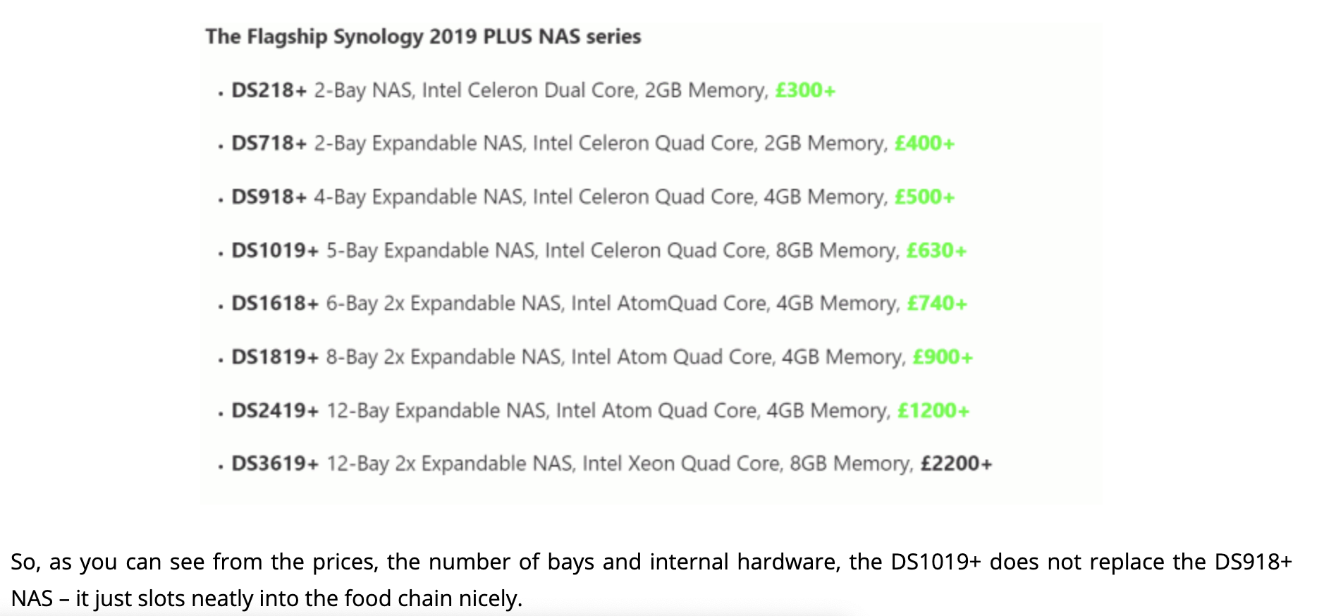

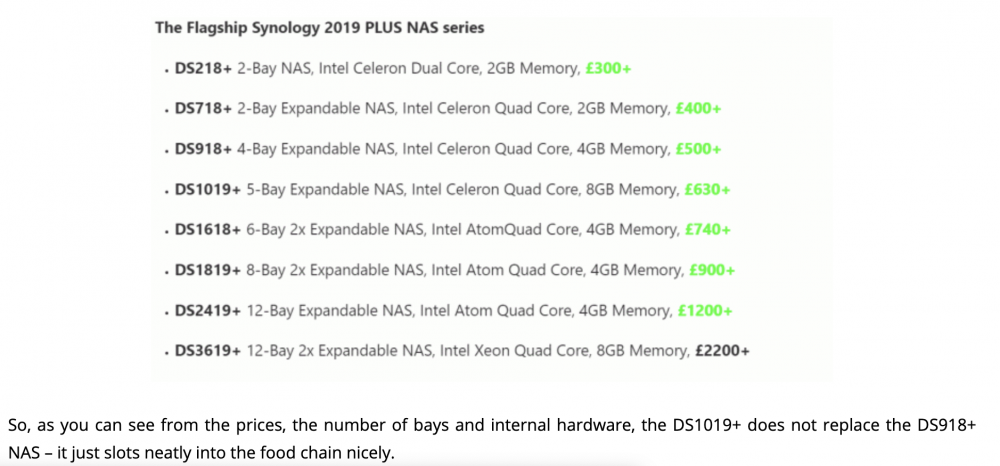

joth Posted May 10, 2020 Posted May 10, 2020 1 hour ago, pocster said: Hmmmmm DS1618+ seems better !! For pure storage, maybe, but the 1019+ has more RAM and beefier CPU so probably better if doing a lot of CCTV or media transcoding or VMs (or combinations thereof) https://nascompares.com/2019/02/15/synology-ds1019-vs-ds918-nas-which-should-you-buy/ has a table half way down that compares a lot of the range: 1

Thorfun Posted May 10, 2020 Posted May 10, 2020 2 minutes ago, joth said: For pure storage, maybe, but the 1019+ has more RAM and beefier CPU so probably better if doing a lot of CCTV or media transcoding or VMs (or combinations thereof) https://nascompares.com/2019/02/15/synology-ds1019-vs-ds918-nas-which-should-you-buy/ has a table half way down that compares a lot of the range: if you're wanting to do any VMs then 8GB is not enough! especially if they're Windows VMs as Windows is a memory hog. but, I'm a techie and like playing. I'm sure 'normal' people don't need half the things I have. ?♂️
