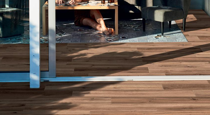

Mr Punter Posted May 6, 2020 Posted May 6, 2020 Easy to do and very effective with a wood effect porcelain tile but far more tricky with timber, where it will fade to grey when exposed.
Tony K Posted May 6, 2020 Author Posted May 6, 2020 54 minutes ago, Mr Punter said: This kind of thing but the legs are extra That's very interesting. I hadn't even thought of that kind of thing. What are 'legs' in this context please?
Mr Punter Posted May 6, 2020 Posted May 6, 2020 2 minutes ago, Tony K said: What are 'legs' in this context please? Umm the pair of fleshy looking things under the coffee table...
Tony K Posted May 6, 2020 Author Posted May 6, 2020 3 minutes ago, Mr Punter said: Umm the pair of fleshy looking things under the coffee table... Ha! I thought it was some technical term, a bit of kit required to install the tiles! I'm allowed to vote and drive a car you know..... 1

Bitpipe Posted May 7, 2020 Posted May 7, 2020 11 hours ago, Mr Punter said: This kind of thing but the legs are extra On closer inspection that looks like a wood effect ceramic tile - which would be much more practical given it has a consistent thickness and should be usable outside.
Tony K Posted May 7, 2020 Author Posted May 7, 2020 3 hours ago, Bitpipe said: On closer inspection that looks like a wood effect ceramic tile - which would be much more practical given it has a consistent thickness and should be usable outside. It is. @Mr Punter has confirmed, and looking at his photo I'm certainly interested in using that method. In my project the outside floor area was going to be a raised timber deck with a 700mm storage void underneath, accessed through this kind of thing: If I use the tiles however I'd presume I would be better with a solid patio base. That's fine, I'll do that and create voids, accessed with these kind of manhole covers into which tiles can be set:

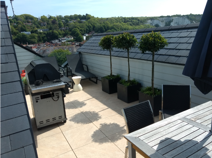

Mr Punter Posted May 7, 2020 Posted May 7, 2020 The photo was just copied from a website https://www.marazzitile.co.uk/collections/treverkheart/ but I have not used them On our roof terrace we have some 20mm thick porcelain on adjustable feet but not wood effect. Allows the water to drain away.
Tony K Posted May 7, 2020 Author Posted May 7, 2020 2 hours ago, Mr Punter said: The photo was just copied from a website https://www.marazzitile.co.uk/collections/treverkheart/ but I have not used them On our roof terrace we have some 20mm thick porcelain on adjustable feet but not wood effect. Allows the water to drain away. I imagine the wood effect ones would not lend themselves to sitting on adjustable feet, and would instead have to have a very slight run away from the property threshold.
