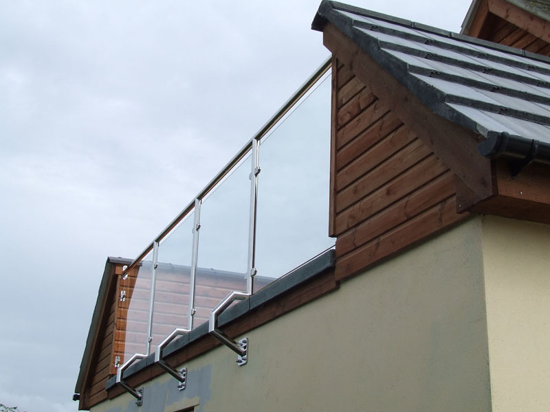

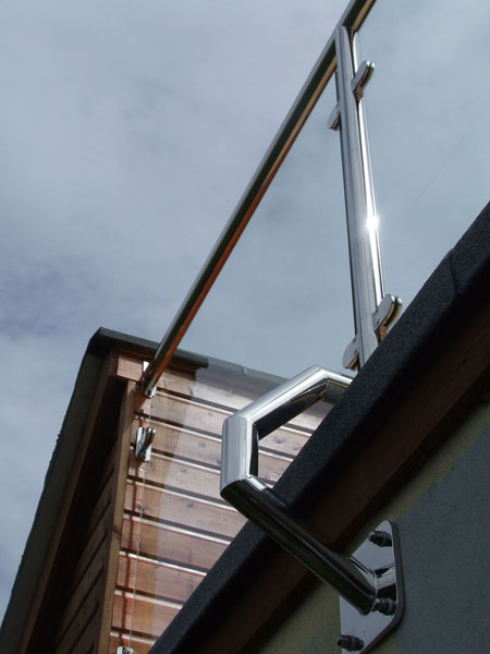

Nickfromwales Posted August 15, 2017 Share Posted August 15, 2017 57 minutes ago, Grosey said: Thanks Nick, a few people have mentioned cranked uprights but I can't find anything online, certainly not in any sort of modern stainless steel style? Go bespoke, as you'll find these aren't exactly off the shelf items, ( but I've been proven wrong, and usually by my pie-hating nemesis @PeterW ). Fyi, these are just simple cranked stainless tube, with a couple of tabs welded on . 1 Link to comment Share on other sites More sharing options...

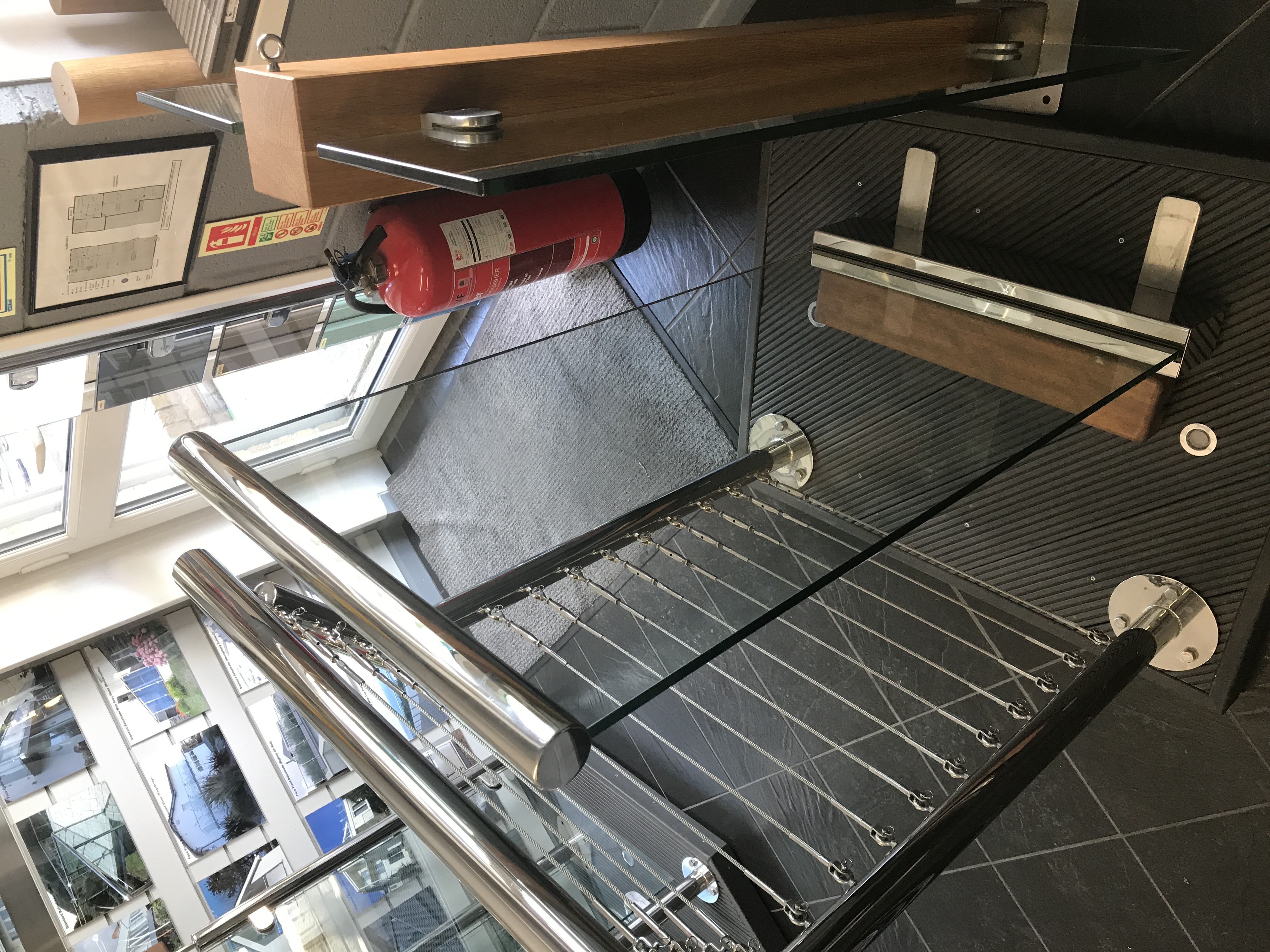

Grosey Posted August 15, 2017 Author Share Posted August 15, 2017 I think these photos have already put me off cranked uprights, although they've done a tidy job, just too much of a beast of a thing to have in my setting. However im going to take a drive over to that place now @Onoff and see what they've got to say, thanks for the find! Link to comment Share on other sites More sharing options...
Onoff Posted August 15, 2017 Share Posted August 15, 2017 22 minutes ago, Grosey said: However im going to take a drive over to that place now @Onoff and see what they've got to say, thanks for the find! Happy to spend someone else's money help! I thought it might be local 'ish. Their previous work does look good I think. If you were looking to limit stresses from the handrail affecting the deck you could consider still having raised pads but with a subtle weathering cowl in st/st on the base of the standard. Link to comment Share on other sites More sharing options...

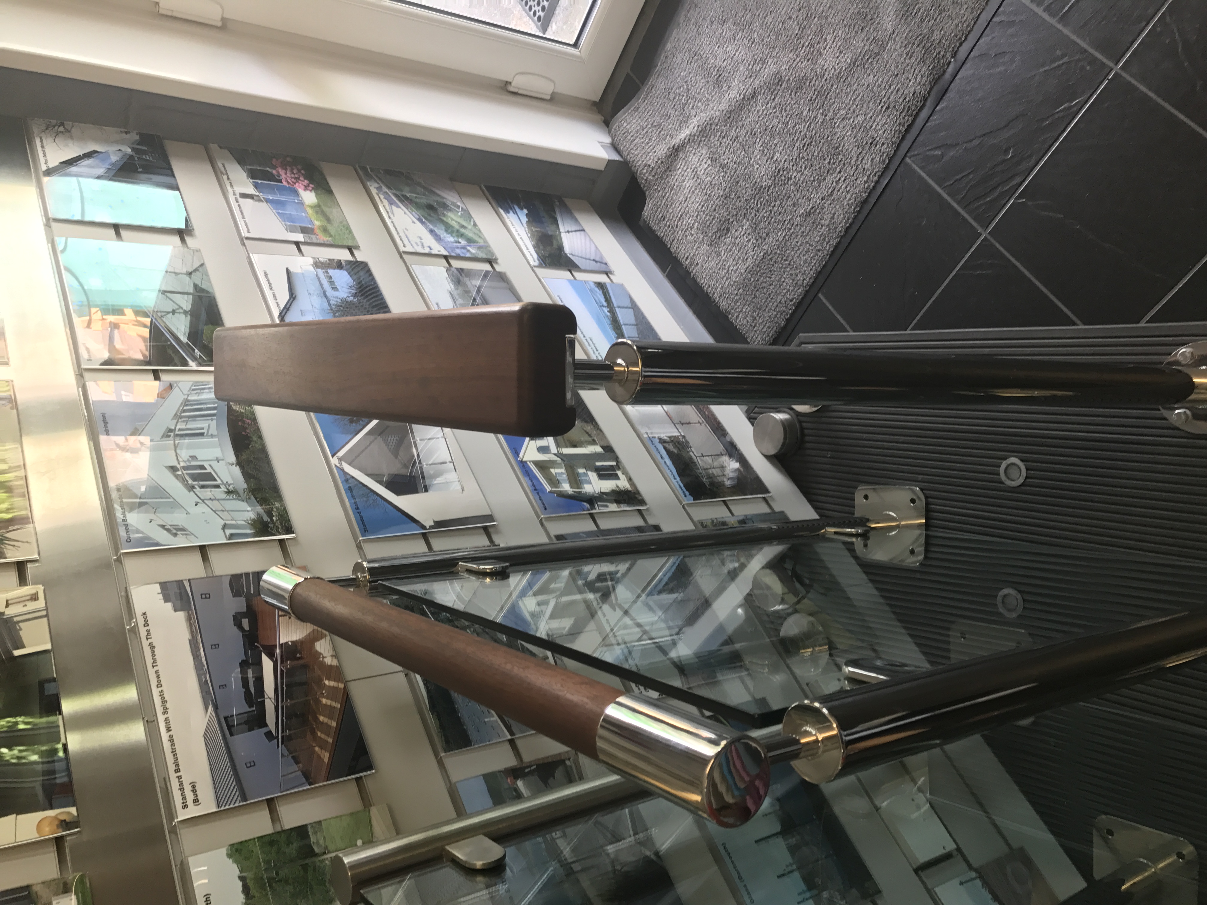

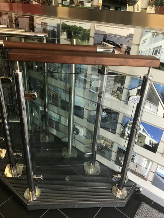

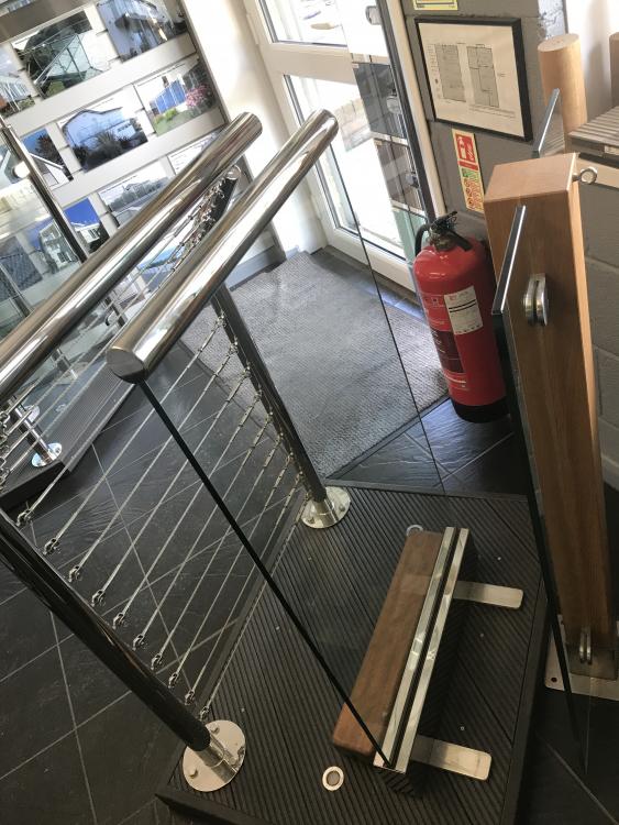

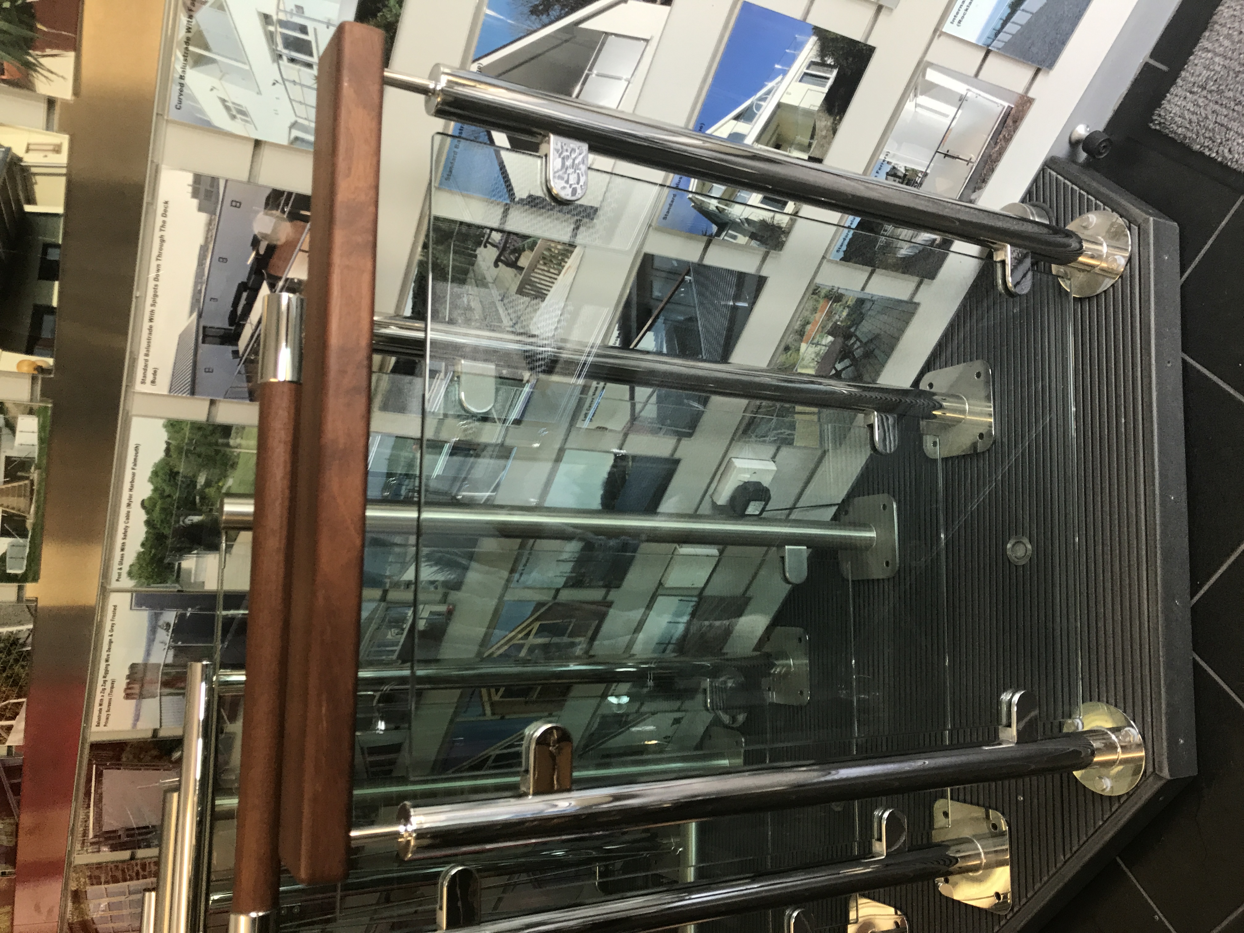

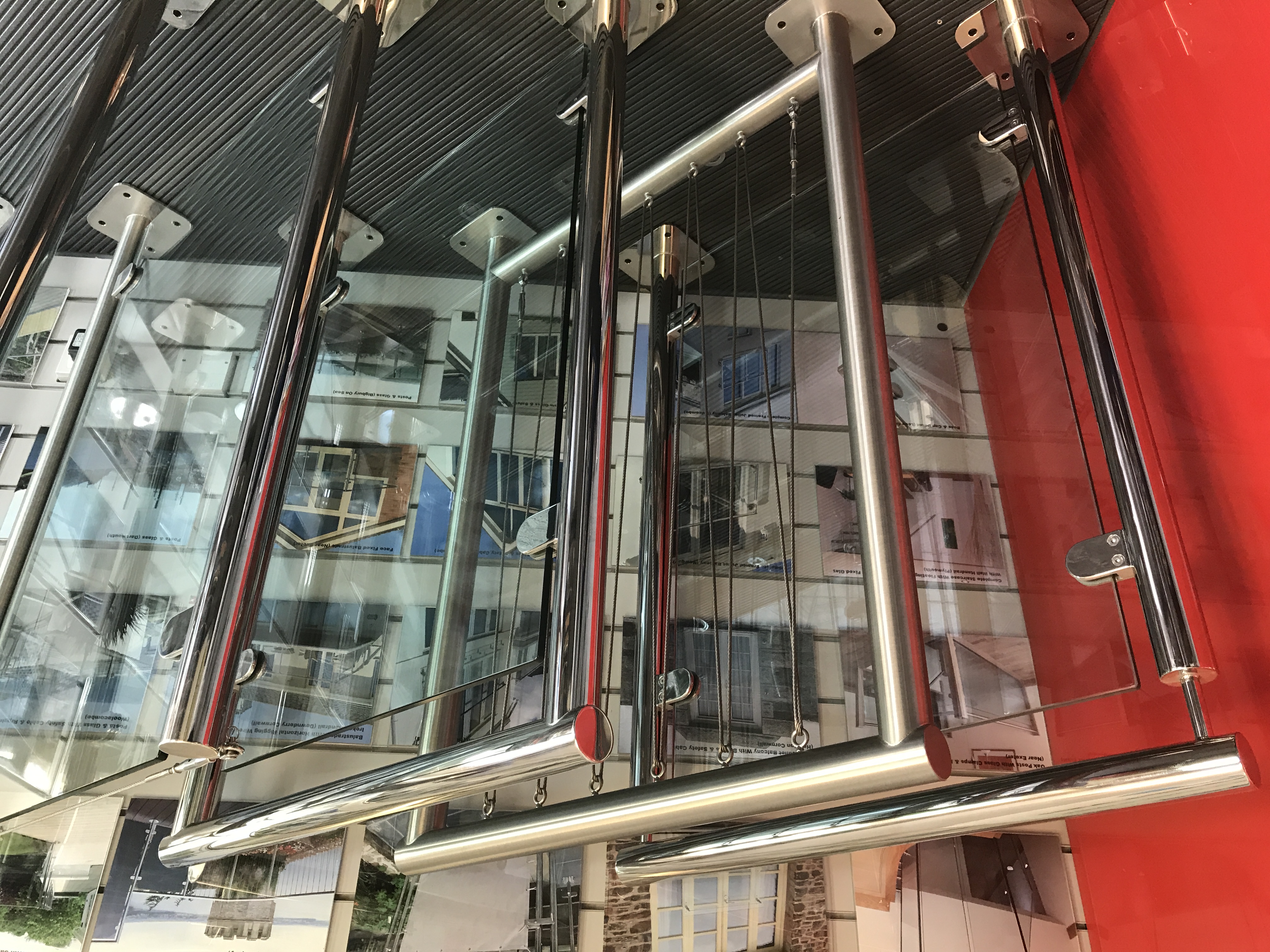

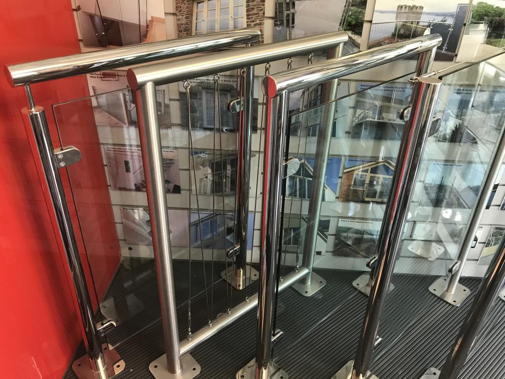

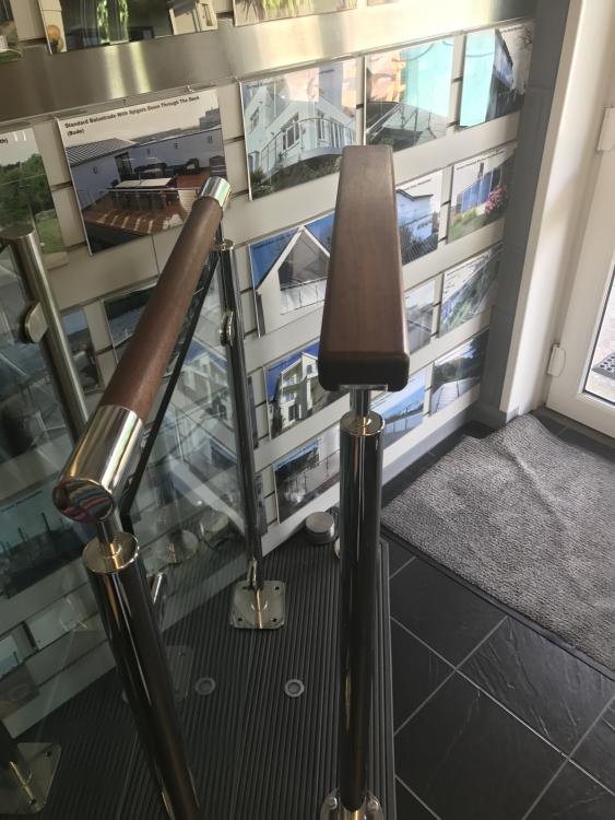

Grosey Posted August 15, 2017 Author Share Posted August 15, 2017 2 hours ago, Onoff said: Happy to spend someone else's money help! I thought it might be local 'ish. Their previous work does look good I think. If you were looking to limit stresses from the handrail affecting the deck you could consider still having raised pads but with a subtle weathering cowl in st/st on the base of the standard. Decent looking place, small showroom but nice examples of their work. And lots of work on show outside as guys had moved the workshop outside to enjoy the sun. I've given them some dimensions and will await a rough quote back, then arrange a site survey to discuss how to actually attach the bloody thing. I do really like this example from their showroom with the hardwood handrail, could tie in nicely with my cladding. 1 Link to comment Share on other sites More sharing options...
