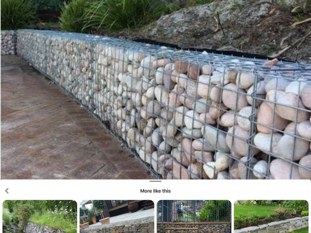

I have looked through the topics but not found anybody doing this. I have a ringbeam that sits above ground level in large parts of the site so the plinths wall for the block and beam floor sits on top of the exposed ground beam , which gives a sort of plinths at the end. I am unsure how to go about with covering this exposed ring beam . Normally would be covered by soil/backfill obviously and just the walls coming out above visible. Anybody done this or came across a project like this?

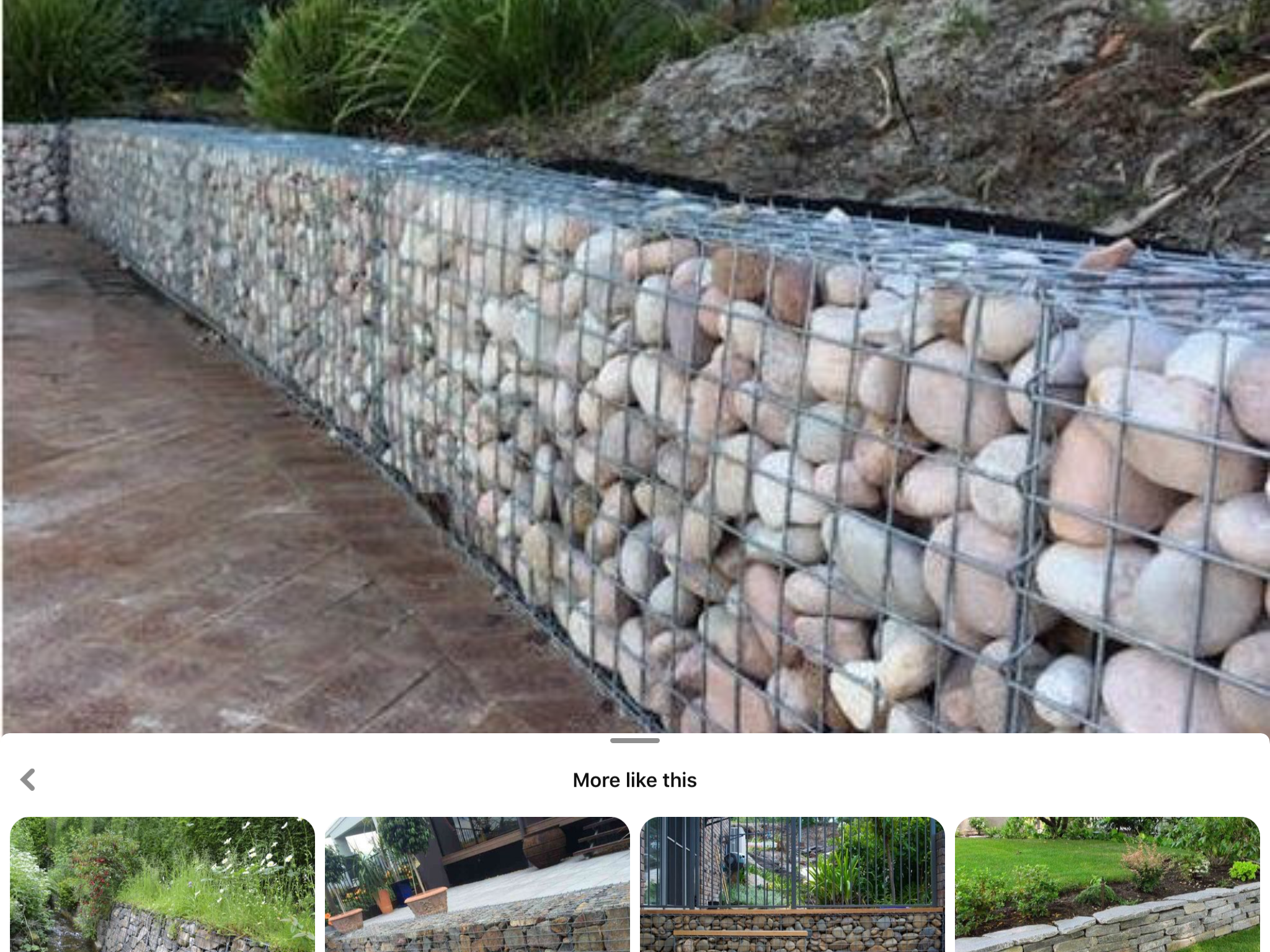

1D411B17-AA71-49C2-82DC-DC2582EEF2AF.thumb.png.3059a5f9f6c4890d2fdd0471c3e8e364.pngGet some of the steel they use for gabion baskets
make a basket that is only 150mm deep
fix it against the ring beam
select some nice stone
fill baskets so it looks like you have a nice plinth of stone around the house.
