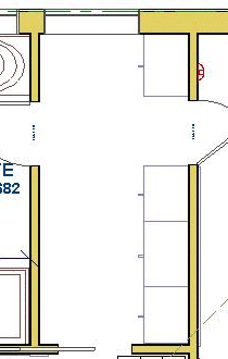

1/ Moving windows
Compared to the current "final design" as created by the architect, we have already updated our views a little, for example we have a walk-in closet whose orientation we intend to flip.
Presumably Planning people don't care too much about internal design changes, but as you can see this example has implications for where the window goes.
Would "people" (neighbours? planning officers? building officials?) care if we made minor modifications such as this without extra planning permission rounds? Of course I get that minor changes can become majorish and then major at some point, but let's say just shuffling windows around 50cm to and fro?

Is the window at front or back of the house? Does it look better or odd when moved?
Back of the house, and no major oddness. A little I suppose, rather than spaced evenly one window would now be a bit closer to the other.

1. Window move. You might get away with a small move without an amendment, but that is large enough that it should probably have an amendment. Why not just change now to avoid future cost and time.
Tempted to agree with you. Can you define 'small' though? The moves I'm thinking about are 50cm either direction
I suspect legally speaking almost anything would officially be an amendment, but if it is so small no one would notice then I think you can get away with it. I would probably put this in the 10-20cm range.
