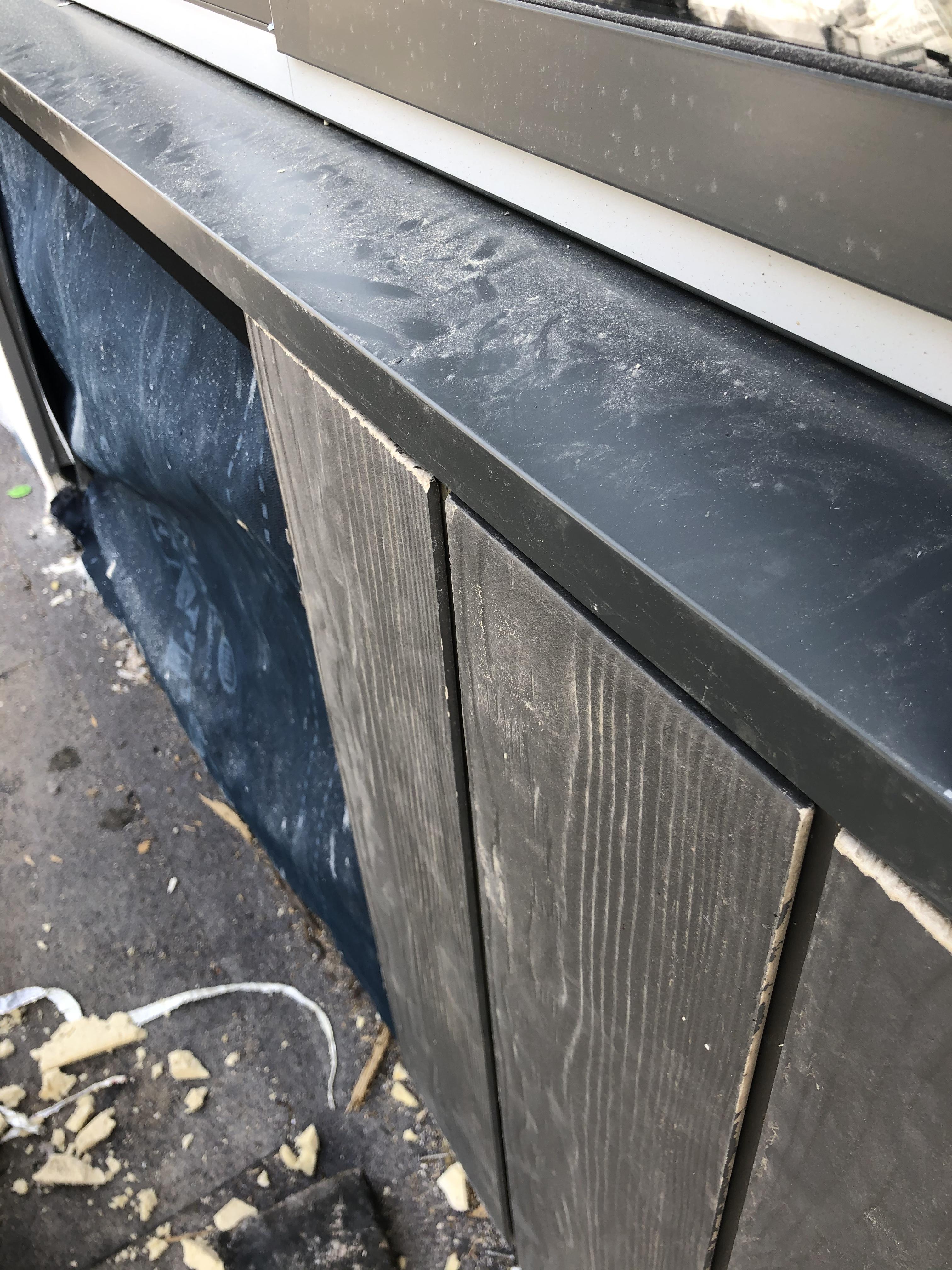

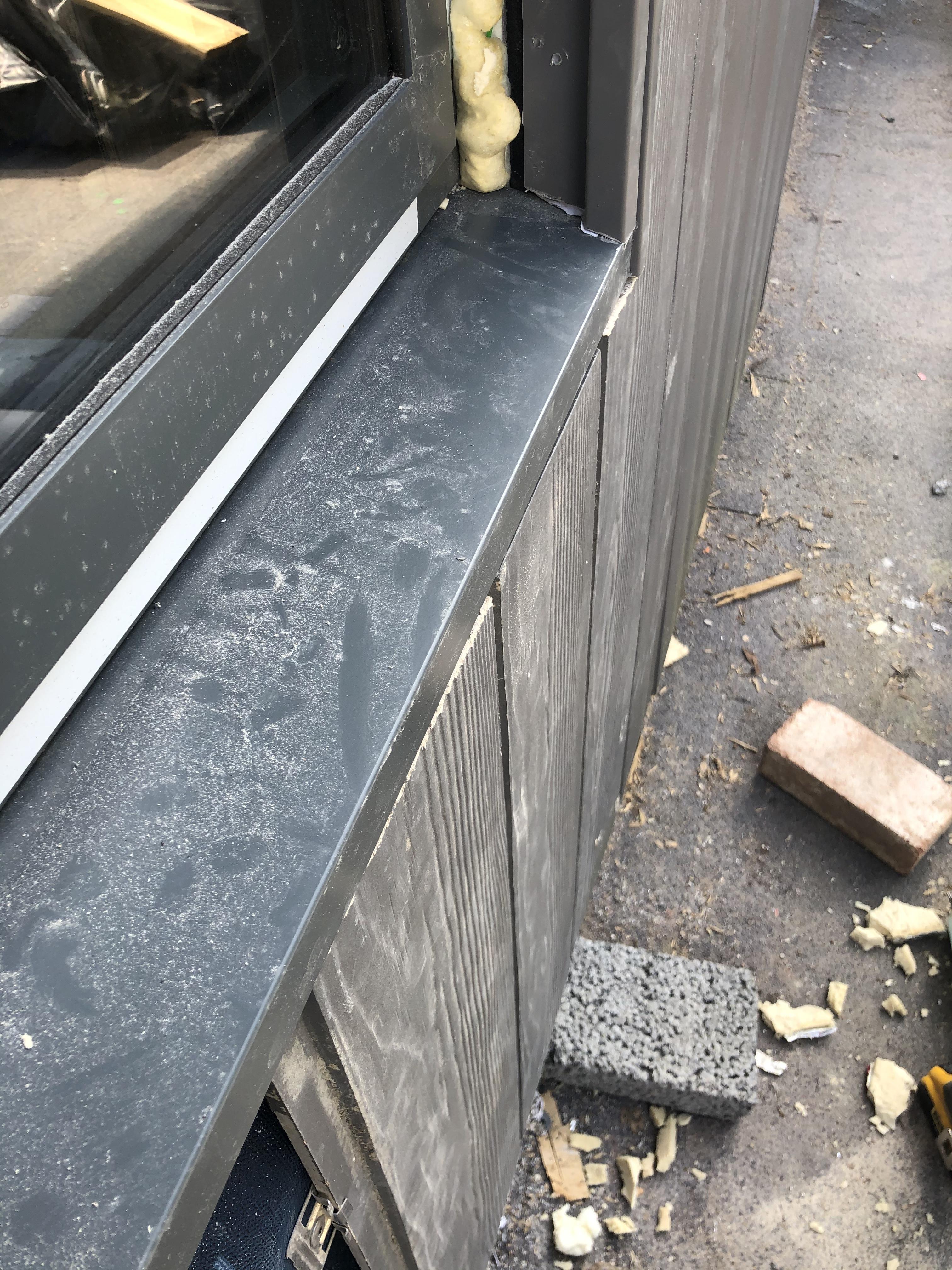

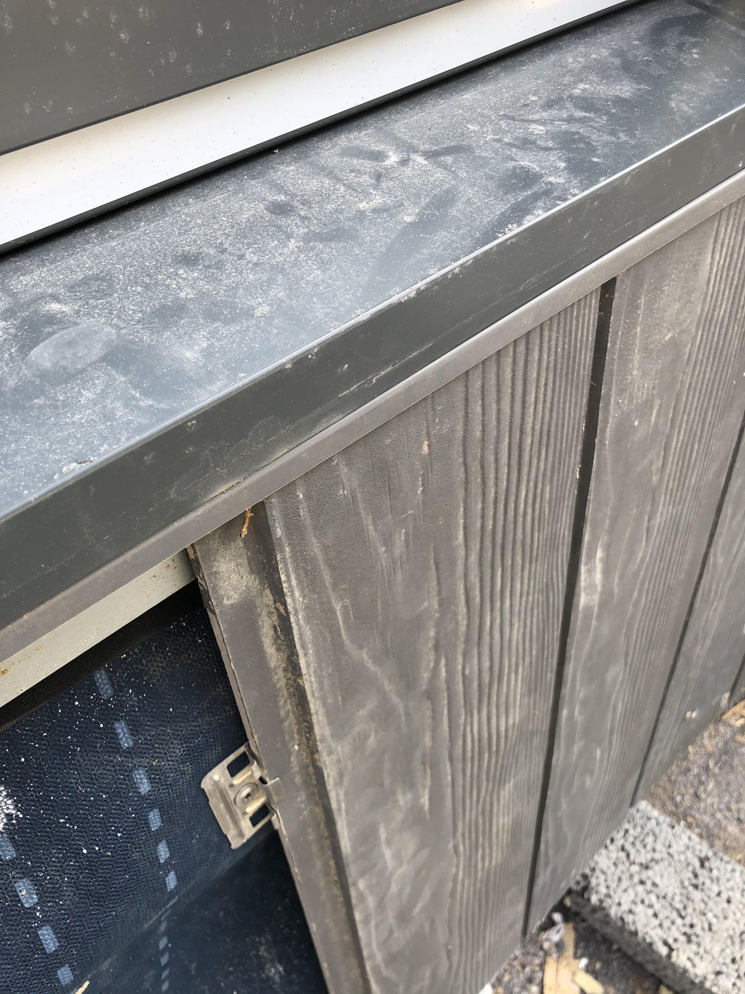

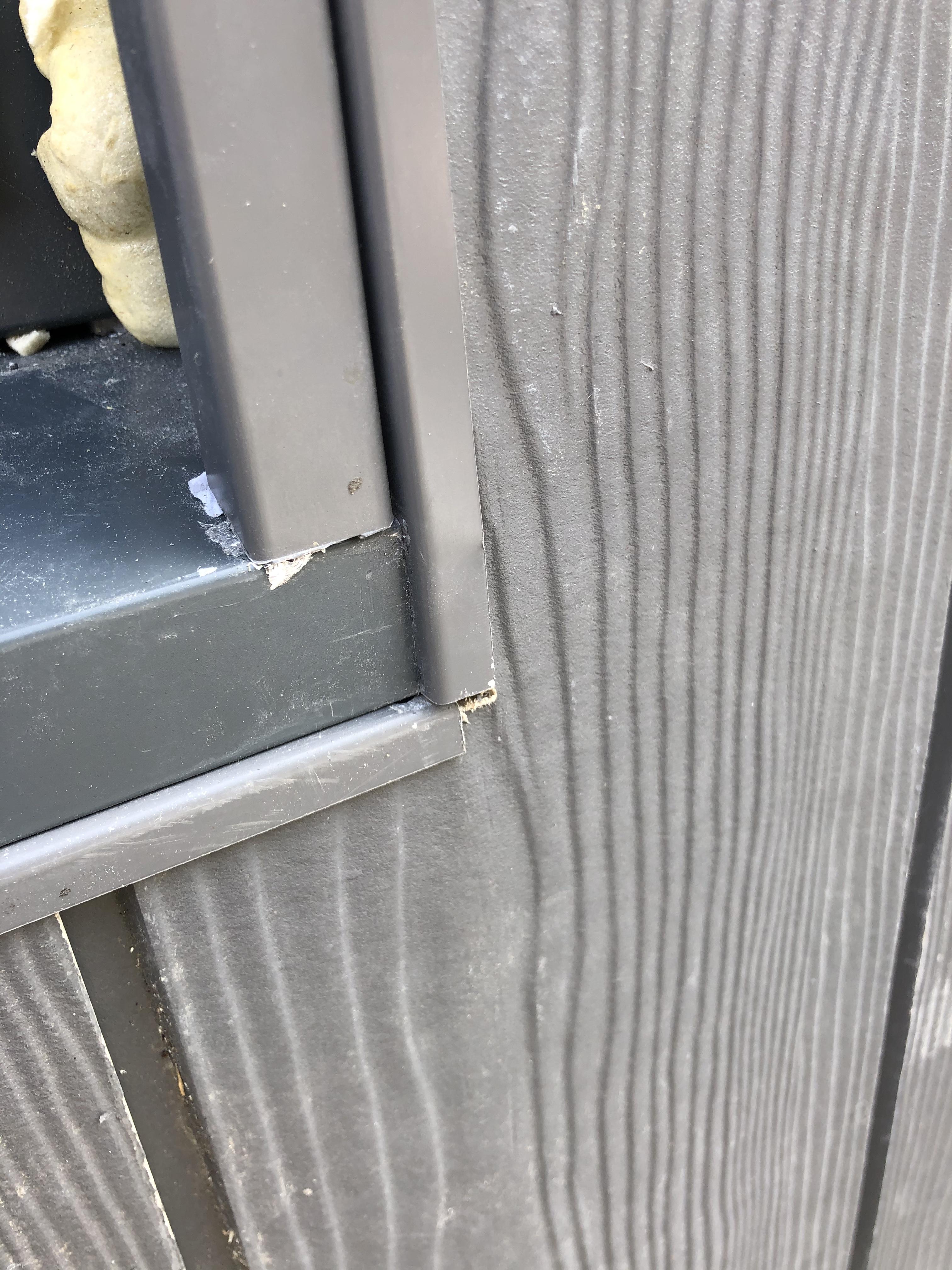

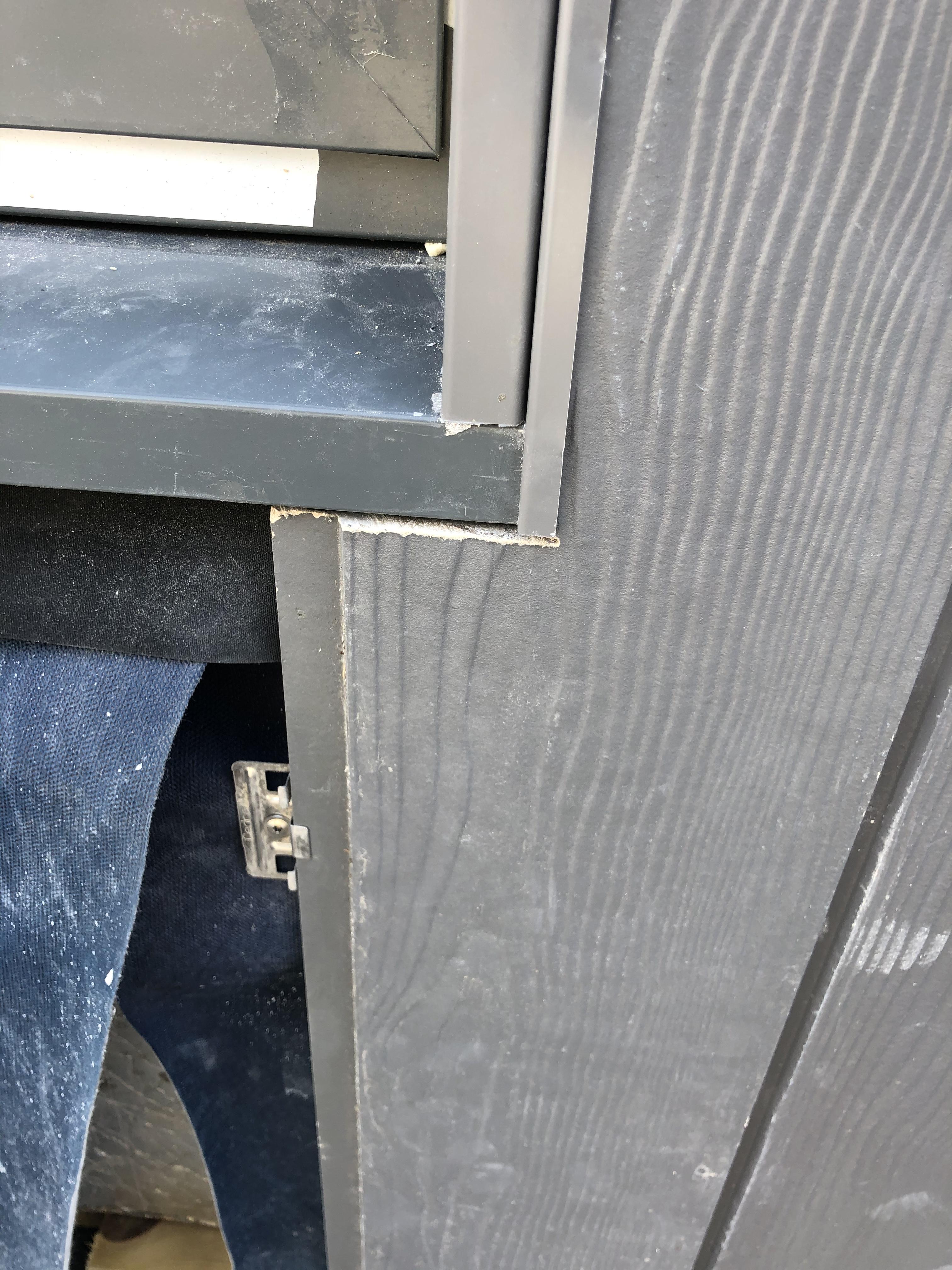

Pocster Posted April 16, 2020 Posted April 16, 2020 The window fitters did an ok job . As you can see they scuffed the trim which is not removable. As I clad across the front and meet their sill ; appears to be a few mm out . So I’m looking for suggestions of how I ‘cover’ this all up to look neat . Part of the problem with all this cladding and trim is that it’s virtually ( impossible! ) to cut it perfectly with no ‘torn’ ends . Be nice to ‘overlay’ the sill with another to hide the mess - but how an earth can I cut that spot on ? ( especially if assuming steel )

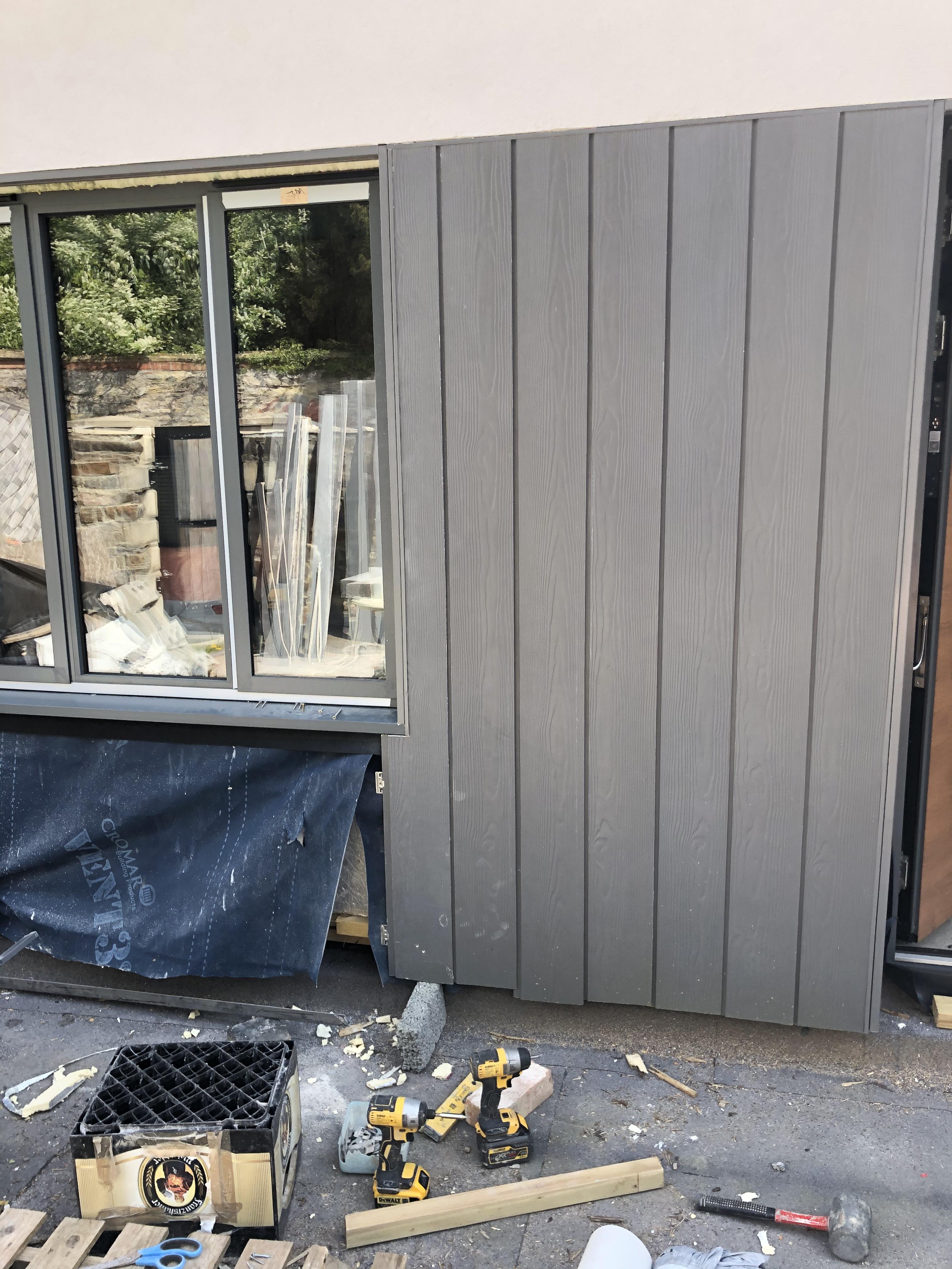

AdamSee Posted April 16, 2020 Posted April 16, 2020 I'm confused as to what i'm looking at. Can you do a picture from a bit further back? If that's an external window sill, shouldn't it extend past the cladding?

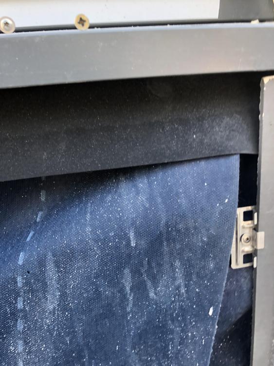

Pocster Posted April 16, 2020 Author Posted April 16, 2020 6 minutes ago, Carrerahill said: Do you have touch-up paint for the cladding? Yep . It’s never the exact same colour . Managed to pull it in a bit tighter - will touch up the top of that lower panel part and see if I can get away with it . Else more trim over it . @AdamSee yep . Sill should sit past cladding ; window company knew that but on install day said that’s the widest sill they do . I can arrange it so that any water running via the sill runs over dpc which is ontop the timber supports. This was installers suggestion on the day . Last photo shows their black dpc which goes over the timber membrane- so any water in a worst case scenario runs behind and on the cladding board which is supposedly everything proof .
Carrerahill Posted April 16, 2020 Posted April 16, 2020 1 minute ago, pocster said: Yep . It’s never the exact same colour . Managed to pull it in a bit tighter - will touch up the top of that lower panel part and see if I can get away with it . Else more trim over it . Could you for example put a slight bevel on the top edge along all the pieces so it looks right, and then a little grey silicon and some touch-up paint on it? Alternatively can you adjust anything to get the cladding closer into the wall?
Jeremy Harris Posted April 16, 2020 Posted April 16, 2020 I'd be inclined to get some over-cills bent up from aluminium sheet and powder coated to match. That way the cills would properly project out over the cladding and the cut edges would be hidden. Should be a quick and easy thing to fit, as the cills could just be bonded on with Sikaflex. Might need to find some end caps to finish the projecting ends off neatly, and might be best to source those first and have the cill covers bent to match. 1

Stones Posted April 16, 2020 Posted April 16, 2020 Quick photo of our custom folded aluminium cill. With all our EWI, the window company cill wasn't going to be big enough. I got mine folded and painted by: https://www.mspcladding.co.uk/ Very helpful, happy to deal with small order and a lot cheaper than the window company. 1 1

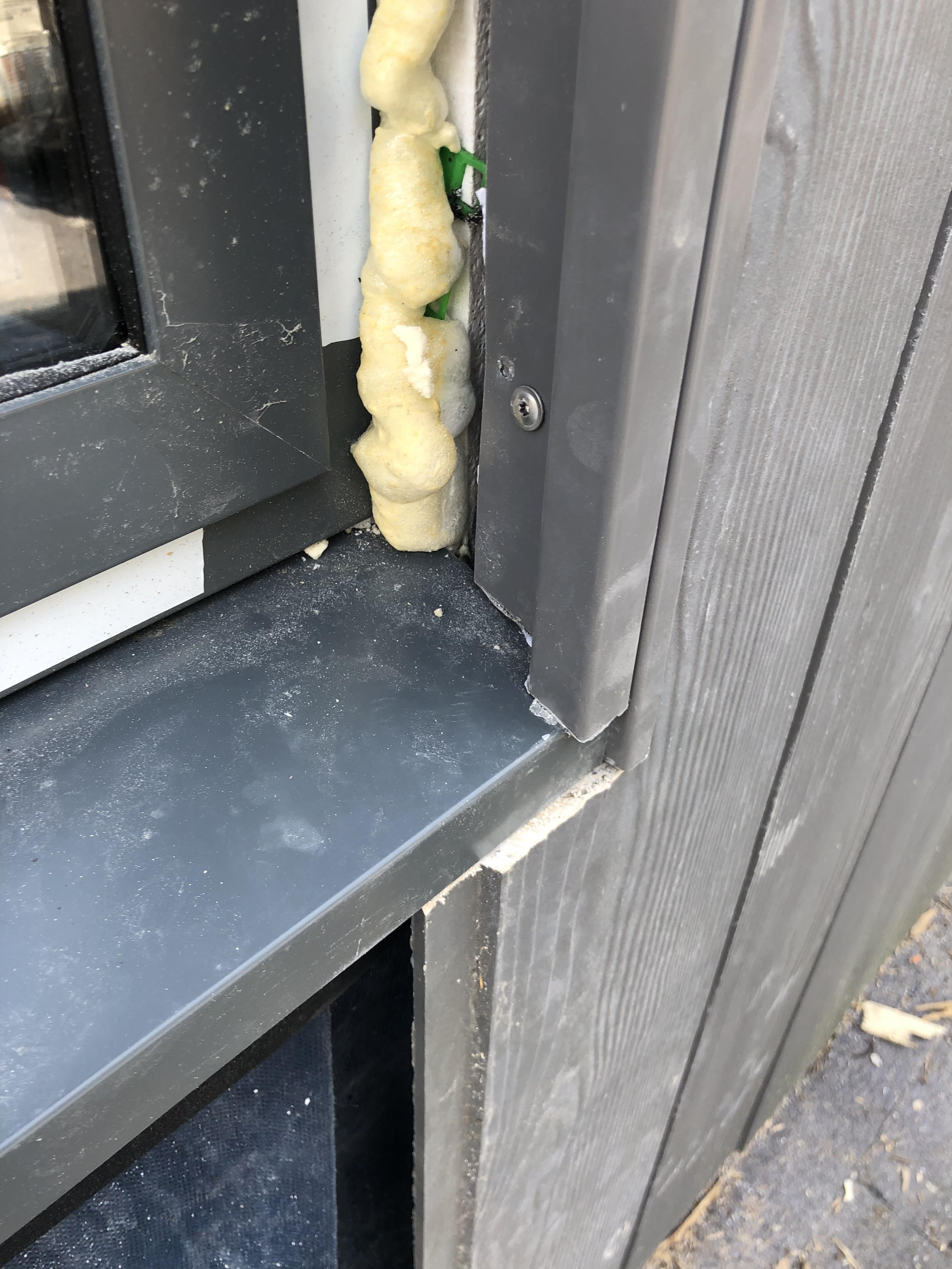

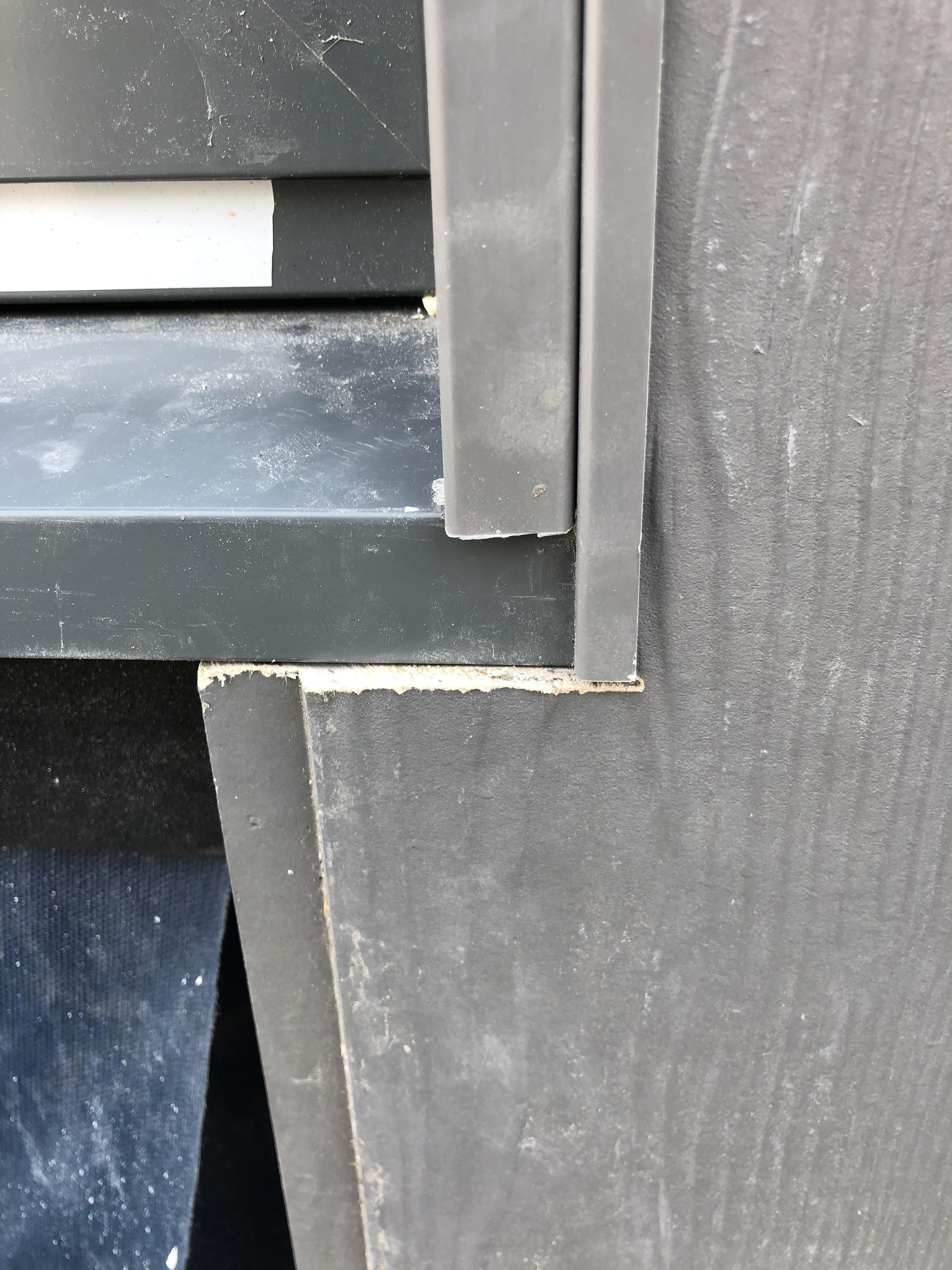

Pocster Posted April 16, 2020 Author Posted April 16, 2020 21 minutes ago, Jeremy Harris said: One or two people here have had aluminium sheet bent to shape and powder coated, I'm pretty sure @lizzie did, see this post: Put a few more in . As mentioned the cut edge is a pig . Pushed a bit of trim along the edge . Looks a lot better just a mm or so out - reckon this will do for now ! ( last photo ) - with a bit more effort .
Carrerahill Posted April 16, 2020 Posted April 16, 2020 (edited) 11 minutes ago, pocster said: Put a few more in . As mentioned the cut edge is a pig . Pushed a bit of trim along the edge . Looks a lot better just a mm or so out - reckon this will do for now ! ( last photo ) - with a bit more effort . I'd crack on as you are and at the end of the build when your snagging you can decide if you want covers made up. Looks good what you have done though! When you build something yourself, you suddenly discover that every daft little issue sticks in your mind, if you had paid someone to do it, you would probably not notice most of them. I get annoyed over such silly things, 6 months later I forget or don't even notice it anymore. Edited April 16, 2020 by Carrerahill 1

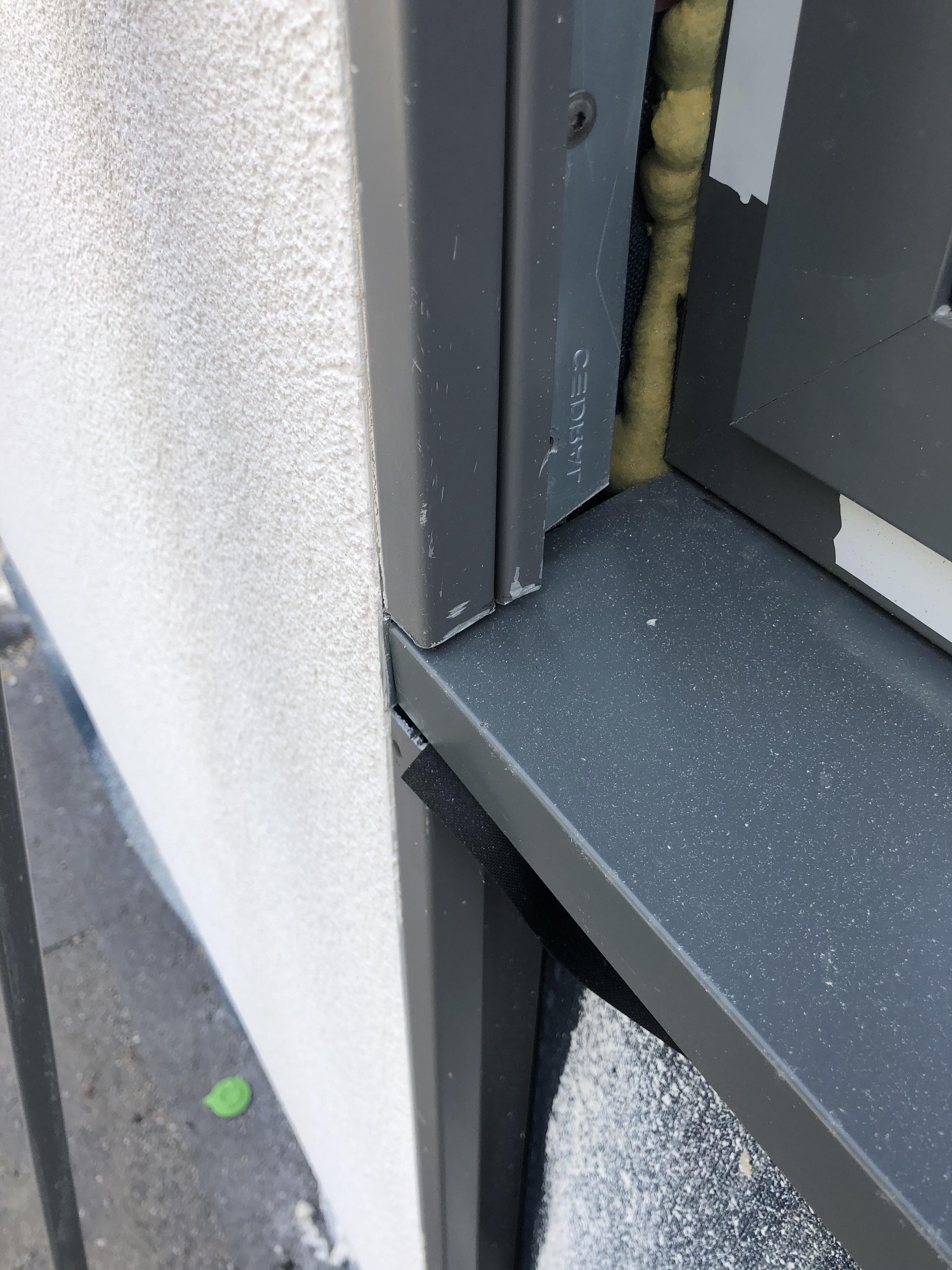

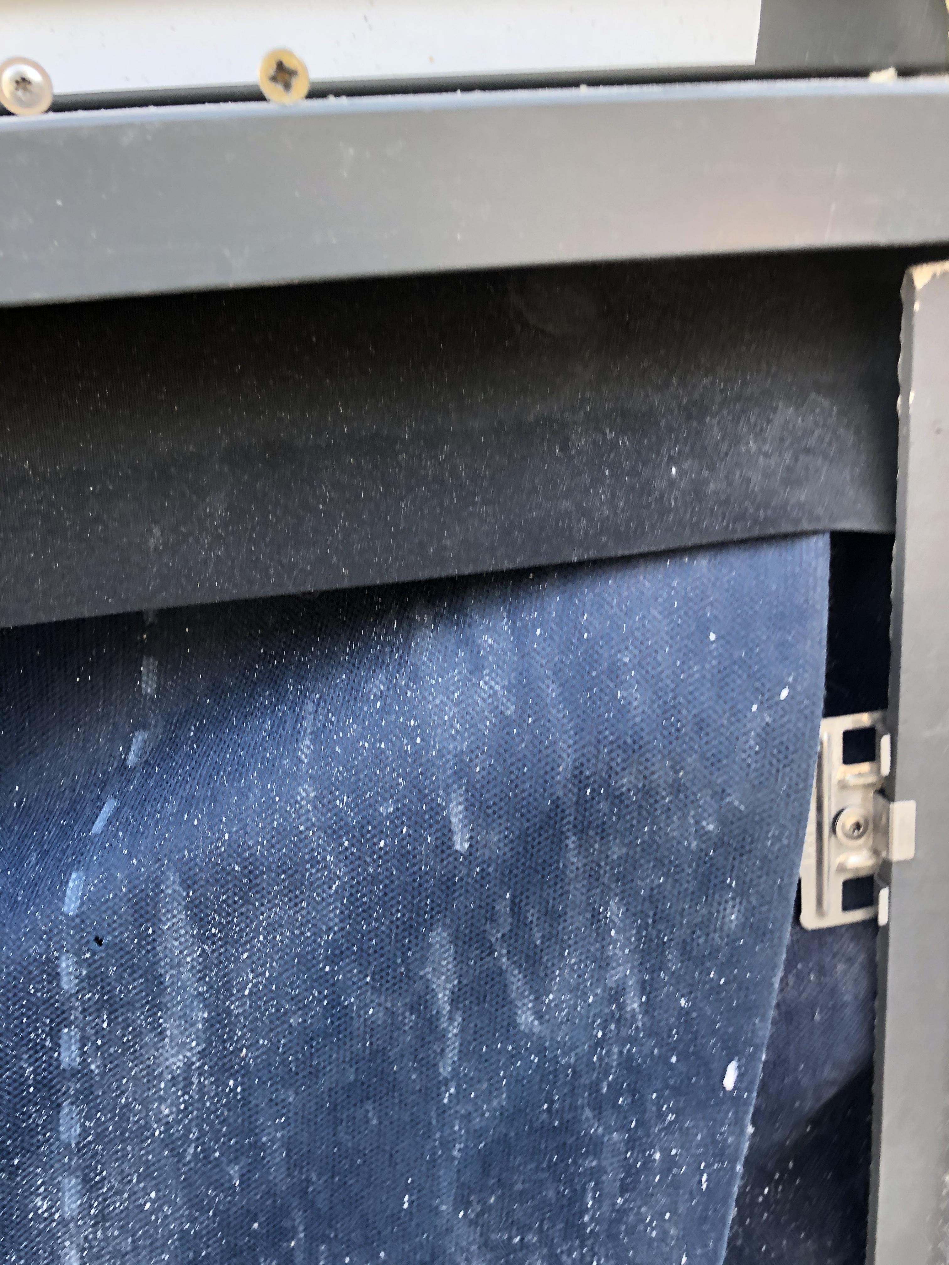

Pocster Posted April 16, 2020 Author Posted April 16, 2020 20 minutes ago, AdamSee said: The aluminium cills to go over the top sound like a reasonable way to sort the issue. Any sheet metal fabricator should be able to knock them up for you if your willing to draw it for them, most of them will know a local power coater to finish them off in the right RAL colour. What cladding are you using? Looks like wood, but have a feeling that its plastic. Yeah . I think I’ll come back to sills . They left me other issues like this - see photo and their foam filled ‘gap’ solution . Cladding isn’t timber it’s Marley cedral stuff .
