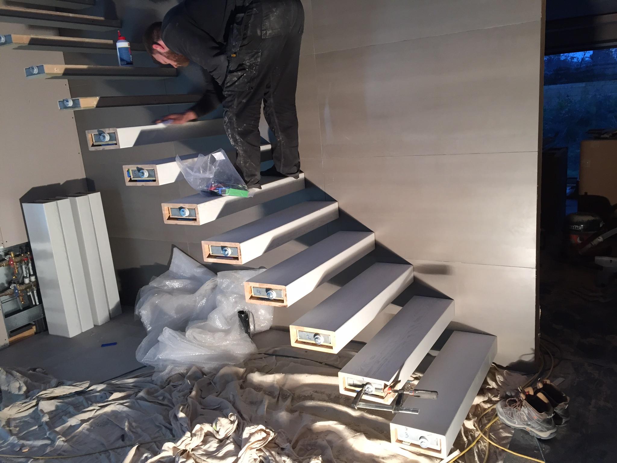

Posted
3 hours ago, ultramods said:
@Trw144 Can you tell me where you got the oak treads/cladding from please as I am planning a similar cantilevered stairs.
Also can you tell me how the glass is fixed to the steel please?
Hi - the oak treads came from the floor supplier,  Blueridge Flooring, so it matched the white finished floor they installed above. If this is nt an issue on yours, I m sure a good local joiner could make them for a lot less. In terms of the glass attachment, it’s essentialy clamped to the side of the steel tread with some rubber washers, and the outer piece of is simply silicones onto the side of the glass to cover everything. I ll try and find some photos to show

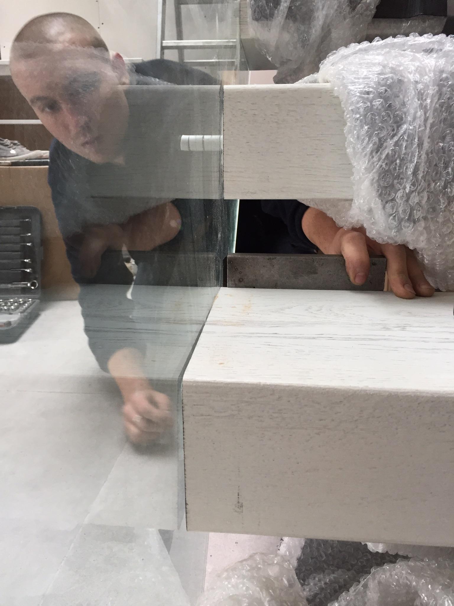

Posted
Here s some of it being done which should help....
Posted
Thanks. Do you know how the glass anchor bolt in fixed to the steel tread, is it glued in place?
Posted
Our glass balustrades were fitted in a similar manner but with rubber washers and threaded bolts.
