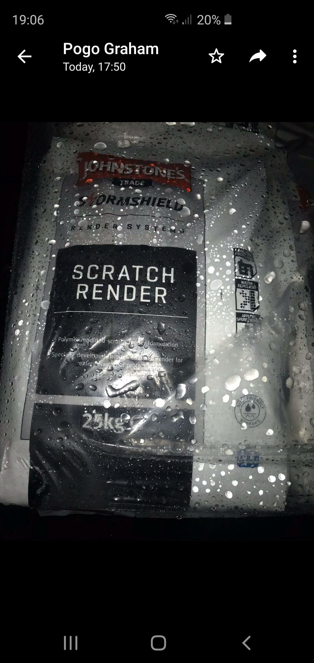

Euan G Posted April 12, 2020 Author Posted April 12, 2020 Thanks folks, does anybody have any experience with Johnstones 'Stormshield'?
Euan G Posted April 12, 2020 Author Posted April 12, 2020 5 minutes ago, Euan G said: Thanks folks, does anybody have any experience with Johnstones 'Stormshield'? Should have said the 'scratch render'
nod Posted April 12, 2020 Posted April 12, 2020 17 minutes ago, Euan G said: Should have said the 'scratch render' Masonry paint ?
