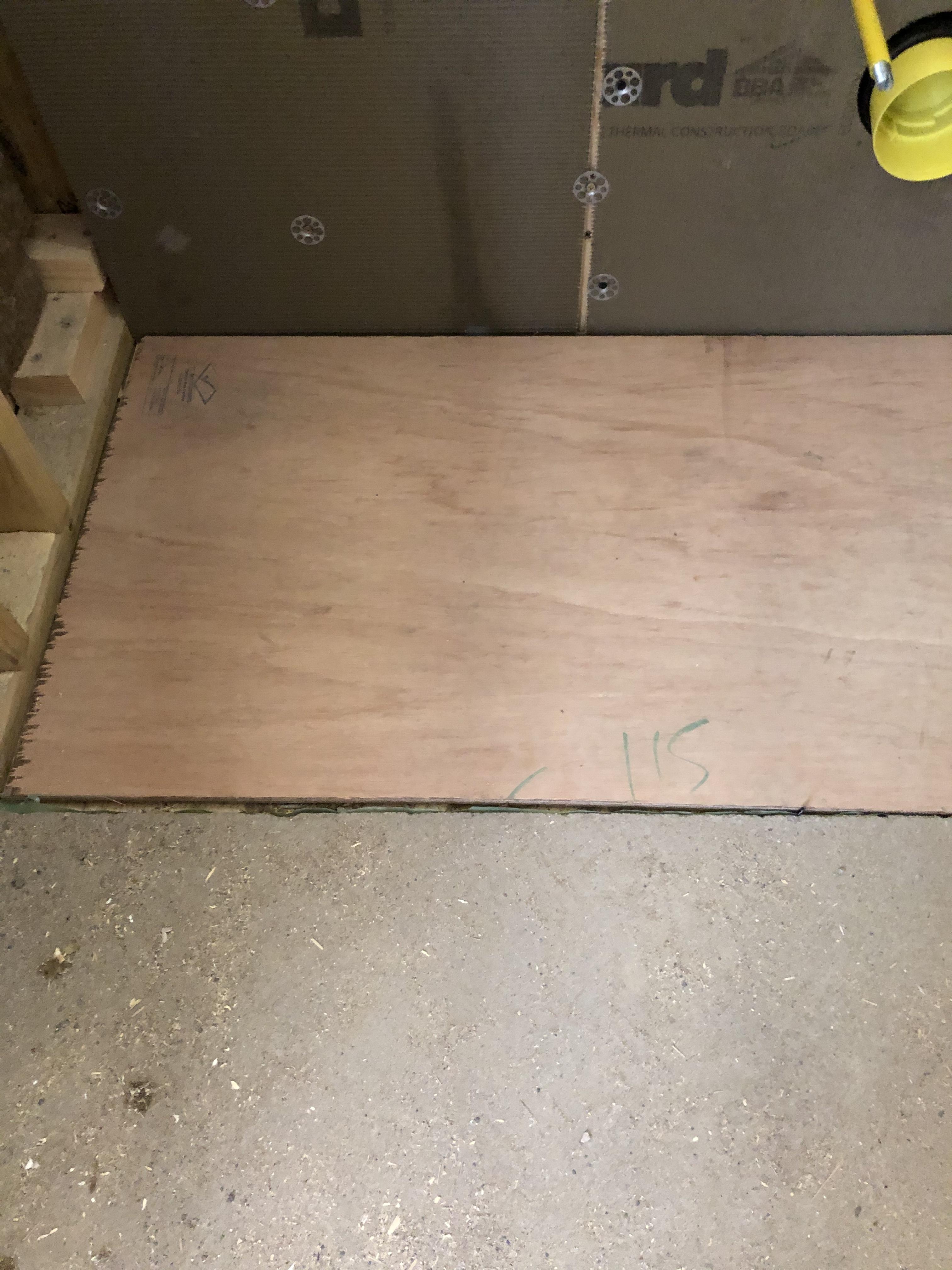

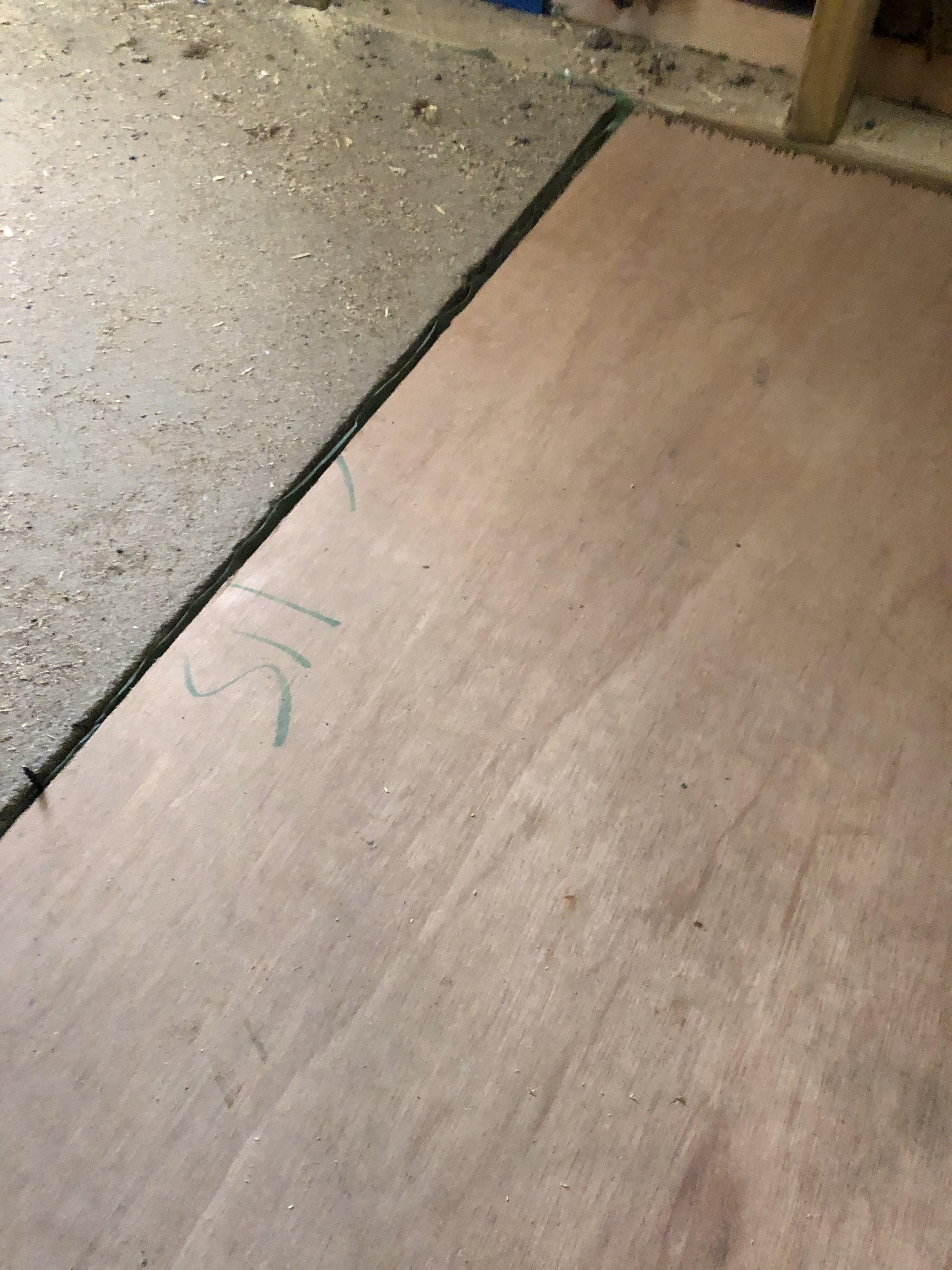

Pocster Posted April 9, 2020 Share Posted April 9, 2020 Will be installing this soon . As some of my floor is screed and some marine ply do I just apply the mat across both ? . As you can see there are a few gaps and the marine ply is a few mm lower than the screed . What should I fill the gaps with ? Should I ignore the slight height differences across the different floor materials and just lay the de coupling mat straight across ? thanks in advance! Link to comment Share on other sites More sharing options...

nod Posted April 9, 2020 Share Posted April 9, 2020 1 hour ago, pocster said: Will be installing this soon . As some of my floor is screed and some marine ply do I just apply the mat across both ? . As you can see there are a few gaps and the marine ply is a few mm lower than the screed . What should I fill the gaps with ? Should I ignore the slight height differences across the different floor materials and just lay the de coupling mat straight across ? thanks in advance! You can use tile adhesive But let it set before you put your 5 mil adhesive down for your Ditra Ardex for the ply 1 Link to comment Share on other sites More sharing options...
Pocster Posted April 9, 2020 Author Share Posted April 9, 2020 3 minutes ago, nod said: You can use tile adhesive But let it set before you put your 5 mil adhesive down for your Ditra Ardex for the ply So ‘skim’ tile adhesive over gaps and marine ply to make a nice level surface ? Link to comment Share on other sites More sharing options...
nod Posted April 9, 2020 Share Posted April 9, 2020 20 minutes ago, pocster said: So ‘skim’ tile adhesive over gaps and marine ply to make a nice level surface ? Yes When using matting always do the levelling before the matting goes down 1 Link to comment Share on other sites More sharing options...
Pocster Posted April 9, 2020 Author Share Posted April 9, 2020 41 minutes ago, nod said: Yes When using matting always do the levelling before the matting goes down Ahhh ! . Ok . Tile adhesive to ‘level’ it will only be a few mm thick . Not going to crack or anything is it ? Guess I should pva the marine ply before applying the adhesive? Link to comment Share on other sites More sharing options...
nod Posted April 9, 2020 Share Posted April 9, 2020 No it will be fine don’t use PVA with tiles SBR is more reliable 1 Link to comment Share on other sites More sharing options...

Oz07 Posted April 10, 2020 Share Posted April 10, 2020 I thought he said ardex to self level then stick matt down with tile adhesive Link to comment Share on other sites More sharing options...
Pocster Posted April 14, 2020 Author Share Posted April 14, 2020 On 10/04/2020 at 18:02, Oz07 said: I thought he said ardex to self level then stick matt down with tile adhesive Yes @nod please confirm . So SBR ply Then Ardex to level ply with screed : which Ardex product ? Then when all dry de coupling mat on top. Link to comment Share on other sites More sharing options...
nod Posted April 14, 2020 Share Posted April 14, 2020 1 hour ago, pocster said: Yes @nod please confirm . So SBR ply Then Ardex to level ply with screed : which Ardex product ? Then when all dry de coupling mat on top. Ardex adhesive to stick the matting to the ply 1 Link to comment Share on other sites More sharing options...
Pocster Posted April 14, 2020 Author Share Posted April 14, 2020 2 minutes ago, nod said: Ardex adhesive to stick the matting to the ply Sure . But what do I use to build the ply level up ? So it’s level with the screed . Link to comment Share on other sites More sharing options...
dave2878 Posted May 15, 2020 Share Posted May 15, 2020 Self level . To get level . If you can change the ply for Hardie backer board. It doesn't expand and contract like ply. Plus ply nowadays is poor quality. Link to comment Share on other sites More sharing options...
dave2878 Posted May 15, 2020 Share Posted May 15, 2020 If there is concrete under ply just self level the area to bring you up level. Never use pva Link to comment Share on other sites More sharing options...
Pocster Posted May 15, 2020 Author Share Posted May 15, 2020 1 hour ago, dave2878 said: If there is concrete under ply just self level the area to bring you up level. Never use pva Nah. It’s timber frame under the marine ply . Link to comment Share on other sites More sharing options...
dave2878 Posted May 15, 2020 Share Posted May 15, 2020 Self level of you are bothered about height. If it only a few mm the adhesive can deal with it. . . Clear dust the SBR . And use a decent adhesive . Bal or Weber Weber are my preference. 1 Link to comment Share on other sites More sharing options...
