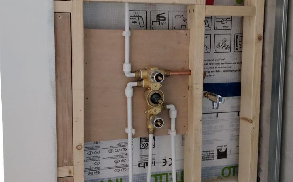

I'm sure I've shown this picture before. But I had the exact same issue. So i use 3/4 bsp male to 15mm compression, which I joined on to 15mm hep2o elbows. Make sure you use copper olives, not brass ones.......brass will not work, its just too stiff.
To test the system I attached spare hep2o shutoff valves to all the outlets and let the system come up to mains pressure and left for a day to see if anything dripped.......it did drip....from the 3/4bsp. They take alot of tape.
Also, don't make my mistake. I made the central space for my shower valve too wide. So the ply on the left which was for the shower screen to have something substantial to mount to is too far over. The stud needed to be at least another 50mm to the right.
