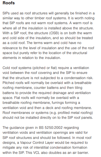

It is quite traditional in Scotland to slate directly onto sarking, I've only ever done this on a cold roof setup.
I'd have though the battens and counterbattens are essential if you need some kind of ventilation above the sarking (typical with a warm roof setup) which is what we have.

I just found this on a UK SIPS website which confuses things even more..
Full pdf attached for reference.
TB5_Durability.pdf

the thing you will need to decide whether sips or tf, then if tf, the construction method. i'm building tf though i beam and will need to batten the roof for slate. if normal tf then sark it and slate onto it, with membrane of course.

As others have said if building a cold roof, then slates onto membrane and then sarking is fine. That's the traditional method.
For ventilation obviously a breathable membrane, the other point is that being in a windy location the natural profile of the slates will allow air to go under to provide ventilation.
If it helps I paid £1.05+VAT per slate 40 x 25cms
