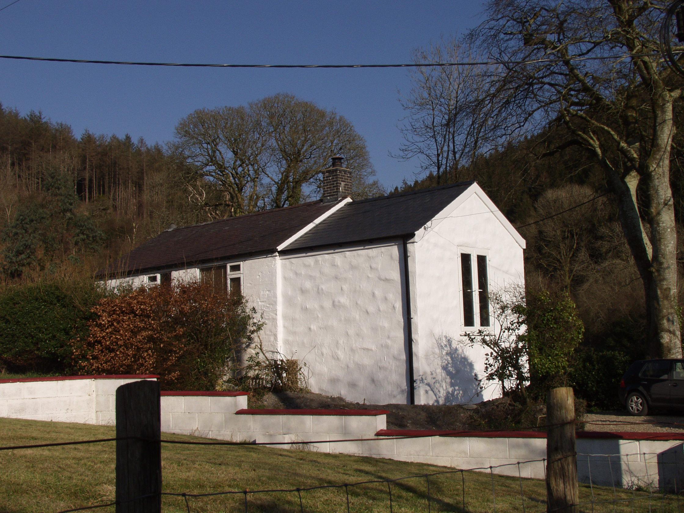

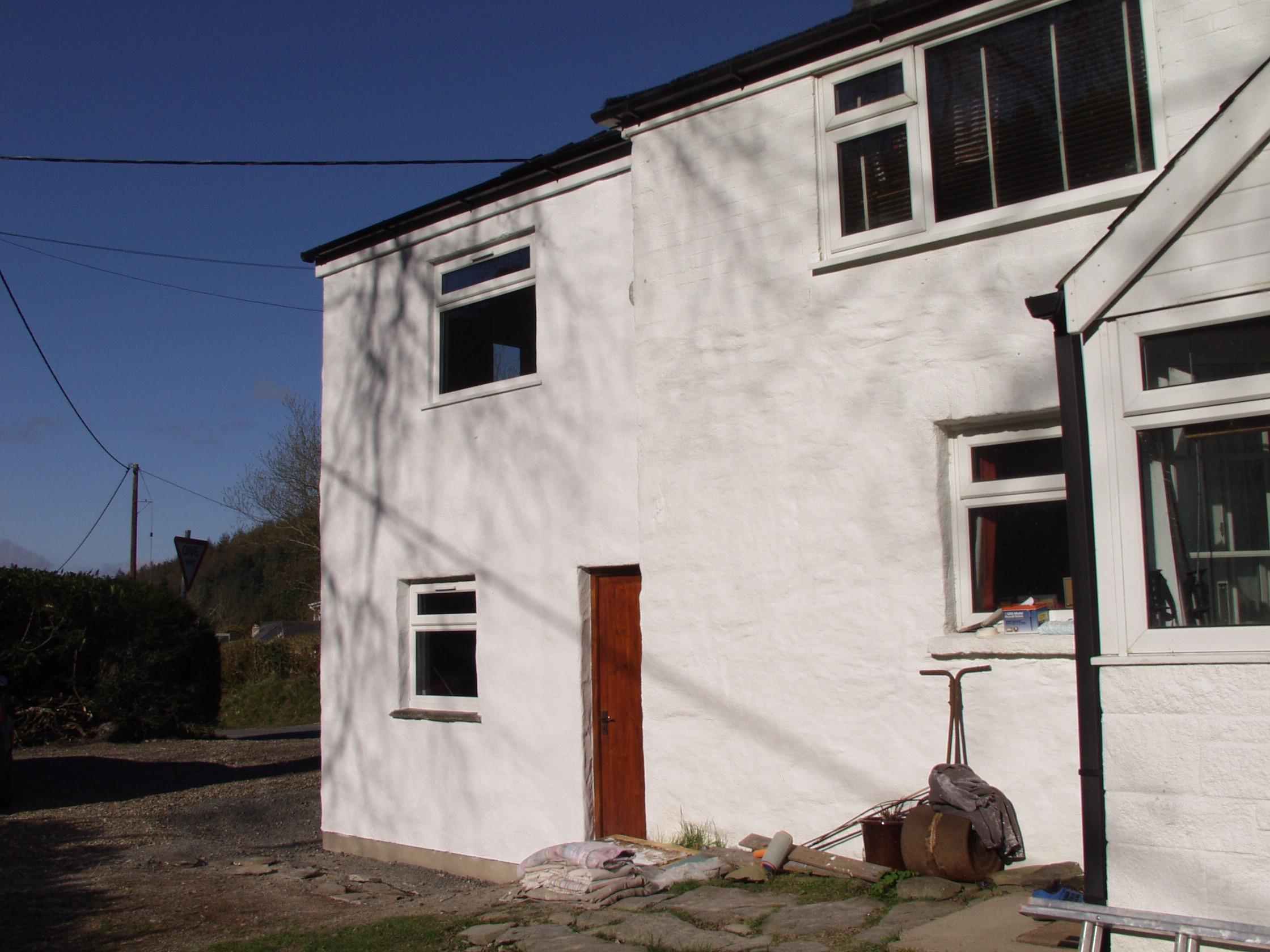

Mr Punter Posted March 29, 2020 Posted March 29, 2020 Looks good. Did you do the high bits off a ladder or scaffold tower?
