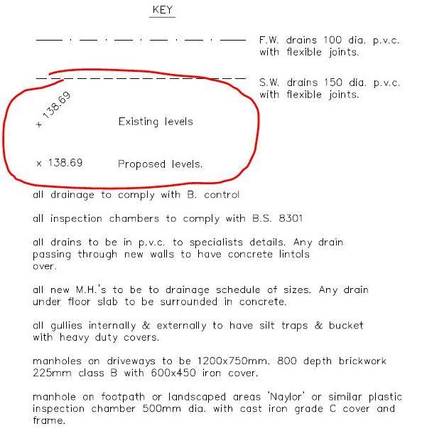

idilkachore Posted March 10, 2020 Share Posted March 10, 2020 Hi I'm an inexperienced self-builder and I'm just in the process to start building by sub-contracting. I have full planning permission and council building control have given me the go ahead to commence building. I'm in the process of agreeing terms with a groundwork sub-contractor. Basically, he'll do all ground works and handover the site ready for foundation blocks. This sub-contractor has instructed a site engineer. The site engineer has stated the following info is missing from the plans. Therefore, the sub-contractor will not commence groundwork until he gets this info: * Finished ground floor levels missing (even though there are existing and proposed levels on the plan) * Topo survey info about existing site missing * Control station info missing (position and levels) (what's control station?) * Positional setting out dimensions/co-ordinates of plot corners missing * Drainage manhole positions (my inexperienced eyes see drainage info on the plans) * Drainage invert and cover levels missing * Plot foundation sizes and levels missing * Internal pop up pipe positions missing * Internal water pipe entry position missing Planning department has approved full planning application without all this info, seriously? I don't want to go back to my architect because it will delay my project by about a year (yes, he's that slow, really). Any suggestions or comments how I approach this first step. Thanks Link to comment Share on other sites More sharing options...

Temp Posted March 12, 2020 Share Posted March 12, 2020 For the drainage stuff you may need to lift manholes in the road to find out how deep the sewers are. Then make a drawing working back to your house accounting for the fall in each length of pipe to calculate the invert level for each inspection chamber. For example if the sewer connection was 2m below reference level and the nearest IC on your plot was 40m away the bottom of the IC would be calculated as.. 1:80 fall over 40m = 0.5m so the IC would be set at 2m - 0.5m = 1.5m below reference (Thats not necessarily 1.5m below ground because the ground may slope). Repeat for each IC untill you get to the bottom of the stack. Link to comment Share on other sites More sharing options...
idilkachore Posted March 12, 2020 Author Share Posted March 12, 2020 (edited) Thanks Temp. I have been in contact with sub-contractors site engineer and says: In your case though, with it being a single new build plot, all that [name removed] would require to start the foundations would be a distance from the back of the existing footpath to the front of the plot and a distance from one of the side boundary’s. The plots finished ground floor level I assume would be a certain distance either above or below the back of the existing footpath. The architect usually provides this information on a setting out drawing. All is required is couple of measurements on a drawing to cover their back as you guys have said. I didn't get a setting out drawing from my architect so I have requested it. I think there would be a charge. However, my main concern is slow speed of my architect. When will I get the setting out drawings is any bodies guess (even if we agree dates, he don't give s***). I think this sub-contractor wants to do things by the book, others have said they can start marking out and start foundations within a day. From their original requirements I really was stressed. Will see what the architect replies back with. Thanks again guys. Edited March 12, 2020 by idilkachore Link to comment Share on other sites More sharing options...

idilkachore Posted March 12, 2020 Author Share Posted March 12, 2020 I've received an email from sub-contractor's site engineer and he says: You need the dimensions and levels highlighted on the attached architects drawing. The fact that they have drawn a line and made a note about "proposed levels" suggests they have that information just not put it on the drawing. I was under the assumption that I needed completely new plans drawn with the dimensions and levels and was willing to pay for it. However, from above it appears the architect has forgotten (give him benefit of doubt) to add the dimensions and levels to the existing drawings. But he's asking me to pay £3k for already drawn plans and dimensions and levels which he already has. Any comments/suggestions would be appreciated. Link to comment Share on other sites More sharing options...
Russell griffiths Posted March 12, 2020 Share Posted March 12, 2020 You should have a SITE LAYOUT EXISTING. you should have. SITE LAYOUT PROPOSED. both of these would be needed for planning consent, you could not get planning without having the proposed site plan, so in effect you already have everything. It just either needs dimensions putting on it or some form of reference for location a drawing is not good enough to measure off. your architect will have all this information digitally, it will take him 2 minutes to add dimensions and forward it on to your contractor. Get on the phone and give him a big earful. He should have all your site plans in layers so he can add and remove layers depending on what you need to view. 1 Link to comment Share on other sites More sharing options...
