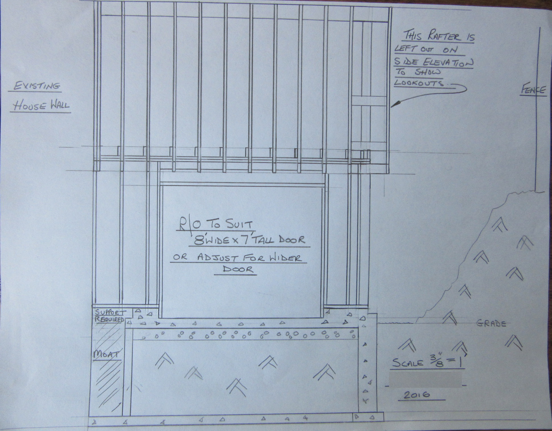

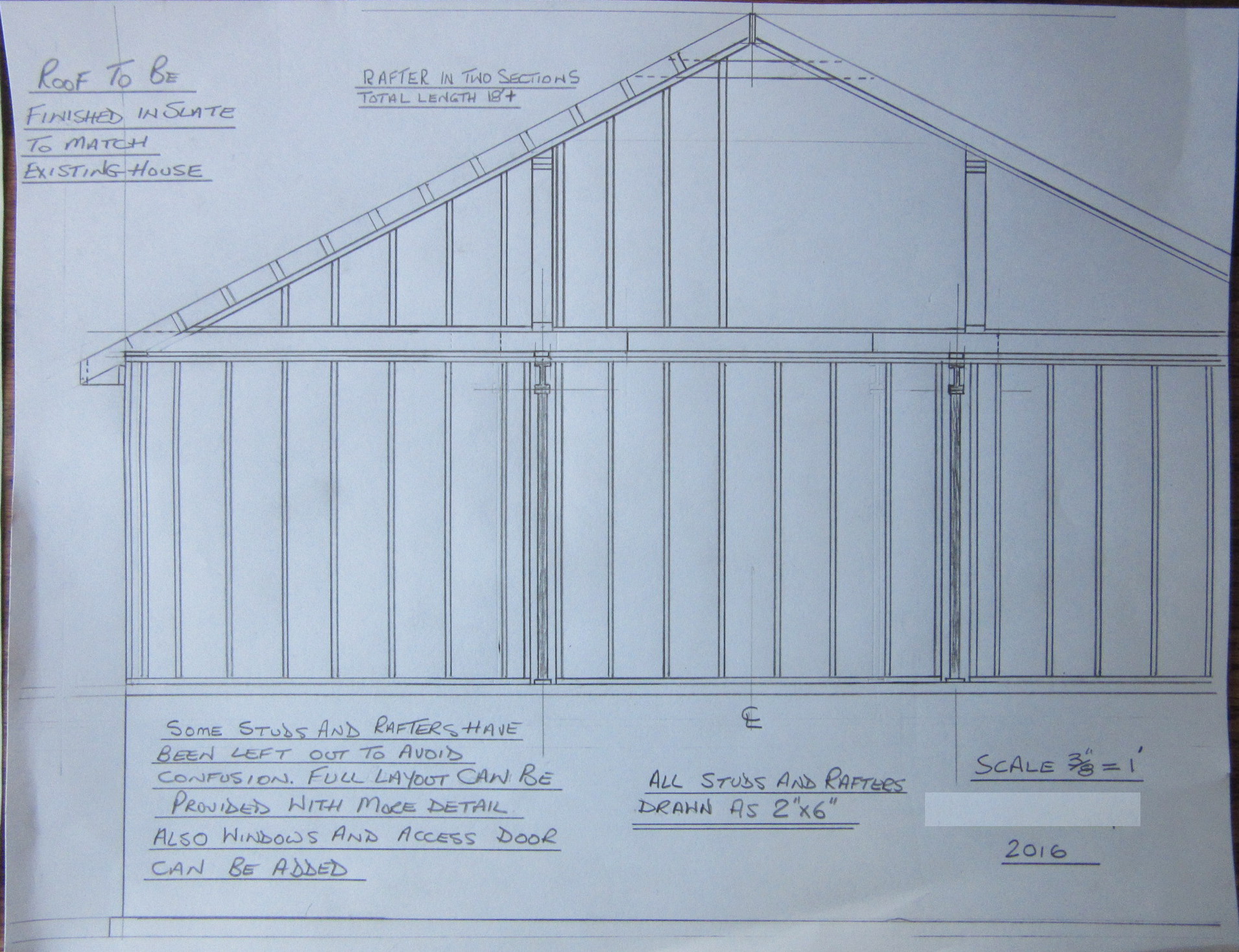

Jeff Posted November 18, 2016 Share Posted November 18, 2016 Can anyone tell me if a timber frame is acceptable in the UK? I have a NON-listed 1850 Victorian detached property, and want to build a garage. Coming from Canada, I would like to use techniques that I am familiar with, and timber framing is popular there. Is it generally accepted in the UK? Would the attached be a suitable style of drawing to use for a planning application? Link to comment Share on other sites More sharing options...

Temp Posted November 18, 2016 Share Posted November 18, 2016 Winter/spring here can be quite wet but it looks like you have the concrete base arranged so the frame is raised well above local ground levels. It also looks like you have avoided a common mistake which is to lay a flat topped slab that is slightly larger than the building. They forget that this allows water to run under the cladding to contact the frame. It looks like you have a step in the concrete to prevent this. A few courses of bricks or even a visible brick plinth is sometimes used. Building Control will probably want details of the damp proof membrane (DPM), damp proof course (DPC - between concrete and sole plate) and the wall membrane. Perhaps consider a linear drain across the door opening if you haven't already planned this. Are there any purlins planned? Perhaps I misunderstand the drawing but if the clear span of the rafters is 18 feet they will need to be deeper than 6". I can't tell your rafter spacing but that might be different between Canada and UK. Here it's normally 400 or 600mm. Link to comment Share on other sites More sharing options...

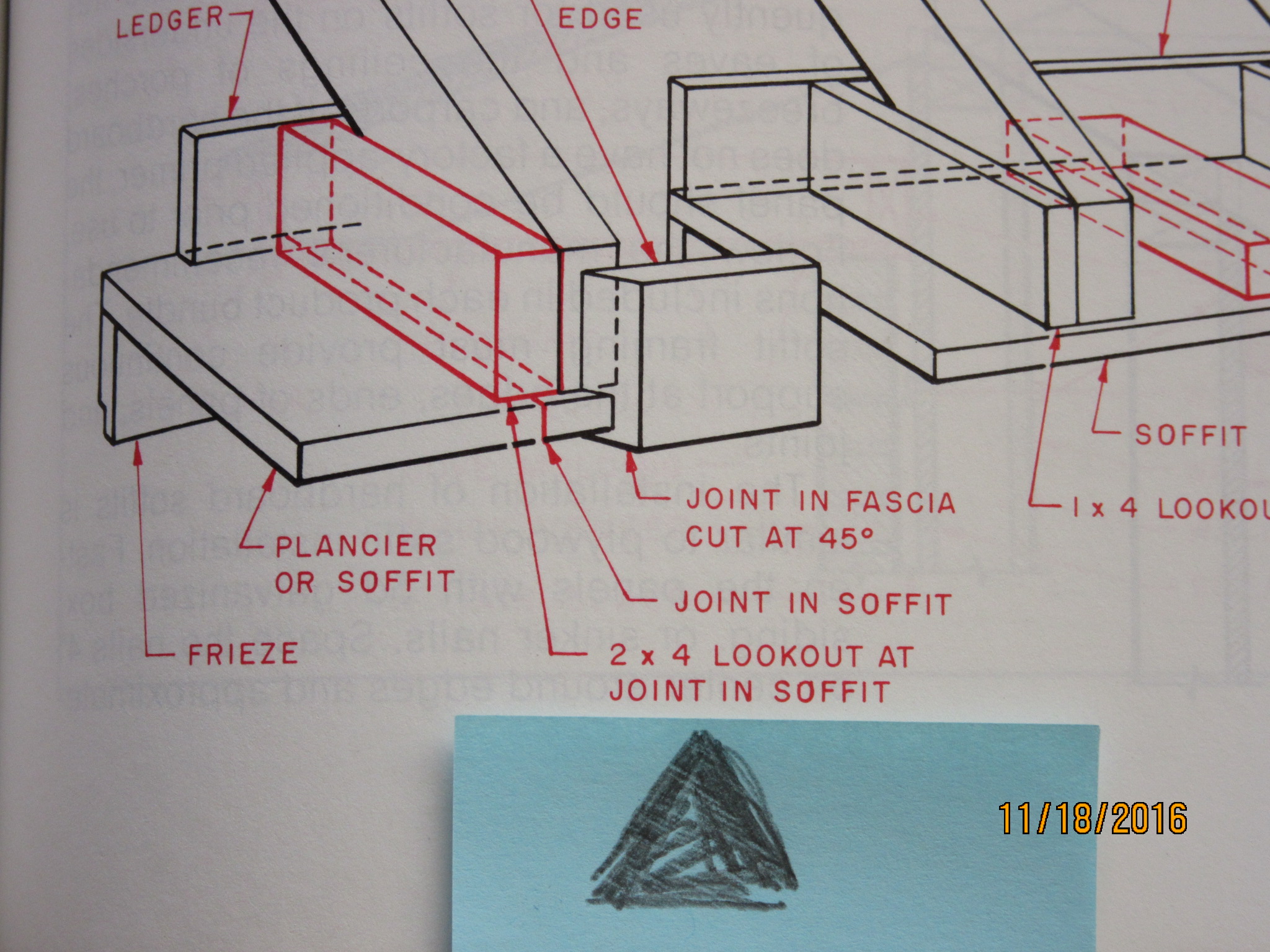

Temp Posted November 18, 2016 Share Posted November 18, 2016 (edited) Perhaps it's just me but what are "lookouts"? The planners only want to know what it will look like from the outside not the internal structure. So you can remove a lot of the detail but need to add info on the cladding (wood/render? Colour/stain?). They will also want to see how it relates to the rest of the house so you will probably need to draw the house and extension together. The drawing you have done is more suitable for Building Control Approval which is the next step after getting Planning Permission. Edited November 18, 2016 by Temp Link to comment Share on other sites More sharing options...
Jeff Posted November 19, 2016 Author Share Posted November 19, 2016 22 hours ago, Temp said: Perhaps it's just me but what are "lookouts"? Link to comment Share on other sites More sharing options...
ProDave Posted November 19, 2016 Share Posted November 19, 2016 Some different terminology in use here. So now we know what lookouts are. Can you explain in the second picture what the "Moat" is please? ( I really don't think it's what I know of as a moat) Link to comment Share on other sites More sharing options...
Jeff Posted November 21, 2016 Author Share Posted November 21, 2016 On 11/19/2016 at 10:02, ProDave said: Can you explain in the second picture what the "Moat" is please? ( I really don't think it's what I know of as a moat) Sorry, we call it a "moat". It is actually a drainage ditch that runs the circumference of the cellar. It is about 18" wide, with the wall of the house on one side and a 6" block on the outside, It is about 4' deep. It mainly collects leaves :). Link to comment Share on other sites More sharing options...
