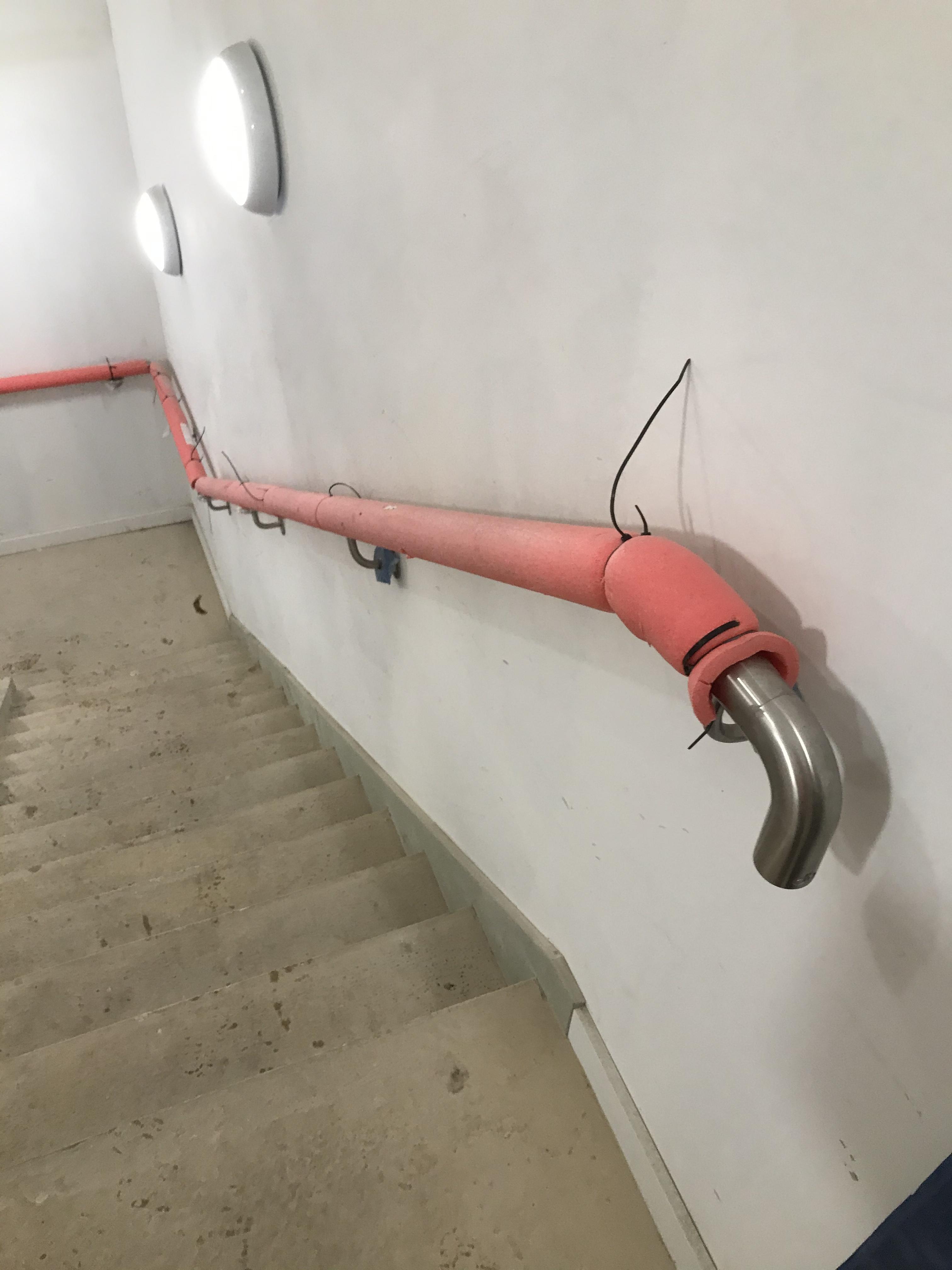

In the interest of personal site safety can anyone offer tips on how to protect head-height scaffold bar ends on the first lift staging?
My thought is to buy a few meters of pipe insulation with a suitable internal diameter and wrap the pipe ends then add a cable tie to keep the insulation in place.

If you have that hazard then pipe insulation taped around it with some of that yellow / black striped tape.

I am surprised no one has invented plastic ends like those on plant canes to stop you poking your eyes out. How about whacking some off cuts from your floor insulation on them (and wear a hard hat like your supposed to do ?)

That’s exactly what they do with pavement scaffolding
Yellow foam cable tied
I will do something similar to your photo, thanks.
Just been out to measure, the external scaffolding pipe dimension is 48mm.
