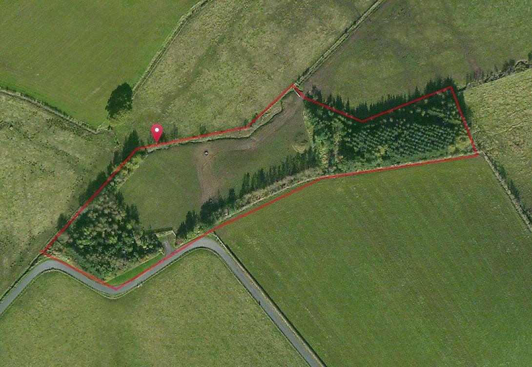

Bitpipe Posted March 2, 2020 Share Posted March 2, 2020 Nice plot. We created our own 'passive basement' mimicking the design of the MBC passive slab and then had MBC erect a passive standard frame on top - was easy enough to ensure the two insulation envelopes met correctly. However we do not have any heating in the basement slab, relying on UFH in the suspended timber ground floor so don't get all the advantages - mainly the ability to cool the slab in summer. We're also on mains gas vs ASHP which is required to cool the slab. For me, active cooling would be one of the key benefits, especially as low energy houses are much more likely to overheat rather than be cold (even in spring & autumn when the sun is low and comes into rooms directly. Build wise for us it was a pretty continuous process however as MBC did not build the basement, we engineered a break for 4-6 weeks in proceedings to ensure that the final frame measurements could be confirmed before the frame went into production (i.e. basement designed around frame, frame build finalised around built basement). I believe that when MBC do slab and frame this is not required. 1 Link to comment Share on other sites More sharing options...

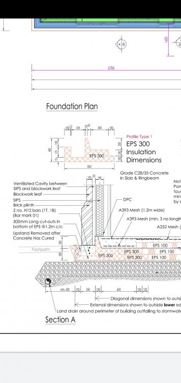

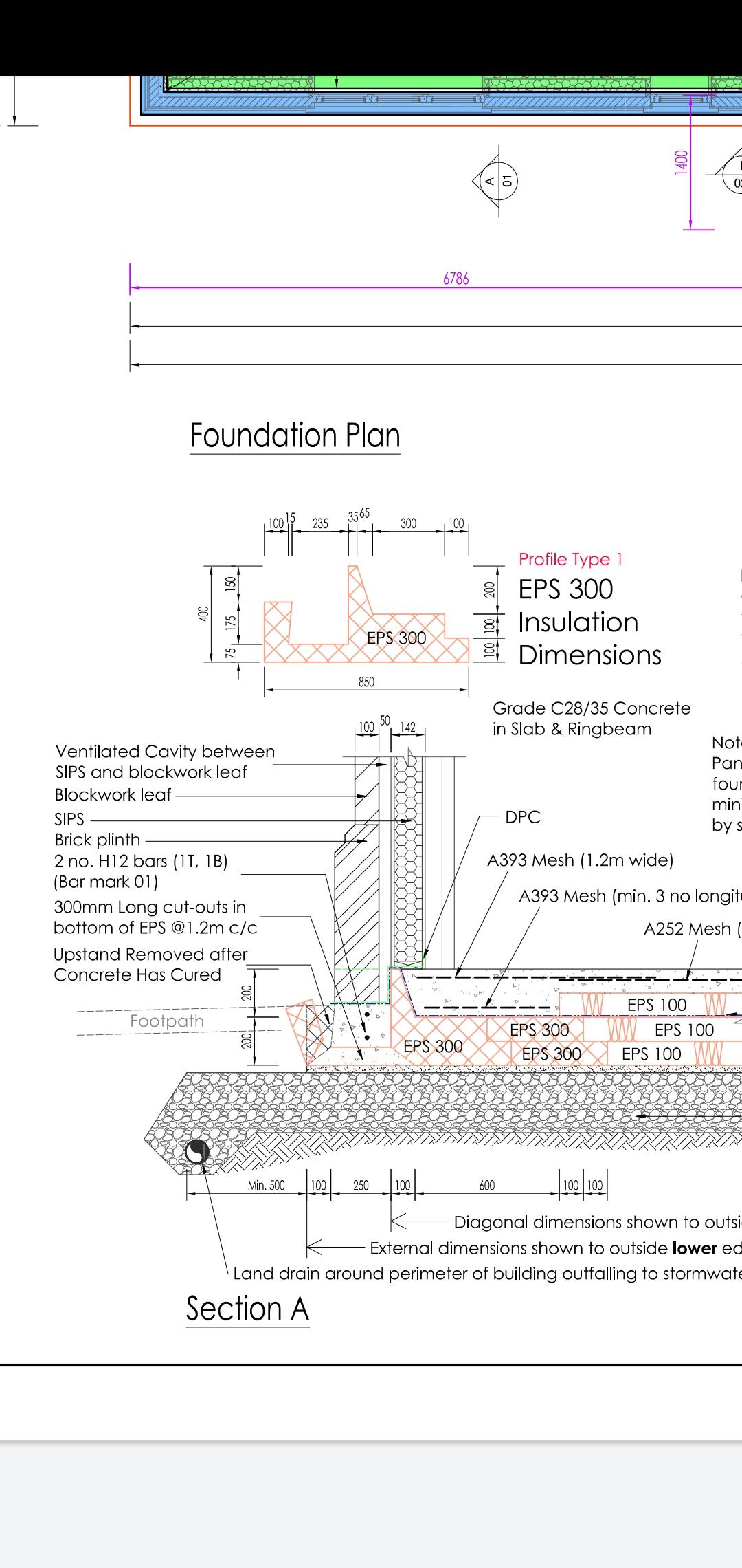

LA3222 Posted March 4, 2020 Share Posted March 4, 2020 (edited) @SuperJohnG I have SIP with a blockwork outer skin on an insulated raft foundation. The way it worked for me is I first of all had a soil survey done to get a ground bearing capacity. Architectural Technician did my house design which I gave to SIP company and asked them for the point and line loads. They used their SE to get this for me (incl in cost of the SIP supply/install package). I then contacted Tanners and provided him with the soil survey report and the line/point loads of the SIP and the house design. They then produced a foundation plan which included a slab for the TF and a separate ring beam to carry the blockwork skin. Gave this design to Kore and i am now pulling my hair out trying to build it in the worst February on record?♂️? Edited March 4, 2020 by LA3222 1 Link to comment Share on other sites More sharing options...
SuperJohnG Posted March 5, 2020 Author Share Posted March 5, 2020 14 hours ago, LA3222 said: @SuperJohnG I have SIP with a blockwork outer skin on an insulated raft foundation. The way it worked for me is I first of all had a soil survey done to get a ground bearing capacity. Architectural Technician did my house design which I gave to SIP company and asked them for the point and line loads. They used their SE to get this for me (incl in cost of the SIP supply/install package). I then contacted Tanners and provided him with the soil survey report and the line/point loads of the SIP and the house design. They then produced a foundation plan which included a slab for the TF and a separate ring beam to carry the blockwork skin. Gave this design to Kore and i am now pulling my hair out trying to build it in the worst February on record?♂️? thanks @LA3222 as you know, I'm following your build intently! Helpful to understand how you went about it. I need an SER certificate here in Scotland. I need to spend a little more time understanding what is required here. I'm envisaging that once I figure it out I'll just let the architect deal with it. I am hoping to do render board (I've assumed less hassle and easier/quicker than blockwork) and siberian larch cladding, so guessing I wouldn't need that external ring beam. what is your finish? any reason you went blockwork? Link to comment Share on other sites More sharing options...
