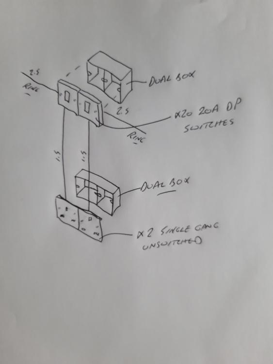

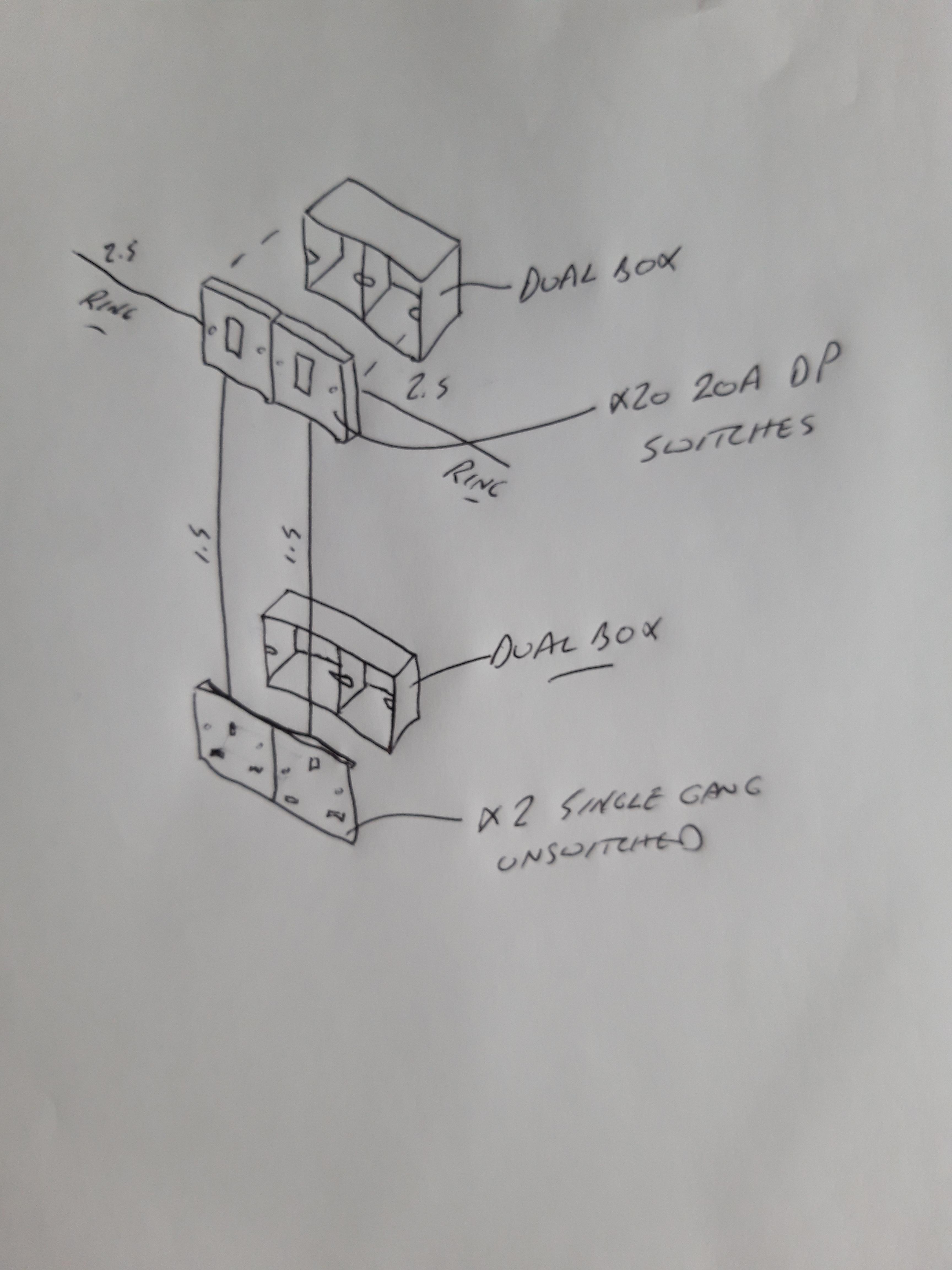

Onoff Posted February 23, 2020 Share Posted February 23, 2020 Has it got a fused connection unit above the worktop, maybe on the kitchen ring, switching the single socket below? Link to comment Share on other sites More sharing options...
Delicatedave Posted February 23, 2020 Author Share Posted February 23, 2020 41 minutes ago, ProDave said: When you say it has "fused isolation" do you mean it is fed from a switched, Fused, Connection, Unit? If so what you propose will be safe, but don't be surprised if the fuse blows when you have the washing machine and water heater on at the same time. Ok, here's what I mean, bottom is the single socket which we use for the washing machine above it is the fused isolation switch. Link to comment Share on other sites More sharing options...
Onoff Posted February 23, 2020 Share Posted February 23, 2020 Belt and braces. If the fcu is on the ring replace with a 20A DP switch...then put another next to it both in a dual box. No real worries about that single 13A fuse popping. You could do the drops in 1.5 or 2.5. Gives isolation to each appliance. No need for a fuse anywhere but in the plug. No need for the sockets to be switched. You can get 20A DP switches marked "Water Heater" and "Washing Machine" Link to comment Share on other sites More sharing options...
