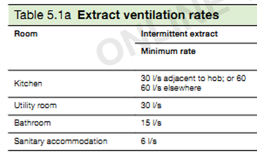

But that doesn't comply with building regs, does it?  17.5/s doesn't even meet the intermittent ventilation extract requirement for a utility room, the regs require that any non-continuous ventilation provide 30l/s for a utility room and 15l/s for a bathroom:
Two bathrooms and one utility room adds up to 60l/s, so the ~50l/s from this unit won't be enough, as I mentioned above, and an additional 10l/s of extract will be required from one of the rooms.  We can probably ignore this additional 10l/s of extract from the replacement air requirement, as it only needs to run for maybe 20 to 30 minutes, but that still leave the need to provide ~50l/s into the house for the few hours it takes to re-heat the cylinder..
The real issue is that there will need to be air vent(s) into the house with an equivalent area to a 160mm diameter hole.
Correct. If an older house has an existing ventilation system ie trickle vents and I add one of these units then I haven't found anything in Part F that indicates I have to update the ventilation levels. I therefore don't need to extract 50l/s from inside the house but can extract a proportion of that from inside the house and the remainder from outside the house. I will just be enhancing the existing ventilation system.

In this case, there is a requirement to comply with building regs as it's a new build ( @Thedreamer's installation with this unit providing the extract from two bathrooms plus a utility room).
Yes I agree, that's why I said there was confusion because you were talking about @Thedreamer's build and I was talking more generally about the GS200 as was first discussed by the op. We got there in the end.

Be interesting to see how you get on.  You will need to make sure that the build isn't at all airtight though, as all that extract air must be easily replaced with air from outside.   Trickle vents in the windows most probably won't be enough, and will probably be a bit noisy with the volume of air that will be drawn through them.
Building control should be fine as long as the extract rates in the regs are met.
