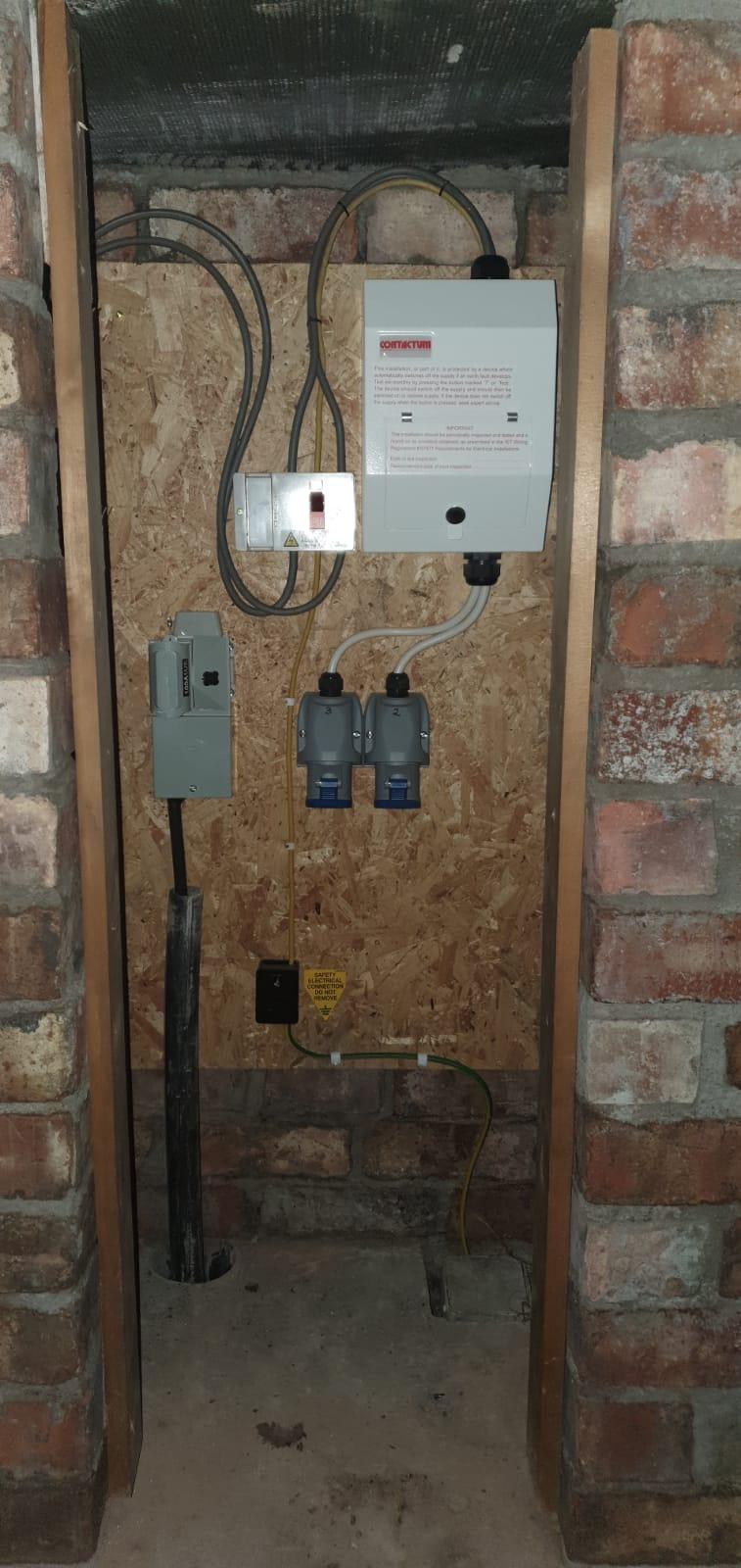

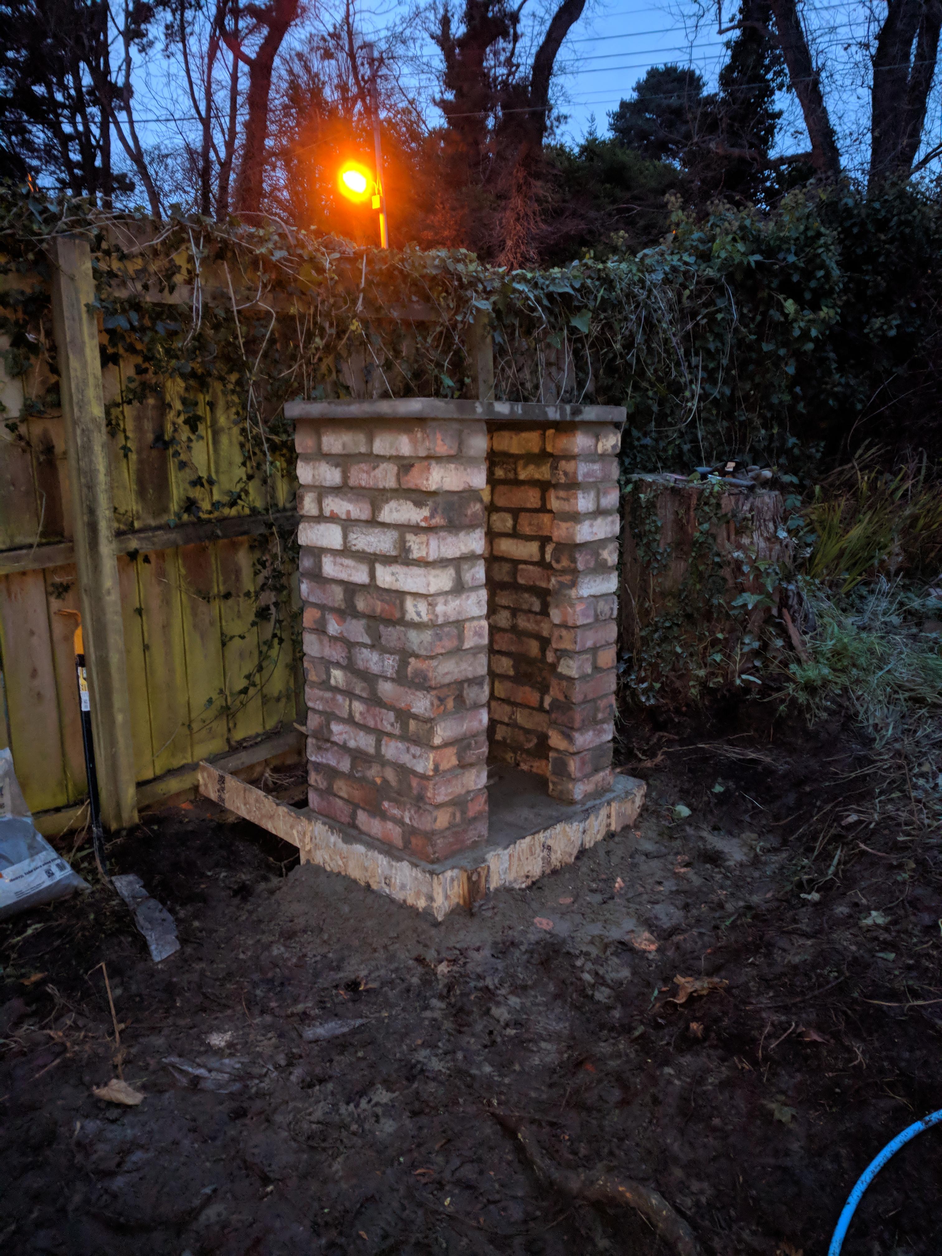

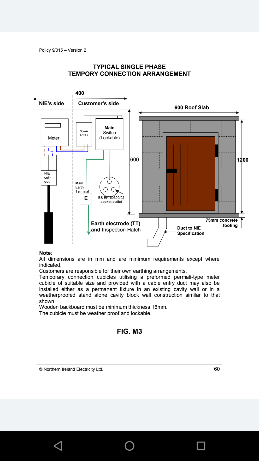

Conor Posted February 27, 2020 Posted February 27, 2020 This is what we were required to build: And how it ended up looking
Jeremy Harris Posted February 27, 2020 Posted February 27, 2020 23 minutes ago, Conor said: This is what we were required to build: And how it ended up looking This diagram has a very major omission, and should not be implemented as shown, under any cirumstances. There is NO over current protection, apart from the main fuse, which may well be rated at 100 A. As it stands, this diagram shows an unsafe installation. If the RCD was replaced with an RCBO, or if an RCD was used in series with an appropriately rated MCB or fuse, then it would be OK. I'm more than a bit surprised that any DNO or supplier would publish such a diagram, TBH. It looks as if that diagram was very sensibly ignored by the electrician who installed the TBS, with things installed as would be expected, with a DP isolating switch fuse immediately after the meter, then a CU that I hope contains both earth fault and over current protection to the two commando outlets.
Conor Posted February 27, 2020 Posted February 27, 2020 Funnily enough, the spark had nothing but bad things to say about the DNO and their requirements / standards.
Jeremy Harris Posted February 27, 2020 Posted February 27, 2020 1 minute ago, Conor said: Funnily enough, the spark had nothing but bad things to say about the DNO and their requirements / standards. I'm not surprised, given that diagram they provided!

Taff Posted February 27, 2020 Author Posted February 27, 2020 9 hours ago, Conor said: This is what we were required to build: And how it ended up looking Is that what you had to install prior to meter install?
