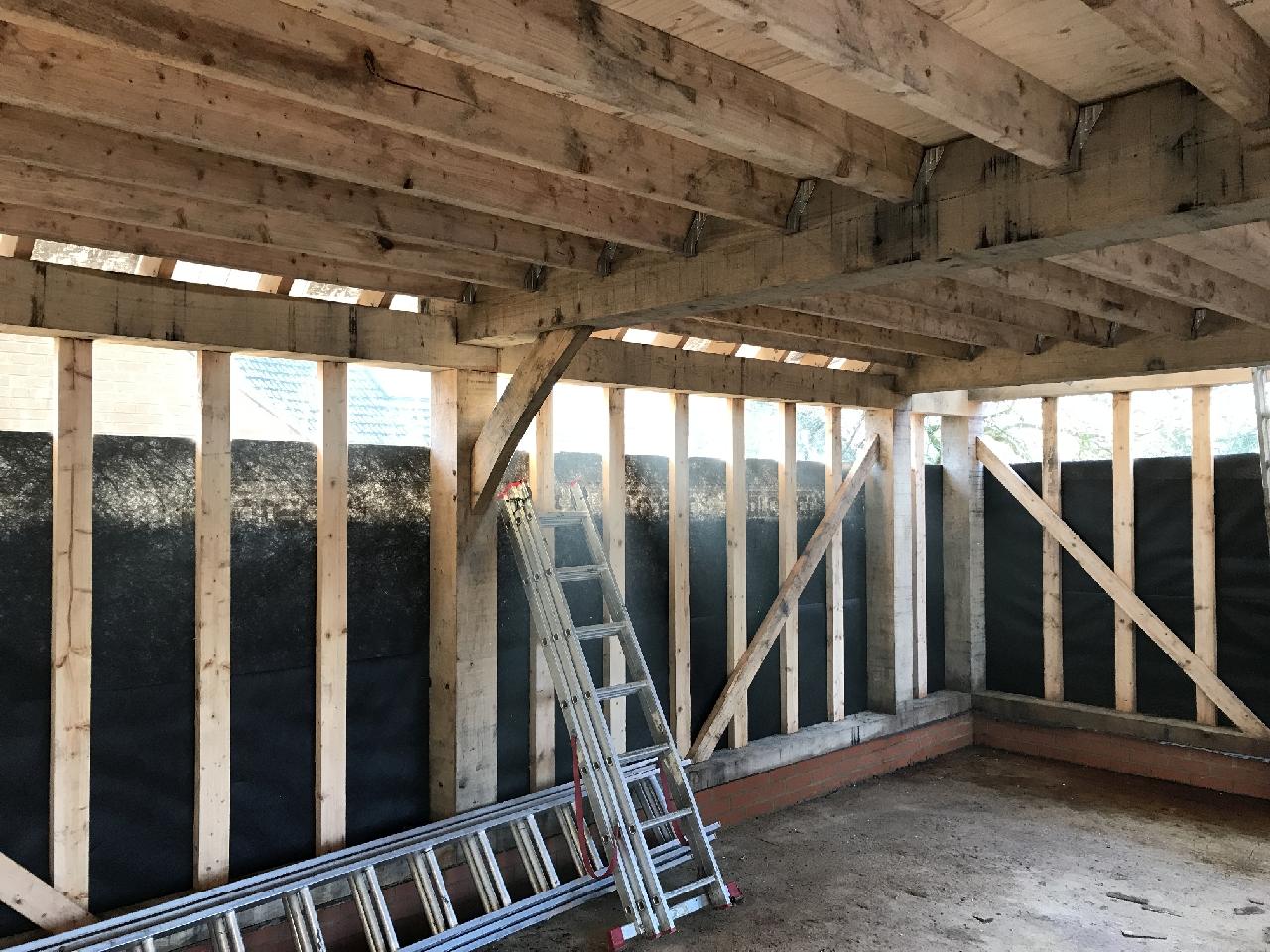

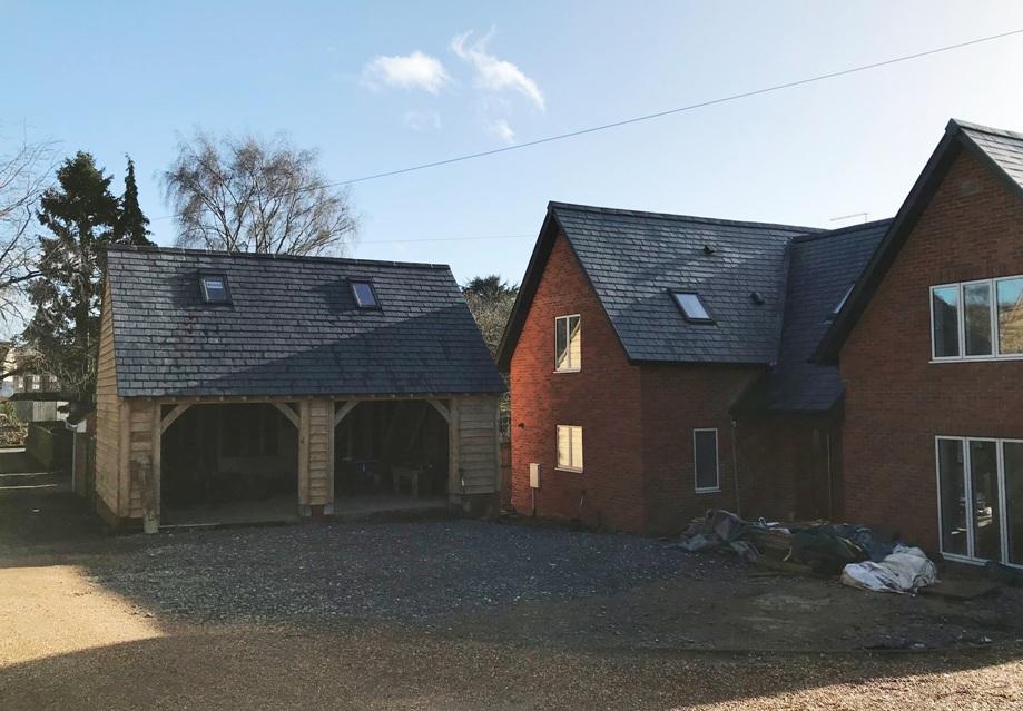

RandAbuild Posted February 17, 2020 Share Posted February 17, 2020 Our original planning consent was for a brick built traditional garage, but we changed it to an oak framed one. So glad we did - it has much more character and feeling it's been there a long time. This was good in design terms as it came between our more contemporary brick house and a stone built listed building opposite. It was quite big at 7.5m x 5.7m, with an internal staircase and huge upstairs storage room. It included some green oak timbers that were 300 x 200 - so many I saw seem to have 150 x 150 which look puny. Cost all in (including slates, velux and 2 electric doors, excluding foundations) was about 24k (no VAT - 2018) Link to comment Share on other sites More sharing options...

Taff Posted February 17, 2020 Author Share Posted February 17, 2020 5 hours ago, RandAbuild said: Our original planning consent was for a brick built traditional garage, but we changed it to an oak framed one. So glad we did - it has much more character and feeling it's been there a long time. This was good in design terms as it came between our more contemporary brick house and a stone built listed building opposite. It was quite big at 7.5m x 5.7m, with an internal staircase and huge upstairs storage room. It included some green oak timbers that were 300 x 200 - so many I saw seem to have 150 x 150 which look puny. Cost all in (including slates, velux and 2 electric doors, excluding foundations) was about 24k (no VAT - 2018) Looks lovely that’s what I have in mind, did you change your planning during the project? What company did you use and was it a custom build? Link to comment Share on other sites More sharing options...
RandAbuild Posted February 17, 2020 Share Posted February 17, 2020 We built the house before starting on the garage. This gave us enough time to go back to planning for an oak building, which was approved under delegated powers without any problems. The firm we used for the oak frame and oak cladding is based in Kent - Miller Supply and Build. I gave them a simple drawing and they worked it up from there. They were excellent and I would happily use them again. They supplied, delivered and erected the garage and we then got the same roofer who did our main build back for the roof, and a separate company for the 2 Hormann sectional doors. Link to comment Share on other sites More sharing options...
