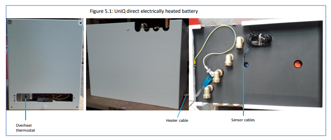

From the manual, the first pic on left, below is the over-temperature reset button location and at the end of the unit - I presume this is is the 'front' (if the heater cable (on the opposite end) is pushed against a wall)? Do either of the side panels have potential to be removed?

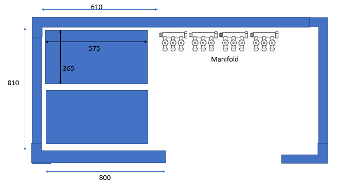

In my case, I have limited space for the units (manifold is fixed into position already) and no way can I stack them! So hopefully this arrangement will give me necessary access (to the reset button). If the uppermost one needs to be moved then that will mean shifting the other one first unfortunately. I have one heavy duty wheeled 'skateboard' to move each unit but was even thinking of knocking up another one so that they are easier to move in/out if required to in future (lockable wheels).
Plan view:

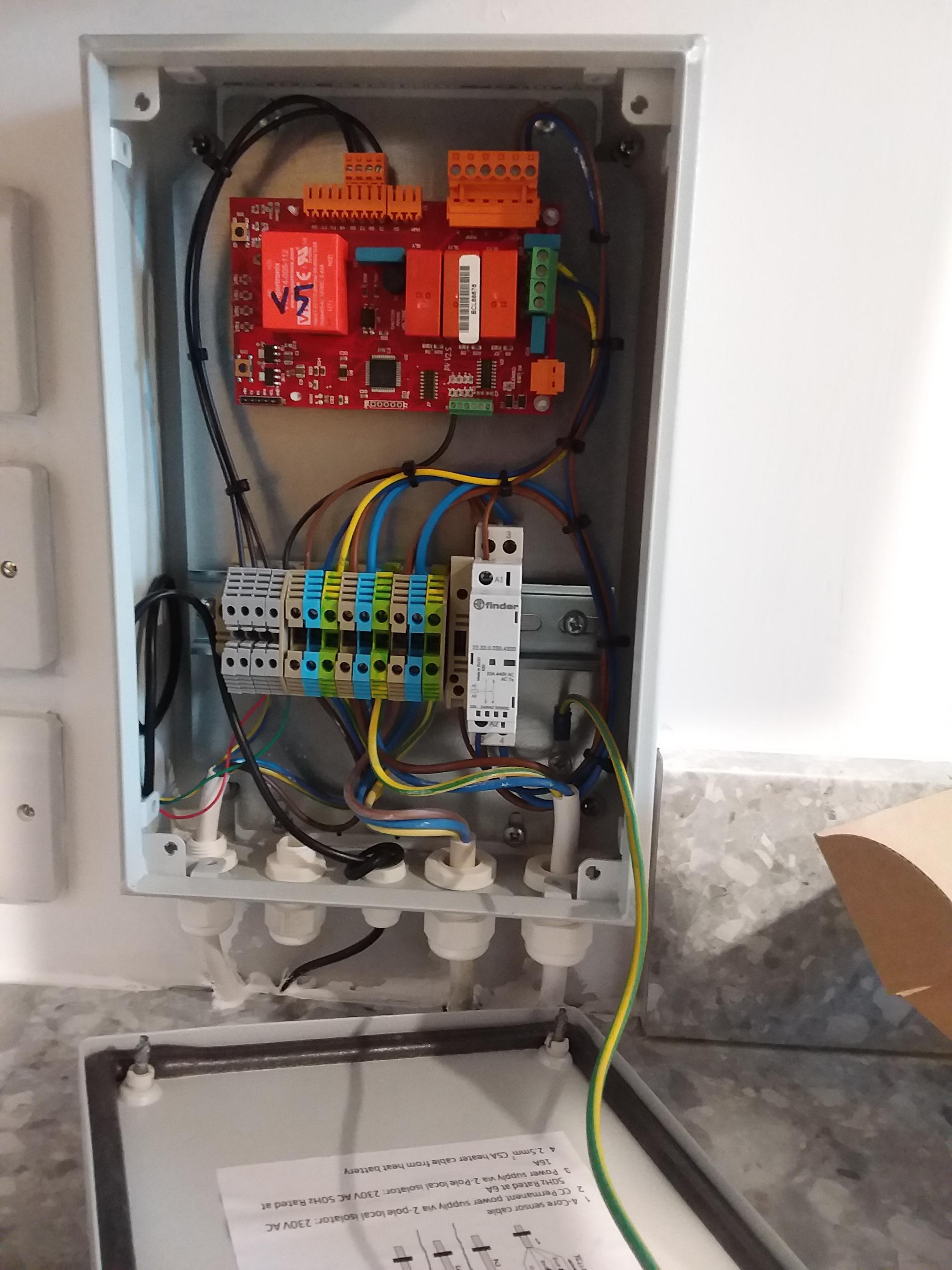

Ok definitely a finder. I have spoken to the technical director, which was good of him as he is off sick at the moment, and his initial view is that unlikely to be the battery. He has agreed I can phone him this morning with the control panel exposed and he will interpret any lights that may come on. As an aside if it proves to be the finder will a replacement 'simply' fit into the same bar?
Perhaps worth swapping the contactor over, just to eliminate it if nothing else, but worth doing some checks first.  The fact that the contactor is clicking, yet the unit isn't heating up, indicates that there's no voltage getting to the heating element.  Given that the Finder contactor in my unit gave up the ghost after two or three months, and that the symptoms when ours failed were exactly the same as yours, makes me suspect that you may have the same fault.   The contactor is a standard 1 module wide DIN mount one, and easily swapped.
The other thing to check is that the incoming power to the control box (the 16 A rated supply, not the low current control supply) is actually there.  Checking the voltages at the contactor should prove that.  Terminals 1 and 3 at the top should have the incoming supply voltage on them all the time the unit is being powered (in your case by the boost function I suspect).  Terminals 2 and 4 at the bottom should have power on them whenever the contactor has closed.  If you have access to a suitable meter and feel competent to use it, then checking the voltage at these points would give a very good insight into what may be going on.

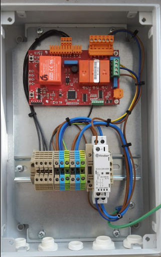

My units are size 12 units, in which case I should be okay then if they are in the external controllers. However the last controllers I had were the sbc_01 which did not appear to have any LEDs:
I can see the leds in that pic ;)
Okay, I couldn't make them out from the pic, but you know what to look for. Thanks!

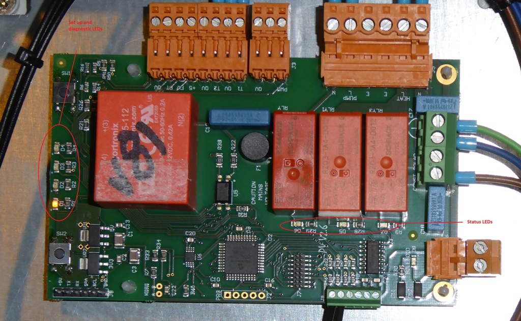

So apart from the side of the unit that has the heat heat thermo reset button, are there any other panels that may need to be accessed for normal 'checking' / 'servicing'
The vertical row LEDs on the left aren't much use for day to day monitoring, unfortunately, they are really only any use when setting the unit up and checking to see whether it's in cold start mode.
The most useful LED is the one over on the right, under the relay that switches the main contactor on and off, as that shows whether the unit is "calling for heat" (each of the relays has a status LED underneath it, in a horizontal row).  That LED is the reason my unit is still sat with it's lid off (not recommended - it exposes mains voltage connections - just don't poke your fingers inside).  I glance at it to check whether or not the unit is ready to accept charge or not, something that is extremely useful to be able to see on a regular basis.

Thanks @Jeremy Harris - Just what I needed to know. Would have been sooooo difficult to incorporate those LEDs into the cover panel....a mere cost of a few £.
