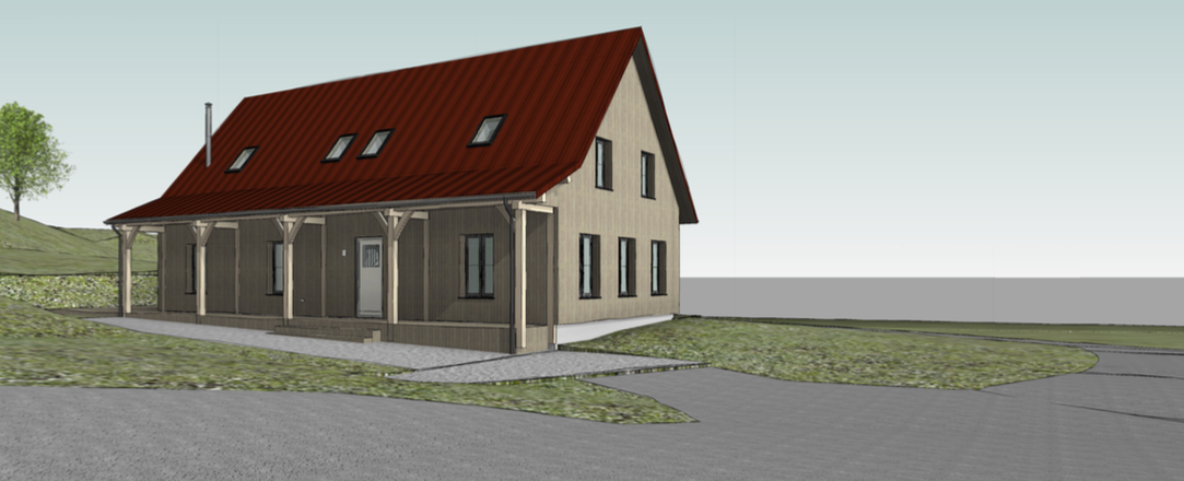

Joanna Susskind Posted January 24, 2020 Posted January 24, 2020 Hey everyone. We are building on Bantaskin Street in Maryhill, Glasgow. Foundations complete and we are now working on the frame onsite. One of our build requirements (via Glasgow City Council who have initiated this project) is that we meet the "Silver Active" energy efficiency rating. Our architect has specced a whole bunch of things for us and we have the certificate. I spoke to him and asked about changing things/moving things around, and how to check whether or not we would still meet Silver Active and he wasn't very helpful. Does anyone know more about this? I'm thinking we should remove 5 PV panels, which might not do a huge amount in grey Glasgow, (but cost a fortune!) and try to come up with something more clever? We are hands on, and working with a small budget, so want to be creative and innovative here if possible. Ideas and thoughts welcome! Thanks Joanna
