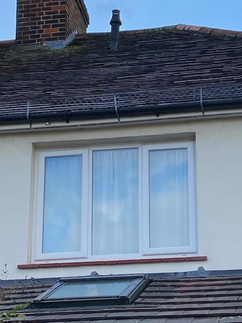

MrSniff Posted January 24, 2020 Posted January 24, 2020 +1 on the Sandtoft 20/20. Not handmade, but we used them on a rear extension with a shallow pitch some 10 years ago (instead of interlocking concrete which as far as I could tell was the only other option). Not a great pic, but the only one I have to hand (lower roof line). 1
