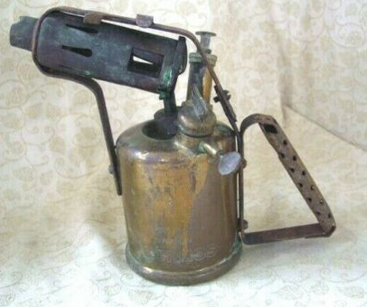

The great thing about an old oil burner is that it's (reputably) quite easy to get a handle on how it works. For me I thought I did but maybe I was just living in ignorant bliss. From memory it has a thermostat that detects when the water in the box surrounding the burner cools below a certain point. It struck me when I first open it up that it was basically the same as a wood burning stove that also heats the water but instead of putting wood in it you just shoved a blow lamp into the front where the door should normally go on a stove.
