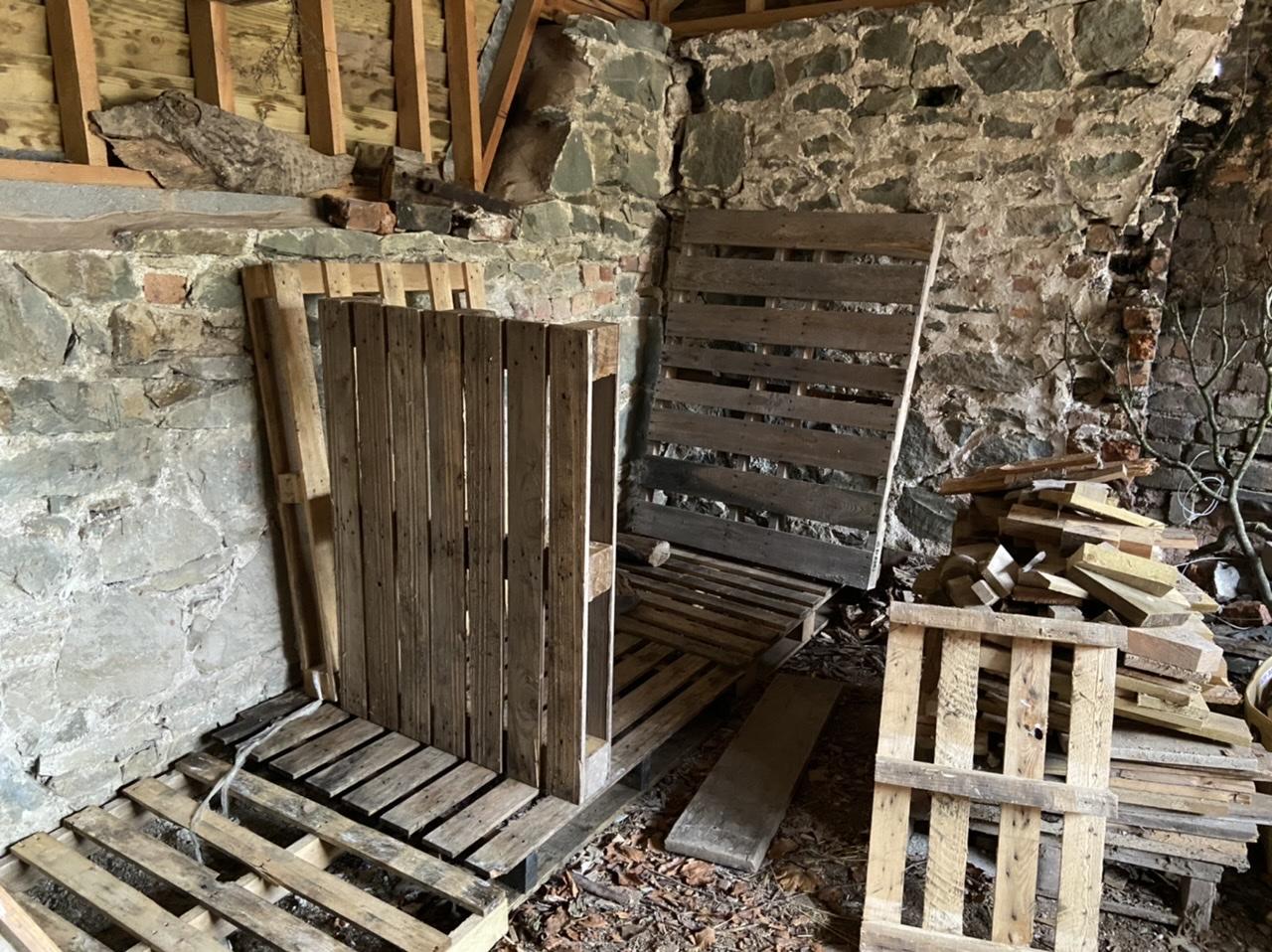

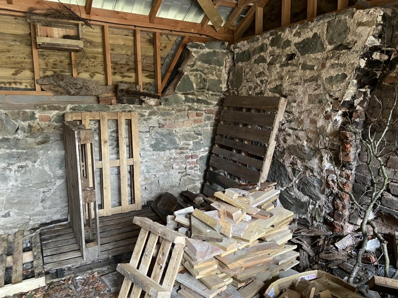

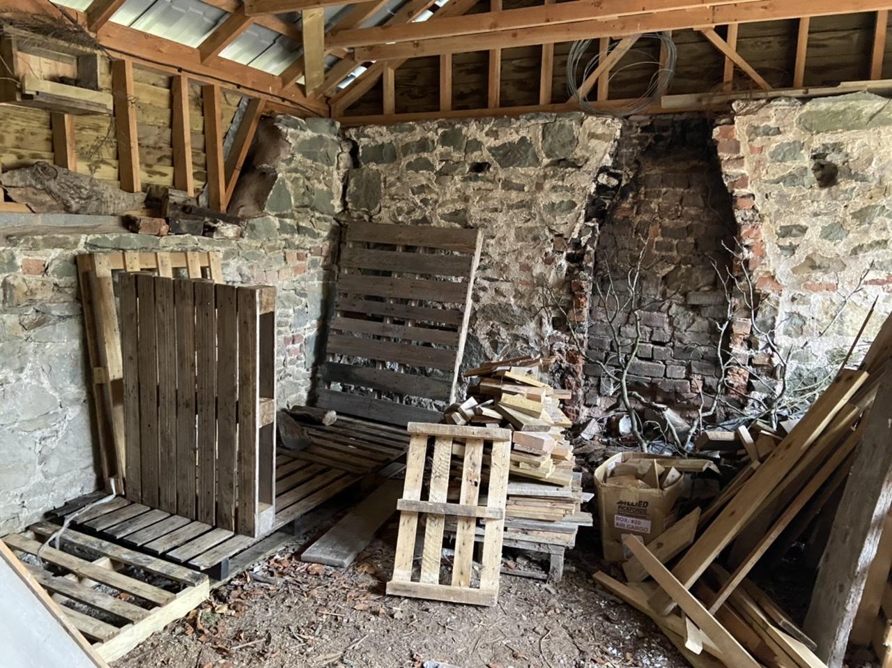

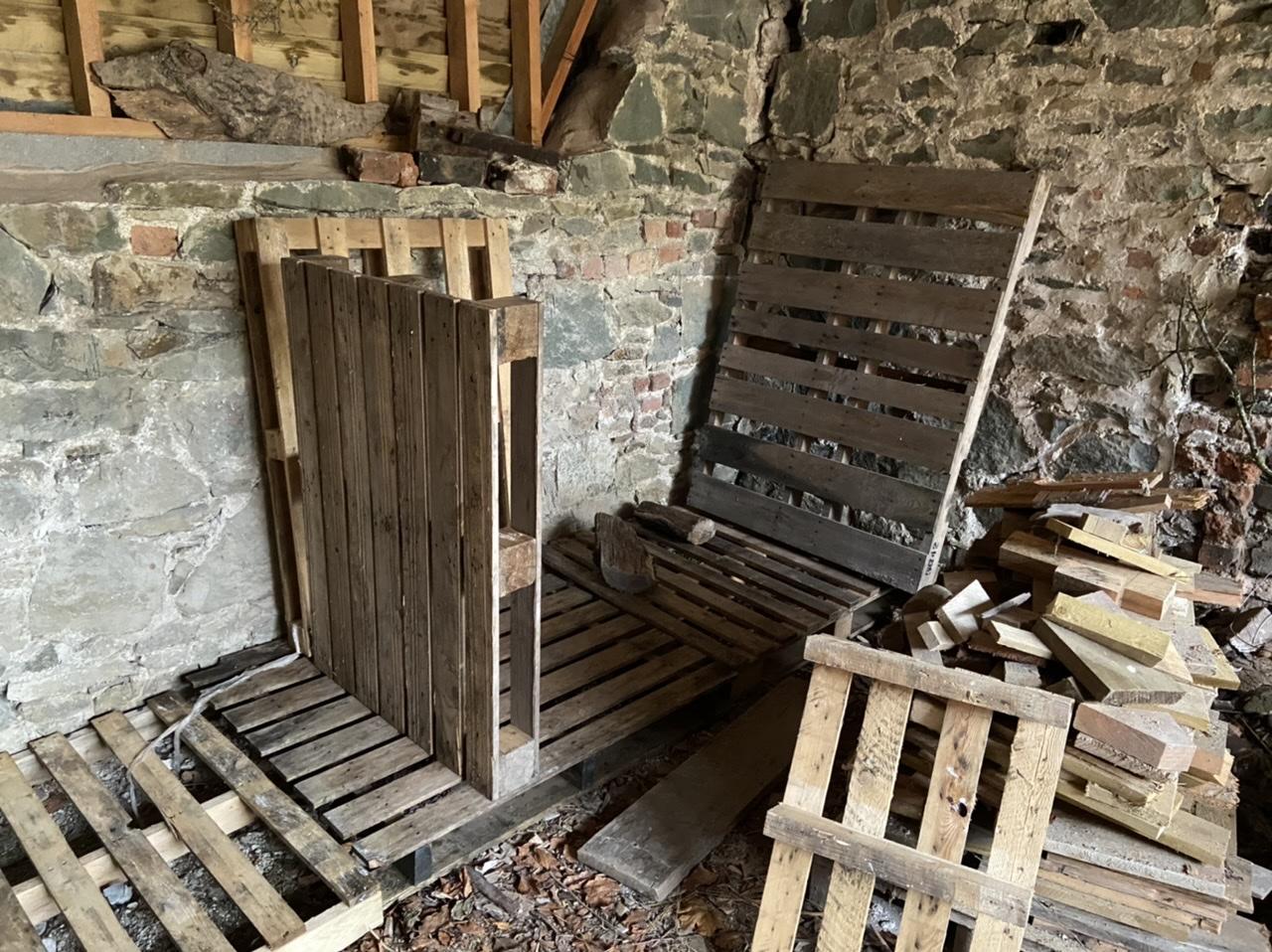

H F Posted January 2, 2020 Share Posted January 2, 2020 Best wishes to everyone for the decade ahead. My project for the week ahead is to build a wood drying area in our garage for logs and kindling. My plan is to use pallets for the ground area and partitioning walls. See pics. I don’t want to drill into our stone wall - any advice on how I can robustly construct this so that everything is super sturdy? Link to comment Share on other sites More sharing options...

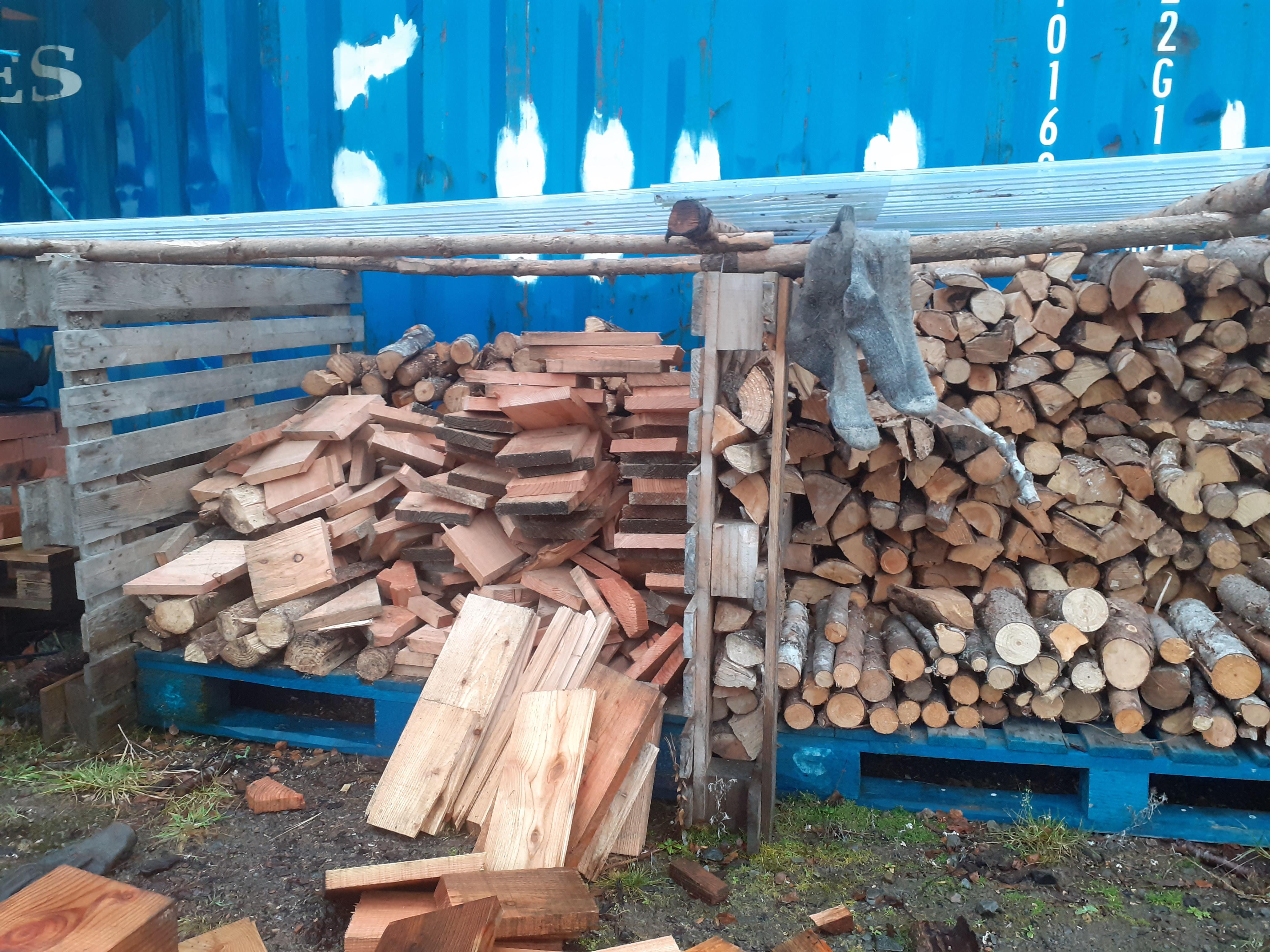

jamieled Posted January 2, 2020 Share Posted January 2, 2020 We have an outside one for the Caravan. You won't need the plastic roofing, but you can brace it across the top in the same way with any leftover wood. Piccy below, ignore the manky socks! 1 Link to comment Share on other sites More sharing options...
H F Posted January 2, 2020 Author Share Posted January 2, 2020 Thanks for that. Bridging across the top makes sense. I was also thinking of running a supper on the back and making U shapes. Link to comment Share on other sites More sharing options...

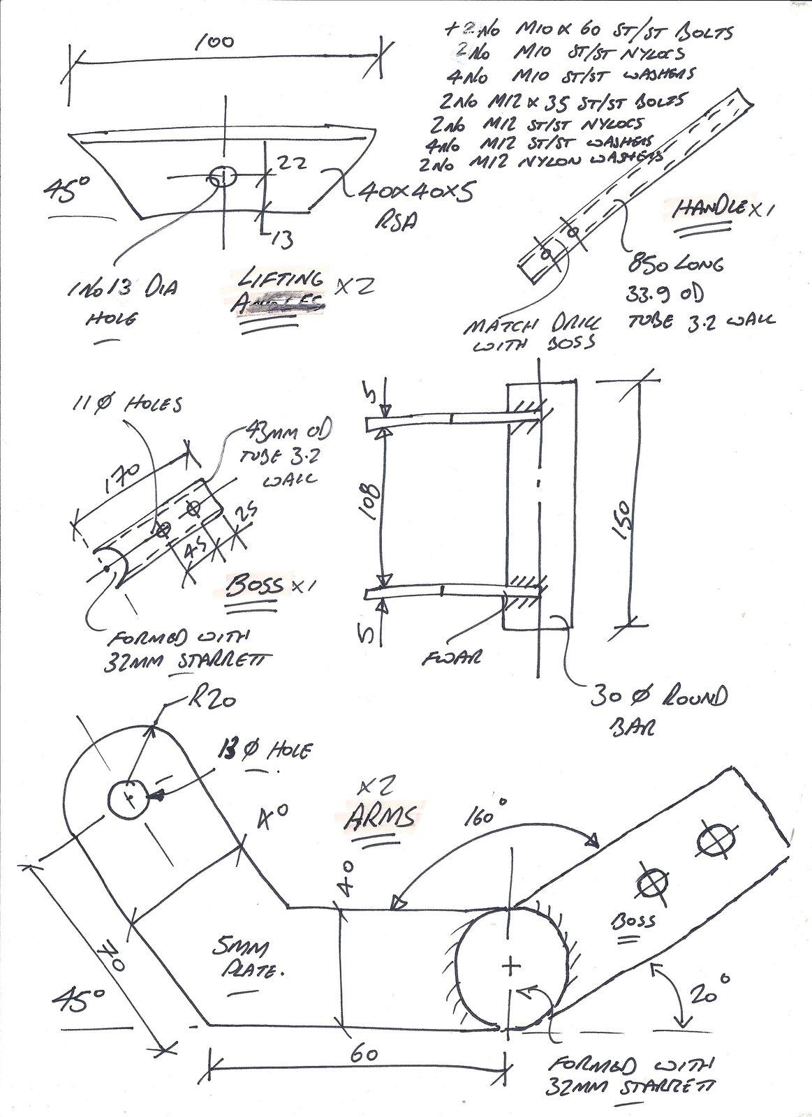

H F Posted January 2, 2020 Author Share Posted January 2, 2020 OnOff, how did you “break” the pallets without ruining the long lengths of wood. Some pallets have 3-4 nails per section and it’s impossible to separate the wood without cracking and splintering the wood. Link to comment Share on other sites More sharing options...
Onoff Posted January 2, 2020 Share Posted January 2, 2020 I made one of these: Fag packet sketch I did is on here somewhere. Link to comment Share on other sites More sharing options...

Onoff Posted January 2, 2020 Share Posted January 2, 2020 (edited) Mine won't work on all pallets especially like some of the close boarded ones. It's meant really just to go over the 2" width where the cross bearers are say 3 or 4x2. This type has merit: https://www.machinemart.co.uk/p/roughneck-64-644-pallet-buster/? Should work on all types for instance even where the bearers, second layer down are 4x1 width ways. Note though mine articulates and the angle irons spread the load so you lift two nails at once so less chance of splitting the wood. I'll make a universal one one day with quick release pins! Edited January 2, 2020 by Onoff 1 Link to comment Share on other sites More sharing options...
