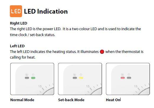

Temp Posted March 3, 2020 Share Posted March 3, 2020 (edited) Humm, see what you mean. Doesn't look like setback is working. Lounge should probably have fallen to perhaps 16-17C by 5.45am - unless the place is very well insulated. Did you notice which if any LEDs on the lounge stat were illuminated? Right hand LED should be yellow if its correctly in setback mode (and not calling for heat). Left hand LED either on or off depending if its calling for heat or not. Edited March 3, 2020 by Temp Link to comment Share on other sites More sharing options...
stearman65 Posted March 3, 2020 Share Posted March 3, 2020 54 minutes ago, Temp said: Humm, see what you mean. Doesn't look like setback is working. Lounge should probably have fallen to perhaps 16-17C by 5.45am - unless the place is very well insulated. Did you notice which if any LEDs on the lounge stat were illuminated? Right hand LED should be yellow if its correctly in setback mode (and not calling for heat). Left hand LED either on or off depending if its calling for heat or not. Hi Temp The set back does work using the switch & the LEDs change, but the difference in temperature fluctuates between 4 & 10 degrees in the rooms I have thermometers in, which is why I don't want to use it but just have the boiler switch off between midnight & 6am 7 days per week. Regs Eric. Link to comment Share on other sites More sharing options...
