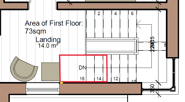

moldy Posted December 9, 2019 Share Posted December 9, 2019 I'm thinking of changing the handedness of my stairs and I thought maybe I could place the MVHR on the landing in a cabinet approx 1.4x0.8. It would need to extend over the stairwell a bit. Can anyone foresee any problems? Link to comment Share on other sites More sharing options...
jfb Posted December 10, 2019 Share Posted December 10, 2019 do you have a plan for the ducting? are you using radial/manifolds? have you allowed room for a silencer on the supply side? easy access to filters? I think you might be underestimating how much space a typical MVHR setup takes. Link to comment Share on other sites More sharing options...
vivienz Posted December 10, 2019 Share Posted December 10, 2019 Noise. You will need plenty of sound proofing in there if you don't want to hear it in the rest of the house. Link to comment Share on other sites More sharing options...
Barney12 Posted December 10, 2019 Share Posted December 10, 2019 (edited) As has already been mentioned don't underestimate how much space is needed for all the "gubbins". It takes a fair degree of planning to keep it tidy in a confined space. I think "noise" must be impacted by make/model and system design? I have an Airflow Androit system and it lives in an under eaves space accessed from one of the bedrooms via a simple plain door (no sound proofing, not even a draft seal). The separating stud wall (plasterboard on one side only) has some 50mm celotext between the uprights but that is it. It is completely inaudible with the door shut and isn't even that loud if you're next to it in the eaves itself. The only time you can hear it in the bedroom (or from any of the terminals in each room for that matter) is if its on boost. EDIT: I guess I should add that it does have a silencer fitted and all of the inlet and extract pipework I.e. the two to outside the building) are well insulated. Edited December 10, 2019 by Barney12 1 Link to comment Share on other sites More sharing options...
Barney12 Posted December 10, 2019 Share Posted December 10, 2019 Another EDIT ref noise: Thinking about it my radial ducting to/from each room is either a)first floor - buried within the warmcell blown insulation of the vaulted ceilings b)ground floor - burred in rock wool in the ceiling void. Perhaps this helps too? Link to comment Share on other sites More sharing options...
Nickfromwales Posted December 10, 2019 Share Posted December 10, 2019 5 hours ago, Barney12 said: Another EDIT ref noise: Thinking about it my radial ducting to/from each room is either a)first floor - buried within the warmcell blown insulation of the vaulted ceilings b)ground floor - burred in rock wool in the ceiling void. Perhaps this helps too? The noise comes from the unit itself in most cases. I’m routinely fitting Brink units atm and they’re really well respected ‘in the industry’ as the weapon of choice ( when PH certification levels of quiet are the requisite ). Brink do a range of bolt on ( manufacture specific ) silencers now, so I’m going to trial those and see how they compare to the normal / knee-jerk flexible acoustic attenuators in real life. Current ones I’m fitting in a high-demand dwelling are the box attenuators which are a metre long !!! Bloody big game of Jenga currently going on in that plant room ! Compare apples with apples here though, as some MVHR units have integral heat pumps for auxiliary heating / cooling, which are noisy if not high - specification units, or standard MVHR units with just heat recovery which are very quiet out of the box. Link to comment Share on other sites More sharing options...
