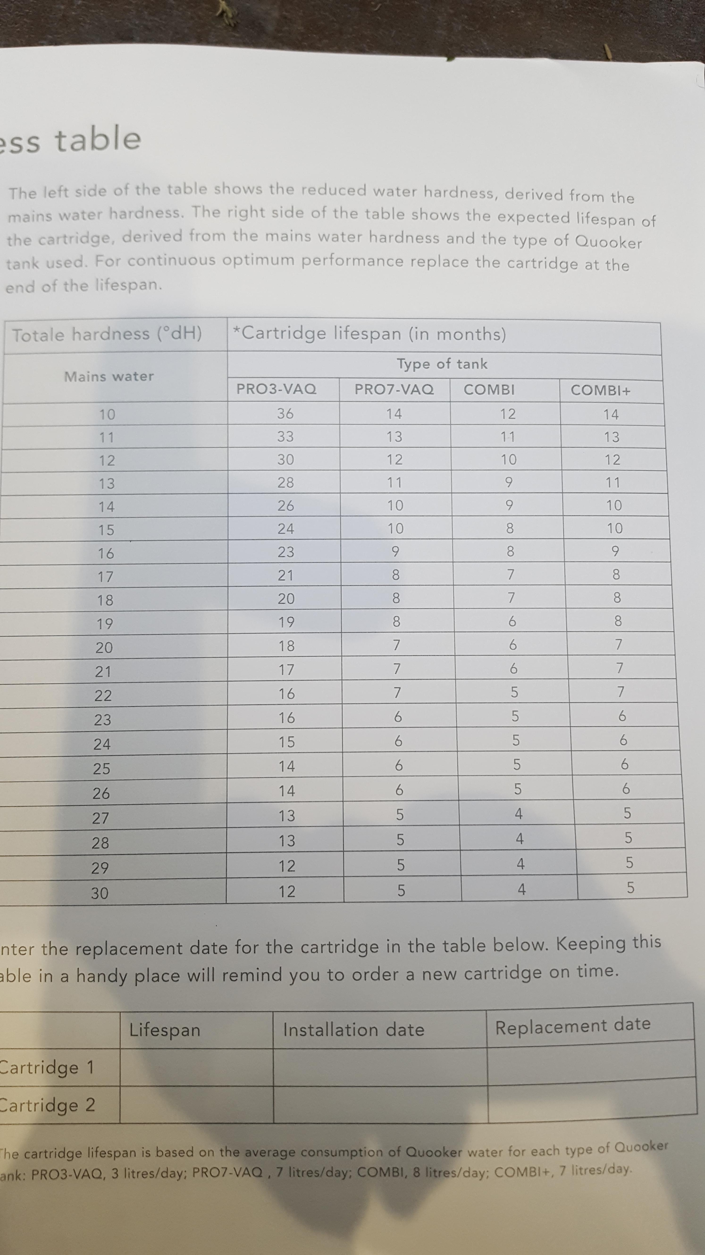

nod Posted December 3, 2019 Posted December 3, 2019 Does anyone no when the filter needs replacing I’ve looked on there site at they recommend the whole unit serviced after 5 years No mention of the filter I see most of the other makes recommend the filter replacing every six months
vivienz Posted December 3, 2019 Posted December 3, 2019 I think it is a couple of times per year, depending on water hardness. I will check in my info this evening, unless someone responds earlier.
nod Posted December 3, 2019 Author Posted December 3, 2019 31 minutes ago, vivienz said: I think it is a couple of times per year, depending on water hardness. I will check in my info this evening, unless someone responds earlier. Thanks Viv I can’t seem to see it online
joth Posted December 3, 2019 Posted December 3, 2019 They have numerous filters, the one for the boiling water tank is only supposed to be changed every 3-5 years, but isn't intended for dealing with hard water https://www.quooker.co.uk/most-frequent-questions/what-maintenance-does-a-quooker-require https://www.quooker.co.uk/faq/faq/index/tag/change-filter/ The filters for cold/sparkling water and scale control are significantly more frequent (I'm not planning to install either those; just run it from the whole-house water softener instead)
vivienz Posted December 3, 2019 Posted December 3, 2019 You can run it from softened water but Quooker specifically recommend the filter.
joth Posted December 3, 2019 Posted December 3, 2019 Of course they do - they get a steady income from all the replacement filters! ? (And it'd be distinctly odd for them to have a scale reduction product and not recommend it) Our local water softener shop is also a Quooker dealer, and recommended the other approach to us. Also FWIW, on that link I included before, Quooker say "You can install a descaling system in front of the Quooker, such as the Quooker Scale Control,...." which to my interpretation is really only them giving one example of how to solve it, not an attempt to place any kind of restriction on which you use.
Jeremy Harris Posted December 3, 2019 Posted December 3, 2019 Our boiling water tap came with a phosphate dosing softener cartridge filter. Very expensive, around £40 a time to replace it, and it needed replacement every 6 months. Like @joth, I made enquiries, then removed the filter and have been running our boiling water tap on softened water. It seems that the makers of boiling water taps often charge a pretty high price for replacement filters. The filter that came with ours had a pretty unique bayonet fitting, that I couldn't find anywhere else. I'm pretty sure it had been designed like this to force you to buy their expensive replacement cartridges. Reminded me a bit of the sales model for inkjet printers. 1
vivienz Posted December 3, 2019 Posted December 3, 2019 Here you go, @nod This should give you the info you need. We're about 4 months on now with ours and I am considering switching to the house softened water. We set the filter to the hardness level indicated but we have a slight bit of leakage from the tap and at the base it's leaving a trace of limescale so I assume the filter isn't as effective as the water softener. I will turn up the filtration level for the life of this filter but after that, I think it's simpler to just use softened water. 1
