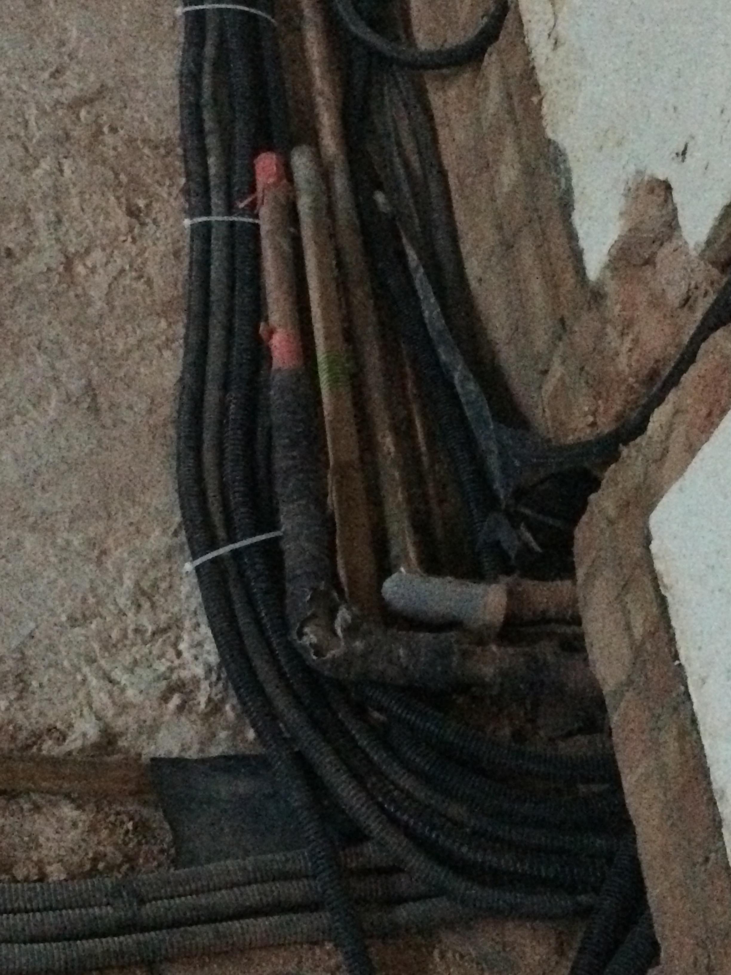

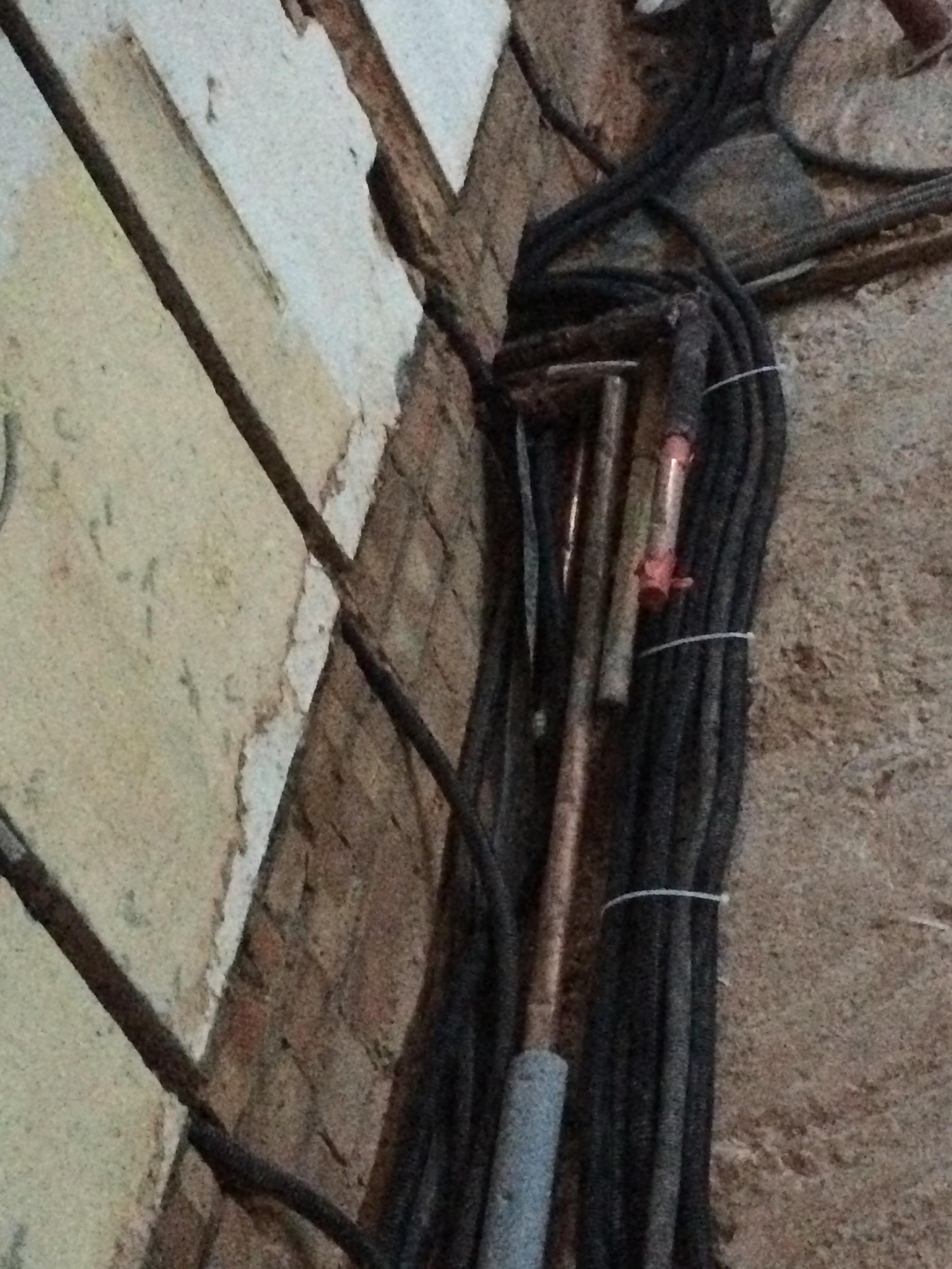

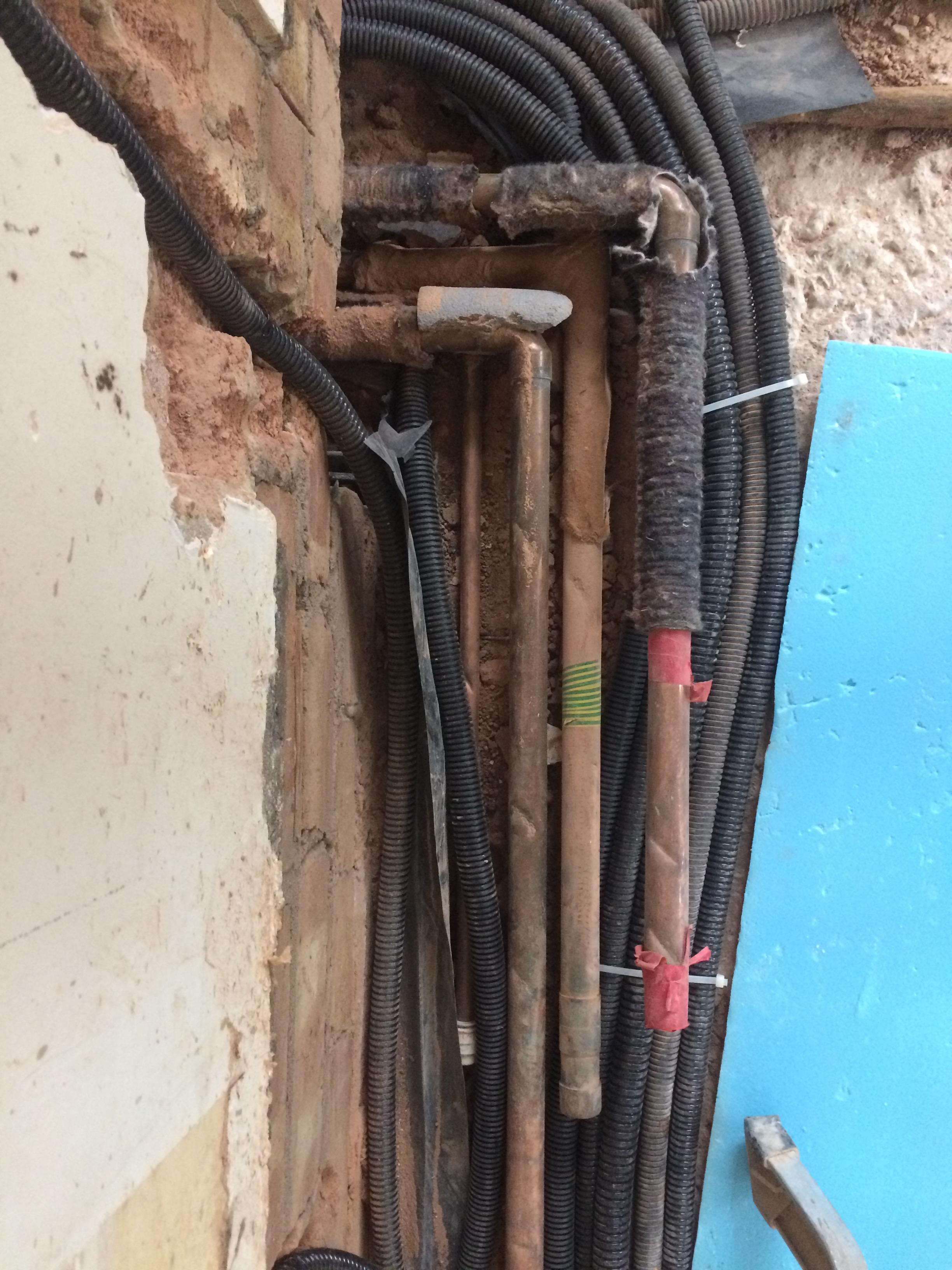

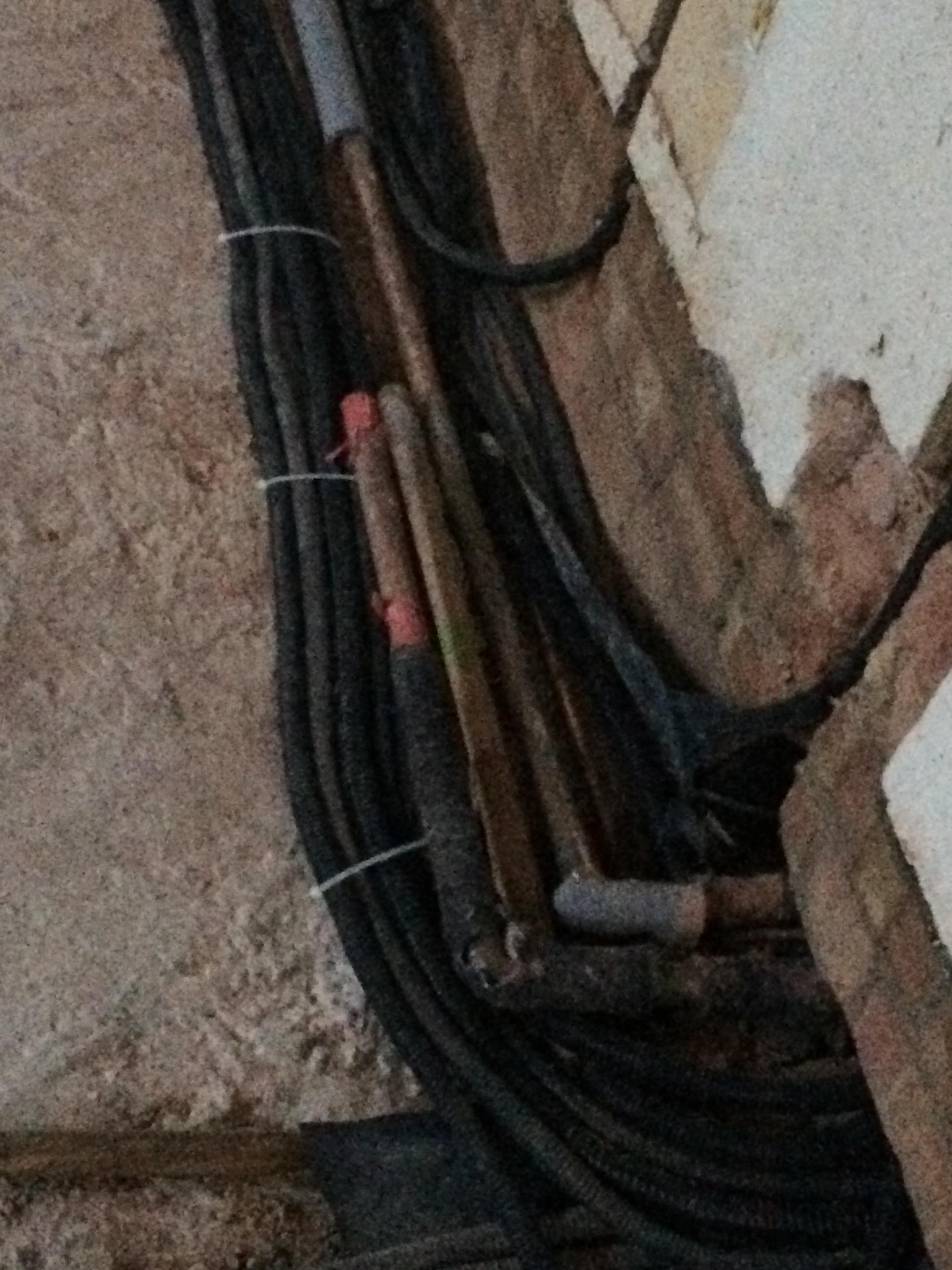

The kitchen floor is currently under construction.  there is 100ml poured concrete slab in situ.  On TOP of this the plumber HAD floor mounted all the pipes - gas, water - softened and un-softened.  Insulation, then screed was laid on top.  These pipes were floor mounted at the periphery of the room, on top of which would sit tall kitchen units.
Due to screed failure, I had to take up the screed, UFH system, insulation - All of it.   Newly appointed second Builder came along - then questioned why the plumbers pipes are floor mounted?  said it would lead to screed failure as 65 ml minimum thickness would become much lesser and therefore risk of cracking and said that actually the plumbers pipes should all be wall mounted, a) for access b) to not be within or impact the screed.
So the poor plumber has actually started to rip up all those pipes.
There will be some plumbing pipes on top of the concrete slab though - gas supply to the island and radiator pipe as (UFH will not be sufficient as sole and only source of heating)

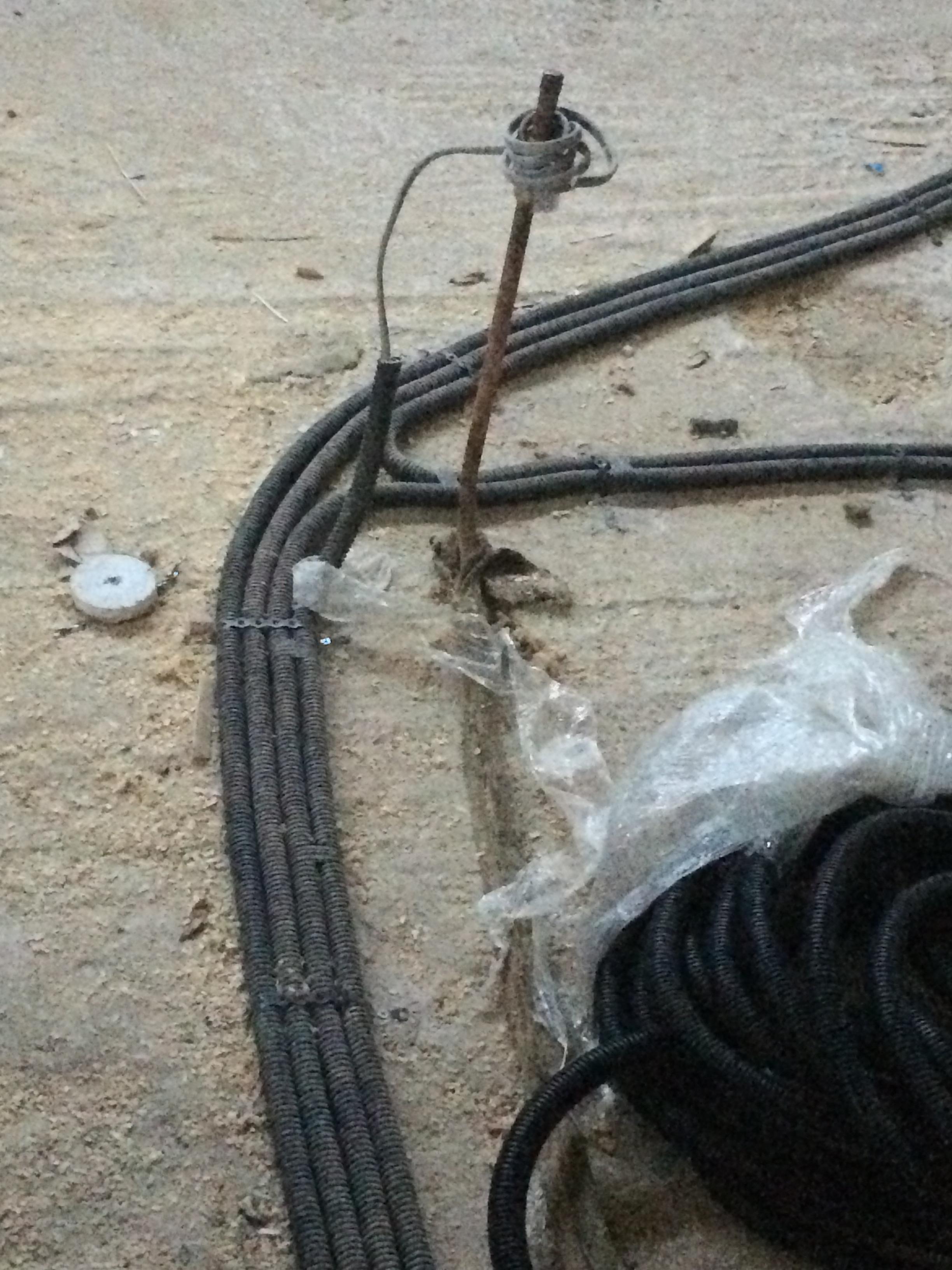

The electrician subsequently came and did all his first fix and he too has floor mounted all his cabling in 2cm conduits, rather than ceiling down with all his chasing and cabling (I can only presume was easiest route for them) and 1st floor was boarded up with tongue and groove chipboard.
Im now pondering whether asking the poor plumber to rip up all his pipework and wall mount is actually the right thing to do??  Ive lost trust in a lot of tradesmen and even 2nd appointed builder isnt thinking about the whole project holistically and im having to work out alot of things for myself.
So the question is if youre refurbishing a kitchen (NOT an extension) and done away with the suspended timber floor, poured concrete and then laying insulation, Wet UFH system and then 65 ml screed - is it NORMAL (common practice) to wall mount the plumbers pipes?  If so, should that be above screed level, or can it be wall mounted within the screed.
I spoke to the kitchen firm - they confirmed a 10cm plinth above the screed which can hold pipes of any diameter, above that are tall kitchen housing units with integrated appliances with only a 2cm void.  Ive looked at what remains of plumbers current floor mounted pipes - there are 4 - two of which are 5cm in diameter each with the insulation surround.  Kitchen firm suggested to try and keep plumbers pipes in 10cm plinth area but they wont all fit there.  Or for the pipes to be still wall mounted but within the screed layer.

Personally, were I doing a renovation with a new slab in the floor, I would not bury pipes or wires in the screed or slab simply for maintainability reasons, studding out the wall where necessary.
It sounds, as has been remarked, that the Planning / Supervision may have been insufficient.
If they are wall mounted I would not see a need to conduit the electrics, or in extremis perhaps even insulate the water pipes. I would aim to minimise plumbing runs, but elec would need to go everywhere as I fit a *lot* of sockets.

Subsequently the plumbers pipes - gas and water feeds (there’s 4 pipes in total ....) could then I guess be chased into the bricks, ie above the finished floor level but behind the units.  There is a 10cm plinth above FFL, where pipework can be of any diameter but then above that the void behind kitchen cabinets is only 2cm.

Other idea I had is to maybe chase concrete slab for the electrics conduit and plumbers pipes to fit snugly there.  I’ve been quoted bout £800. And then insulation can sit flat on top with minimal chasing.  Is this an OK alternative? The obvious issue is access for maintenance if ever plumbers pipes or electrical cabling ever fail.   How often does that happen?  The plumbers pipes are all copper and the electricians cabling is all in galvanised steel conduit.
Option 3 - chase out insulation for electrician pipes and wall mount plumbers pipes - can’t chase in these as electricians pipes running floor up chased in already.

You can run pipes and wires under and behind kitchen units.  For the island these will need to run under the floor then come up.  You could create a channel in the floor or you could create a small tunnel for the pipes to sit in with 30mm insulation above and 30mm supporting either side.
You really need to minimise what goes under the floor and keep any joins and fittings to as few as possible.
60mm is fairly poor for insulation and UFH.  Why not have more insulation and lose the screed and have an overboard system?  You can still have a tiled finish.
