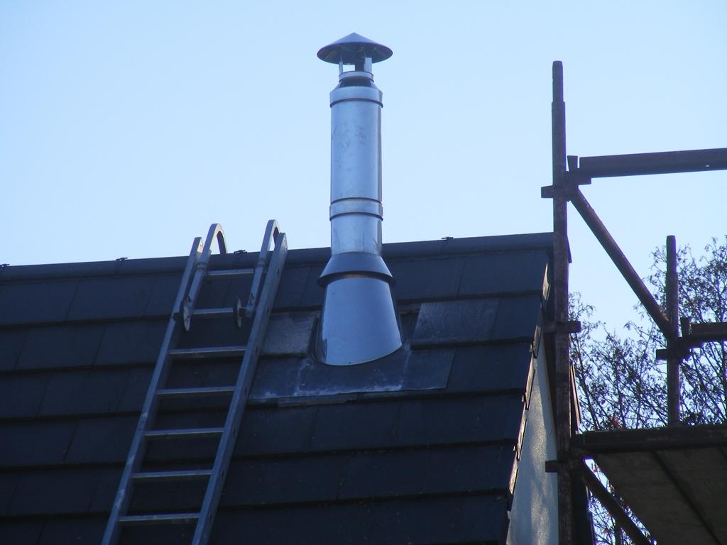

Mulberry View Posted November 22, 2019 Share Posted November 22, 2019 I need a good quality Storm Collar for a 6" Twin Wall Flue, to go above the lead roof flashing. I've had a couple of goes at it, they're all just flimsy crap with poor adjustment that pulls the thing out of shape and it ends up leaking. Any good recommendations? Link to comment Share on other sites More sharing options...
Russell griffiths Posted November 22, 2019 Share Posted November 22, 2019 Have you not got a big rubber flange thingy with an aluminium outer that slides over the flue. This is what I have, I have never got around to actually fitting it down to the roof it is just slid on and pushed flat to the roof and it doesn’t leak even when not finished correctly. Do you have a pic Link to comment Share on other sites More sharing options...
Mulberry View Posted November 22, 2019 Author Share Posted November 22, 2019 8 minutes ago, Russell griffiths said: Have you not got a big rubber flange thingy with an aluminium outer that slides over the flue. This is what I have, I have never got around to actually fitting it down to the roof it is just slid on and pushed flat to the roof and it doesn’t leak even when not finished correctly. Do you have a pic No, I have a lead flashing with a lead upstand. you're expected to use a secondary storm collar. I can't recall why the rubber all-in-one flashings weren't an option for me though? No pic of mine, but I'll try and get one over the weekend. Hopping on the roof is tricky at the moment as I'm 6 days post surgery. ? Link to comment Share on other sites More sharing options...
Russell griffiths Posted November 22, 2019 Share Posted November 22, 2019 Why not get a rubber one and cut the aluminium bit off and just use the rubber to pull down and sleeve over the lead upstand. Link to comment Share on other sites More sharing options...
ProDave Posted November 22, 2019 Share Posted November 22, 2019 My lead flashing came with a suitable "Chinaman's Hat" that slides over the flue, slides down onto the top of the flashing and clamps to it. I also sealed the gap between the flue and the "hat" 1 Link to comment Share on other sites More sharing options...
