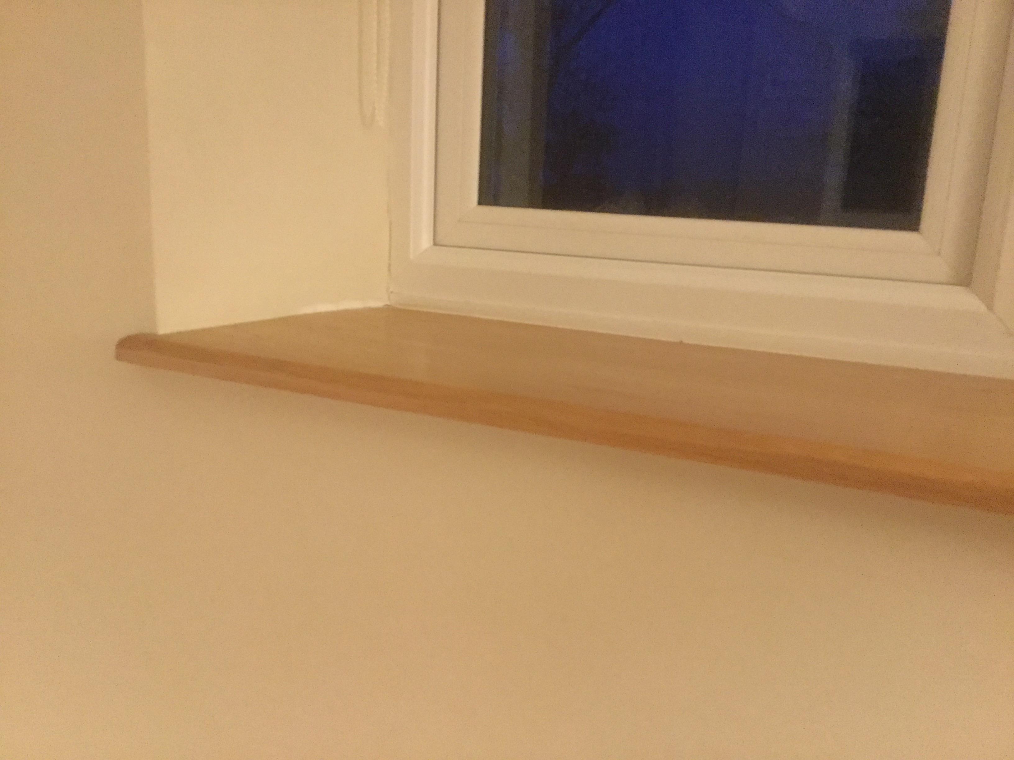

H F Posted November 14, 2019 Posted November 14, 2019 All our windows are double glazed and we wood fillered all tiny cracks. The house is warm (it’s freezing outside) and we can feel some cool air around the sill (not a draft). Is this normal?
Mr Punter Posted November 14, 2019 Posted November 14, 2019 It is very common. Very little effort goes into insulating window heads, cills and reveals.
H F Posted November 14, 2019 Author Posted November 14, 2019 9 minutes ago, Mr Punter said: It is very common. Very little effort goes into insulating window heads, cills and reveals. Bummer. Are there any tricks to combat this?
Alex C Posted November 14, 2019 Posted November 14, 2019 (edited) 13 minutes ago, Home Farm said: Bummer. Are there any tricks to combat this? Yes, Fit the window in to a properly sized opening in an insulated wall and in line with the insulation not in front or behind it. (not always easy in a retrofit) Foam carefully around the window when it is installed put a strip of insulation as a break at the rear of the window board You can also fit foam backed plasterboard around the opening on the inside part covering the edge of the frame to reduce any bridging. Edited November 14, 2019 by Alex C
H F Posted November 14, 2019 Author Posted November 14, 2019 So this would require removing the windows? If so, that’s not a realistic option for us. Guess we’re stuck with shoddy workmanship for the foreseeable future.
Mr Punter Posted November 14, 2019 Posted November 14, 2019 You could just take the cill up and have a look.
H F Posted November 14, 2019 Author Posted November 14, 2019 Would taking the sill out be as simple as just cutting around the edges?
Alex C Posted November 14, 2019 Posted November 14, 2019 4 minutes ago, Mr Punter said: You could just take the cill up and have a look. Is that a little trim at bottom of window on the window board? If so I bet it is hiding a bloody great big hole at the bottom of the frame. You could remove the window board and refit with some thin celotex underneath and a the back edge. Or just put up some heavy curtains. 1
H F Posted November 14, 2019 Author Posted November 14, 2019 That is the only window with trim at the bottom, and it’s the draftiest. Thanks for pointing that out... I’ll deal with that in the days ahead.
H F Posted November 14, 2019 Author Posted November 14, 2019 Looks like your diagnosis was spot on. Thank you.
Alex C Posted November 14, 2019 Posted November 14, 2019 Fill it with expanding foam. Maybe put some tape on the window board to stop any overspill sticking to it. Neatly trim it back when dry and put the trim back. 1
