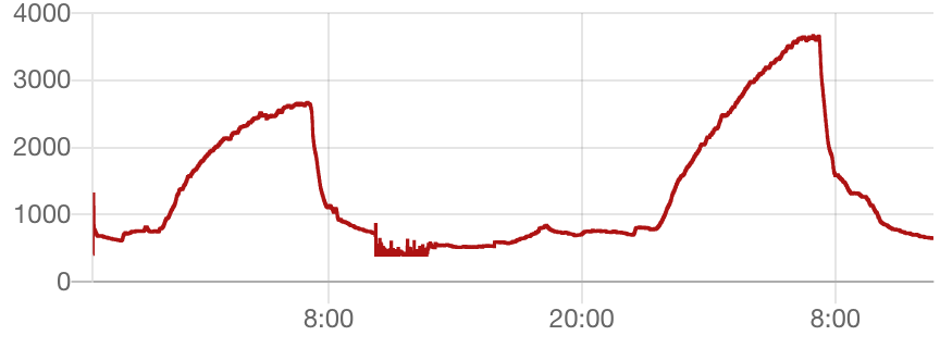

joth Posted February 4, 2020 Posted February 4, 2020 (edited) 23 hours ago, Ed Davies said: I've said it before on here but I'm a bit sceptical about those MH-Z19s as they calibrate by assuming that the CO₂ will go down to 400 ppmv at regular intervals. I'm not sure that assumption is sound. I just noticed Home Assistant has an action to trigger a calibration cycle: mhz19.calibrate_zero Action My idea is to hook this up to the MVHR so it does a (weekly? monthly?) 20min highest level boost and run the calibration then. It might also work to do it opportunistically when other events trigger boost, but they tend to involve humidity changes so may not be the best time to do it (per @SteamyTea above) and also needs interlocking to ensure the boost remains on for 20+ mins. In the meantime (i.e. before we have MVHR) it's a case of open all the windows up on a windy day, and press the calibrate button. btw most these sensors seems to have accuracy in the 50+ ppm range, so the gradual rise of global CO2 levels is not going to seriously impact their performance until we have much bigger things to worry about. Edited February 4, 2020 by joth
joth Posted February 5, 2020 Posted February 5, 2020 On 04/02/2020 at 10:23, joth said: I just noticed Home Assistant has an action to trigger a calibration cycle: mhz19.calibrate_zero Action My idea is to hook this up to the MVHR so it does a (weekly? monthly?) 20min highest level boost and run the calibration then. It might also work to do it opportunistically when other events trigger boost, but they tend to involve humidity changes so may not be the best time to do it (per @SteamyTea above) and also needs interlocking to ensure the boost remains on for 20+ mins. Hmmmmmmmm not sure this will be worth all the bother really. I ran the calibration cycle with all windows open yesterday morning, and overnight the numbers were even more whacky post-calibration, over 3600ppm. Again I'll let this run for a few more days and see if it settles. Also it might well be a duff unit / QC reject I suppose. Eitherway I think I've had a fun mini-project proving @Ed Davies's point. 1

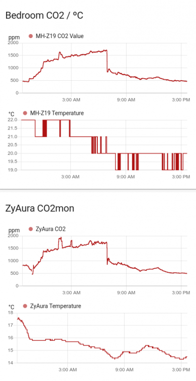

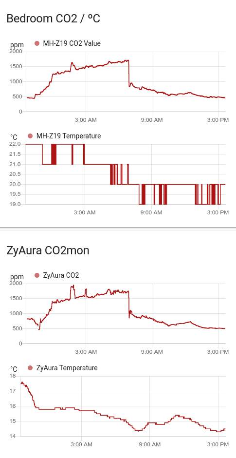

joth Posted February 11, 2020 Posted February 11, 2020 (edited) Small update: Last night I managed to retrofit an ESP-01 into a ZyAura ZGm053U sensor, and that's been running overnight. The initial numbers show it is pleasingly close to the MH-Z19B, which is good as if they were wildly out I'd really be needing to buy that third CO2 meter from @Jeremy Harris to cast the deciding vote between them! I t definitely helps that after a week (and 2 calibration cycles) the MH-Z19 has settled down to far more convincing readings. Not just in terms of zero offset, but the max readings are generally half what they were (1000-1500 overnight, rather than 3000+) Interestingly it does confirm what I already know - that it's actually the Temperature reading that's much further out of whack with the MH-Z19 -- consistently over-reading by 5°C. (The MH-Z19 is only reporting to 0 decimal places anyway, so not a very useful or pleasing graph at the best of times) (aside: at 6.30am I got up and rode the stationary trainer bike in the room next door -- you can actually make out a dip and then peak of CO2 from that excursion on both sensors.) The hack to get an ESP-01 into the ZyAura is a work of art in its own right; I'll post a photo and details when I've tidied it up a bit. Also, I'm finding ESPHome a continuing delight to tinker with like this. Edited February 11, 2020 by joth 1
