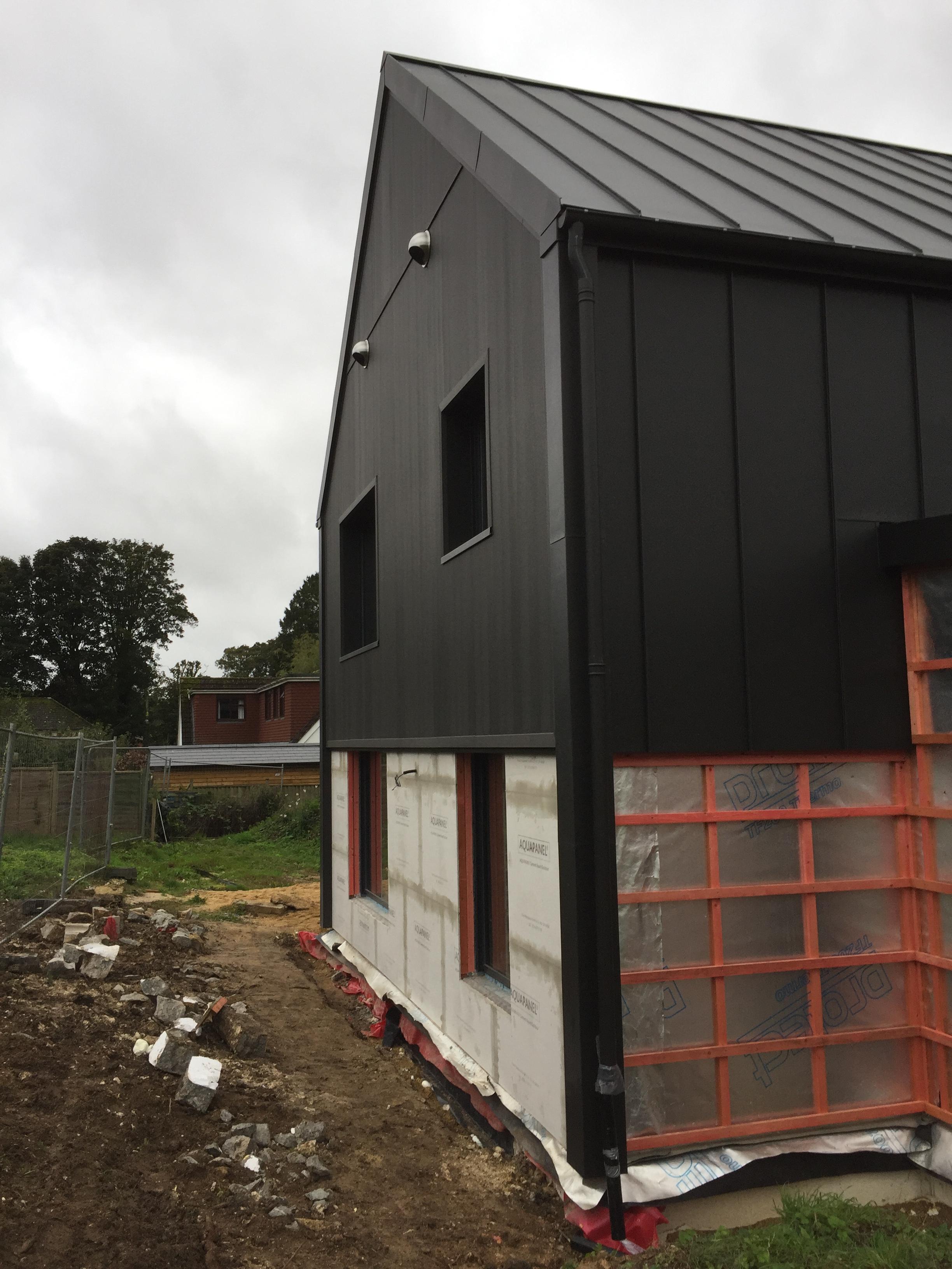

Russdl Posted November 9, 2019 Share Posted November 9, 2019 (edited) It's not 'burnt' and it's not exactly 'wood' but we've used a wood/plastic composite cladding from Envirobuild. It's not far off being black and, we think, looks pretty sharp. It's also a good 'wood' imposter. Edited November 9, 2019 by Russdl 2 Link to comment Share on other sites More sharing options...
DarrenA Posted November 9, 2019 Author Share Posted November 9, 2019 31 minutes ago, Russdl said: It's not 'burnt' and it's not exactly 'wood' but we've used a wood/plastic composite cladding from Envirobuild. It's not far off being black and, we think, looks pretty sharp. It's also a good 'wood' imposter. It looks great, I assume it is holding up well? My main criteria is something that looks sharp and keeps its looks maintenance free. Link to comment Share on other sites More sharing options...

Russdl Posted November 9, 2019 Share Posted November 9, 2019 9 minutes ago, DarrenA said: It looks great, I assume it is holding up well? Well, it's very early days yet as it's only been up around 2 months. It should be virtually maintenance free and stay looking sharp for umpteen years. I'll have to let you know in umpteen years if that is indeed the case. Link to comment Share on other sites More sharing options...
