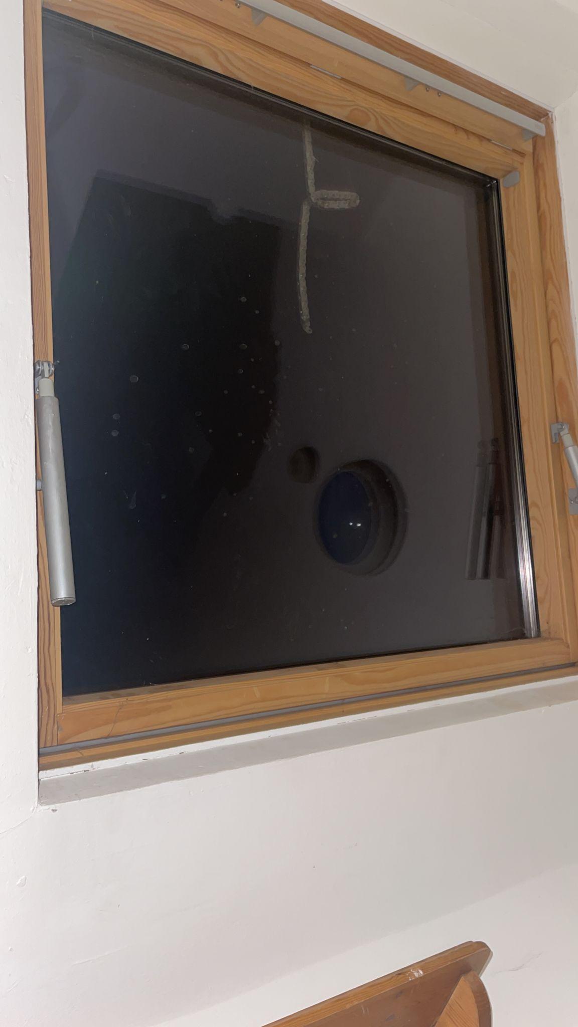

suiko Posted September 7, 2022 Posted September 7, 2022 I've got a similar issue with a velux window connected to a smoke alarm. The window was forced some years ago and since then it hasn't opened. Now - for some reason! - it has suddenly decided to make a constant and really annoying noise. Basically I don't care whether it's linked to the smoke alarm - what I really want is to stop the noise. If the window could open it would be better, but not strictly necessary - the noise is the priority! No one seems to want to come and look at it, neither fire alarm guys nor velux installers. Much buck passing is going on! Any ideas?

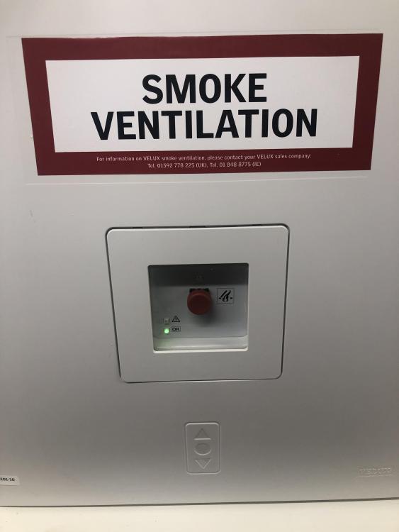

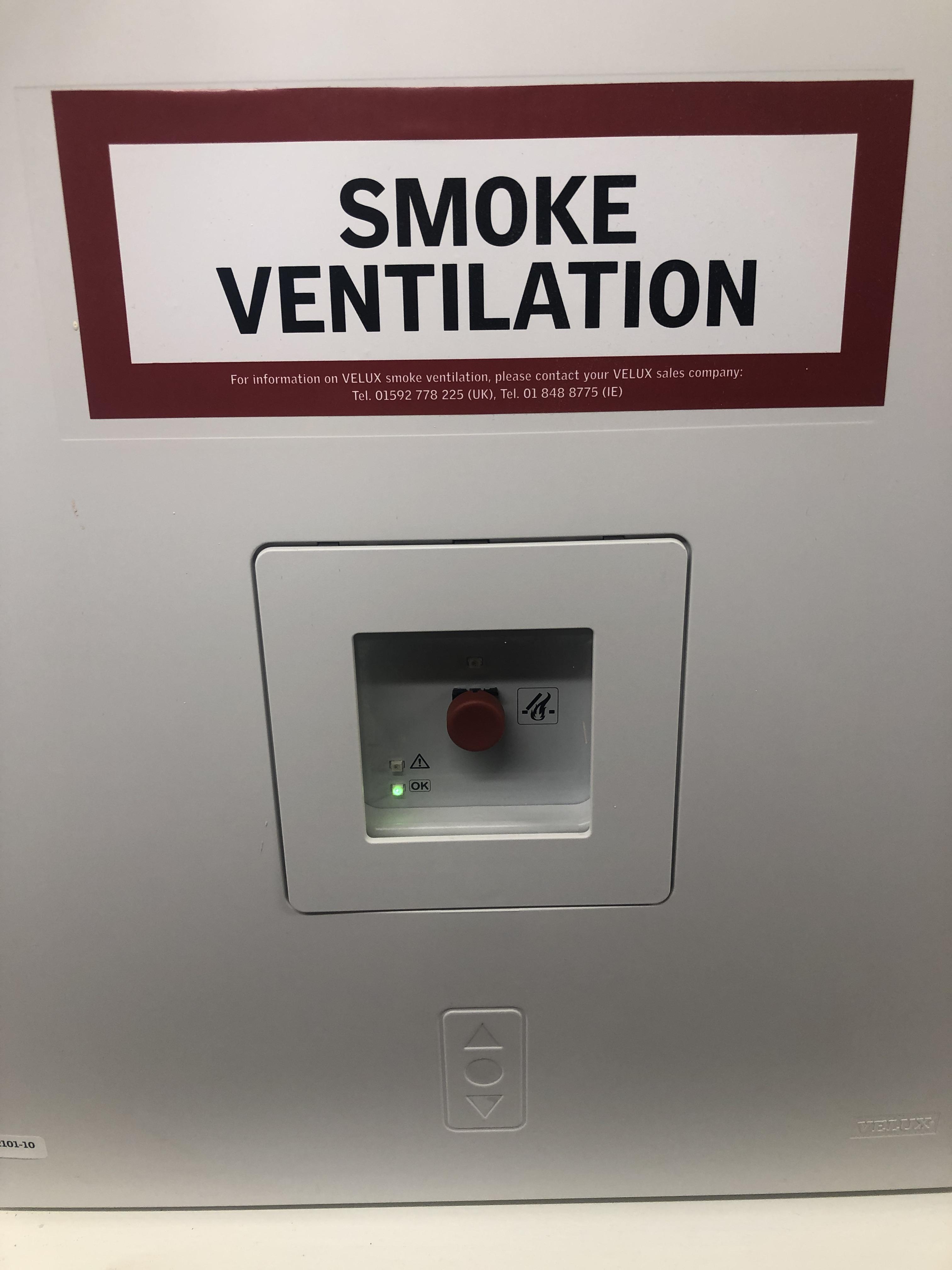

AliG Posted September 7, 2022 Author Posted September 7, 2022 There should be a box with up and down arrows to open and close the window. If it is a smoke vent it should be electrically actuated. Maybe using this to move it would fix it. What kind of noise are we talking about? 1
suiko Posted September 8, 2022 Posted September 8, 2022 16 hours ago, AliG said: There should be a box with up and down arrows to open and close the window. If it is a smoke vent it should be electrically actuated. Maybe using this to move it would fix it. What kind of noise are we talking about? Thanks - it's a constant kind of whiny noise. I've got a similar issue with a velux window connected to a smoke alarm. The window was forced some years ago and since then it hasn't opened. Now - for some reason! - it has suddenly decided to make a constant and really annoying noise. Basically I don't care whether it's linked to the smoke alarm - what I really want is to stop the noise. If the window could open it would be better, but not strictly necessary - the noise is the priority! No one seems to want to come and look at it, neither fire alarm guys nor velux installers. Much buck passing is going on! Any ideas?
AliG Posted September 8, 2022 Author Posted September 8, 2022 The whiny noise sounds like it might be a motor trying to open or close it, but it is jammed. There should be a control box like the one I have shown that operates the window. If you find that you might be able to switch it off or reset it in some way to stop the noise, or is it only connected to the smoke alarm? Even then it should have a power supply somewhere.You might be able to switch it off at your consumer unit. Now as to whether you want to switch off your smoke window, that is another mater, but I suspect it is not working anyway.
