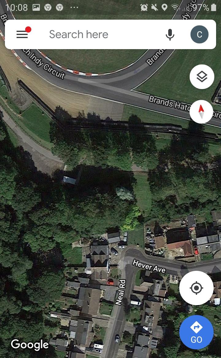

Onoff Posted November 1, 2019 Share Posted November 1, 2019 The road I grew up in flooded a while back, well at least the bottom end with a few houses inundated. As I understand a few had had cavity wall insulation of some type and it's soaked up the water leading to long term damp issues. https://www.google.com/amp/s/www.kentonline.co.uk/dartford/news/amp/woman-and-dog-trapped-in-waist-height-flooding-206362/ The bottom of the road ends at a fence then just the other side is a huge earth bank forming part of Brands Hatch racing circuit. As a kid when it flooded years ago we took an inflatable raft over the fence and dinghied over to where a circuit Landrover was submerged and we stood on it's roof. Got a right rollicking when we got back home as of course all the sewers had overflowed too. One of the flooded neighbours (we were a tad higher luckily) actually drove his speedboat around where Neal Road meets Hever Avenue. Link to comment Share on other sites More sharing options...

Onoff Posted November 1, 2019 Author Share Posted November 1, 2019 (edited) 4 hours ago, Ferdinand said: Ambiguous headline: "West Kingsdown pensioner caught in flooding up to her waist" Does that mean that the flood suddenly appeared and she was waist deep, which is implicit, or that she was on a higher something and trapped in by waist deep water? Shades of Dr Foster... I can assure you its correct as my parents and other neighbours were awoken by the emergency services. The flood happened when people were in bed. My parents stayed dry but the next door neigbour had the manhole on his lawn lift and the lawn covered with sewage. The road is on a slope with the majority of houses semi detached. Each pair is in effect built on it's own terrace, the next pair are lower as you go down the road. Theres a 2' drop between my parents and their neighbour and so it goes on. At the bottom of the road there's a pair of semis of different design and one detached. These are the ones that generally get really badly hit. Mad in some ways as it's one of the highest spots in Kent! Edited November 1, 2019 by Onoff Link to comment Share on other sites More sharing options...
