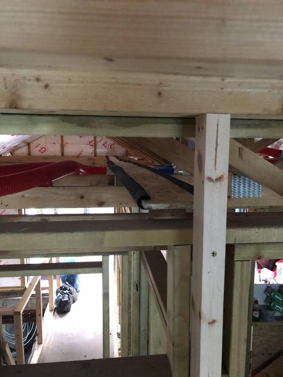

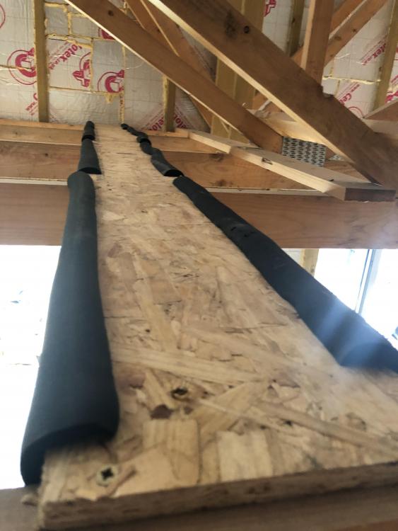

Pocster Posted October 22, 2019 Author Share Posted October 22, 2019 So is this mockup wrong ? Couldn’t find any cable on site for love nor money ; typically ! . Improvised with a broom ?. Did find by luck some ‘banding’ - once I saw @Nickfromwales link I knew what we were talking about . Link to comment Share on other sites More sharing options...
Jeremy Harris Posted October 22, 2019 Share Posted October 22, 2019 48 minutes ago, pocster said: Yeah so I am correct . I just use the metal straps to fix cables to the timber ? @Nickfromwales says there’s more to it than that though . You should keep data and power cables well separated, but that's really the only restriction, other than the previously mentioned one of fire resistance of cable clips and supports. Personally I like to make sure cables are clipped to a batten or board, in a location where they aren't likely to get damaged and also where they can be seen easily for inspection, etc. Doing this in neat lines also makes it easier to identify circuits later if there's a need to change anything. There's also a max spacing between cable fixings in the regs, plus I'd not use potentially sharp edged banding as cable clips. 1 Link to comment Share on other sites More sharing options...
Triassic Posted October 22, 2019 Share Posted October 22, 2019 But! All my wiring is behind plasterboard, I’m not bothered if it sags during a fire! The house would be foobared anyway. Link to comment Share on other sites More sharing options...
Jeremy Harris Posted October 22, 2019 Share Posted October 22, 2019 Just now, Triassic said: But! All my wiring is behind plasterboard, I’m not bothered if it sags during a fire! The house would be foobared anyway. The drooping wiring bit in the regs is because firefighters have been trapped in burning buildings by the maze of wire that has dropped down, rather like a net. Doesn't matter if the house is "foobared", as the purpose of the regulation is to save the lives of firefighters, who may well have to enter a building in order to try and rescue someone that's trapped. Link to comment Share on other sites More sharing options...
Pocster Posted October 22, 2019 Author Share Posted October 22, 2019 1 hour ago, JSHarris said: You should keep data and power cables well separated, but that's really the only restriction, other than the previously mentioned one of fire resistance of cable clips and supports. Personally I like to make sure cables are clipped to a batten or board, in a location where they aren't likely to get damaged and also where they can be seen easily for inspection, etc. Doing this in neat lines also makes it easier to identify circuits later if there's a need to change anything. There's also a max spacing between cable fixings in the regs, plus I'd not use potentially sharp edged banding as cable clips. Was going to keep mains separate anyway. So for my cat6 this method is acceptable? Link to comment Share on other sites More sharing options...
Jeremy Harris Posted October 22, 2019 Share Posted October 22, 2019 If it were me, then I'd run the data cable in trunking, with the trunking secured with fire resistant clips.. Take a look at something like the D Line trunking system, as they include fire rated clips. Makes the installation a fair bit easier if you're just feeding cables into trunking. Trunking: https://www.tlc-direct.co.uk/Main_Index/Trunking_Pvc_Index/index.html D Line fire rated clips: https://www.tlc-direct.co.uk/Main_Index/Trunking_Pvc_Index/Dline_SD_CLIPS/index.html More details from D Line: https://www.d-line-it.com/safed-clips/ 1 Link to comment Share on other sites More sharing options...
Pocster Posted October 22, 2019 Author Share Posted October 22, 2019 22 minutes ago, JSHarris said: If it were me, then I'd run the data cable in trunking, with the trunking secured with fire resistant clips.. Take a look at something like the D Line trunking system, as they include fire rated clips. Makes the installation a fair bit easier if you're just feeding cables into trunking. Trunking: https://www.tlc-direct.co.uk/Main_Index/Trunking_Pvc_Index/index.html D Line fire rated clips: https://www.tlc-direct.co.uk/Main_Index/Trunking_Pvc_Index/Dline_SD_CLIPS/index.html More details from D Line: https://www.d-line-it.com/safed-clips/ Yeah seems good . Some of the metal cable trays are a bit cheaper though . Link to comment Share on other sites More sharing options...
Jeremy Harris Posted October 22, 2019 Share Posted October 22, 2019 4 minutes ago, pocster said: Yeah seems good . Some of the metal cable trays are a bit cheaper though . Remember to factor in metal brackets/supports for the cable trays, though. PVC trunking can just be screwed to timber or walls directly, using metal clips to give the fire resistant support needed for the cables. Link to comment Share on other sites More sharing options...
Pocster Posted October 22, 2019 Author Share Posted October 22, 2019 6 minutes ago, JSHarris said: Remember to factor in metal brackets/supports for the cable trays, though. PVC trunking can just be screwed to timber or walls directly, using metal clips to give the fire resistant support needed for the cables. True . Link to comment Share on other sites More sharing options...

Pocster Posted October 22, 2019 Author Share Posted October 22, 2019 (edited) Another dumb question . As this is all for safety regs how can a pvc conduit be ok ? Metal clips attach it to the timber but during a fire would it not just collapse regardless of the cables in it ? I.e melt Edited October 22, 2019 by pocster Link to comment Share on other sites More sharing options...
Jeremy Harris Posted October 22, 2019 Share Posted October 22, 2019 1 minute ago, pocster said: Another dumb question . As this is all for safety regs how can a pvc conduit be ok ? Metal clips attach it to the timber but during a fire would it not just collapse regardless of the cables in it ? I.e melt As long as the metal fire clips are used PVC trunking is fine. The advantage of the trunking is that it's a easy to just lay cables inside the stuff with the lid off. Means you can go back and forth with additional cables, then secure the lot when you're finished by bending the metal clips over and clipping on the lid to make things tidy and provide additional protection to the cables. Link to comment Share on other sites More sharing options...
Pocster Posted October 22, 2019 Author Share Posted October 22, 2019 11 minutes ago, JSHarris said: As long as the metal fire clips are used PVC trunking is fine. The advantage of the trunking is that it's a easy to just lay cables inside the stuff with the lid off. Means you can go back and forth with additional cables, then secure the lot when you're finished by bending the metal clips over and clipping on the lid to make things tidy and provide additional protection to the cables. That sounds far easier for me as I need to add as I go and undoubtedly will forget a cable for something. Still don’t get how it can be ok in a fire situation- surely pvc would just melt - then it’s dripping molten plastic and cables falling ???? ? Link to comment Share on other sites More sharing options...
Jeremy Harris Posted October 22, 2019 Share Posted October 22, 2019 3 minutes ago, pocster said: Still don’t get how it can be ok in a fire situation- surely pvc would just melt - then it’s dripping molten plastic and cables falling ???? ? The metal fire clips stop the cables from falling. Before the changes to the regs, PVC trunking on it's own was fine for most applications, after the changes you just need to add the metal fire clips when fixing the trunking in place, so these can hold the cables up when the trunking melts. 1 Link to comment Share on other sites More sharing options...
Pocster Posted October 22, 2019 Author Share Posted October 22, 2019 2 minutes ago, JSHarris said: The metal fire clips stop the cables from falling. Before the changes to the regs, PVC trunking on it's own was fine for most applications, after the changes you just need to add the metal fire clips when fixing the trunking in place, so these can hold the cables up when the trunking melts. Ok ! . Still sounds like not much fun for the fireman . So pvc trunking with the metal clips . I presume there’s a rule on minimum clip spacing ? Link to comment Share on other sites More sharing options...
Jeremy Harris Posted October 22, 2019 Share Posted October 22, 2019 5 minutes ago, pocster said: Ok ! . Still sounds like not much fun for the fireman . So pvc trunking with the metal clips . I presume there’s a rule on minimum clip spacing ? The regs just say this, so not much help! : Quote 521 .10.202 Wiring systems shall be supported such that they will not be liable to premature collapse in the event of a fire. NOTE 1: Wiring systems hanging across access or egress routes may hinder evacuation and firefighting activities. NOTE 2: Cables installed in or on steel cable containment systems are deemed to meet the requirements of this regulation. NOTE 3: This regulation precludes, for example, the use of non-metallic cable clips or cable ties as the sole means of support where cables are clipped direct to exposed surfaces or suspended under cable tray, and the use of non-metallic cable trunking as the sole means of support of the cables therein. NOTE 4: Suitably spaced steel or copper clips, saddles or ties are examples that will meet the requirements of this regulation. The intention is to prevent cables being able to droop down and cause a snagging hazard for firefighters, so I'd guess that fitting clips every 300 to 500mm or so in trunking is probably OK. 1 Link to comment Share on other sites More sharing options...
Pocster Posted October 22, 2019 Author Share Posted October 22, 2019 Just now, JSHarris said: The regs just say this, so not much help! : The intention is to prevent cables being able to droop down and cause a snagging hazard for firefighters, so I'd guess that fitting clips every 300 to 500mm or so in trunking is probably OK. Ok - that sounds reasonable. But do I have to trunk right to the end spot ? . Say I have a humidity sensor I wish to place in a ceiling - do I have to trunk directly where I think I want it ? . If when I test the sensor I need to move it ; I re adjust that trunking ? . I guess I’m asking is there any Lea way for the cable going from trunking to device ? Link to comment Share on other sites More sharing options...
