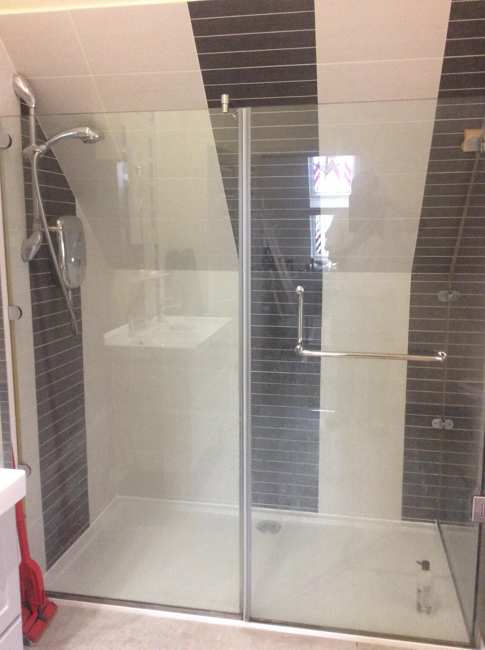

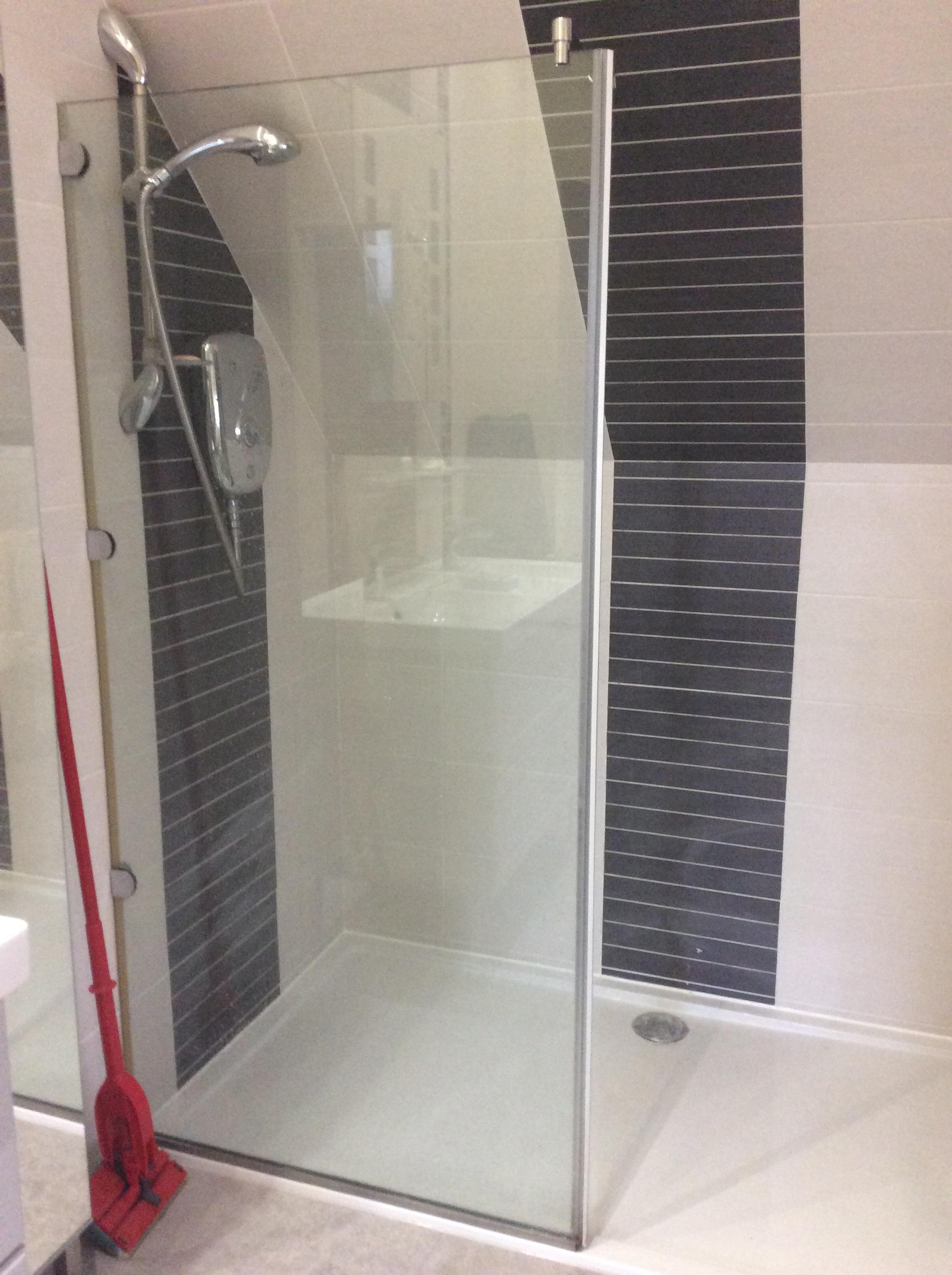

Jeremy Harris Posted October 13, 2019 Share Posted October 13, 2019 I fitted a 2000 x 900 tray, with a fixed glass screen. The screen just sits on the tray edge with a bit of clear sealant: 1 Link to comment Share on other sites More sharing options...
Pocster Posted October 13, 2019 Author Share Posted October 13, 2019 3 minutes ago, JSHarris said: I fitted a 2000 x 900 tray, with a fixed glass screen. The screen just sits on the tray edge with a bit of clear sealant: That’s smart . More and more tempted to just get that gorgeous black tray . It’s only 30mm deep so I could set it slightly lower - like only 10mm above finished floor . I’ll put a drawing up tomorrow to show what i’m Thinking ..... ? Link to comment Share on other sites More sharing options...

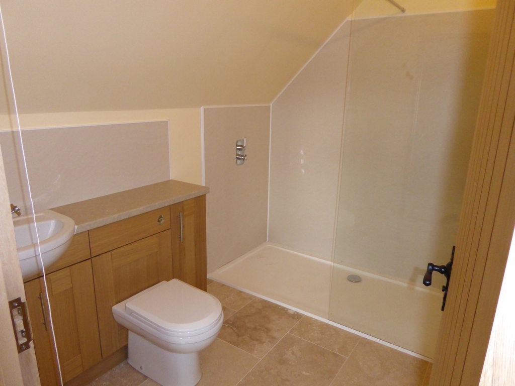

Nickfromwales Posted October 13, 2019 Share Posted October 13, 2019 One piece is always best, and there are some nice ones out there nowadays with plenty of colours / finishes etc to choose from. Fiora was the make of the last one I fitted. 1 Link to comment Share on other sites More sharing options...

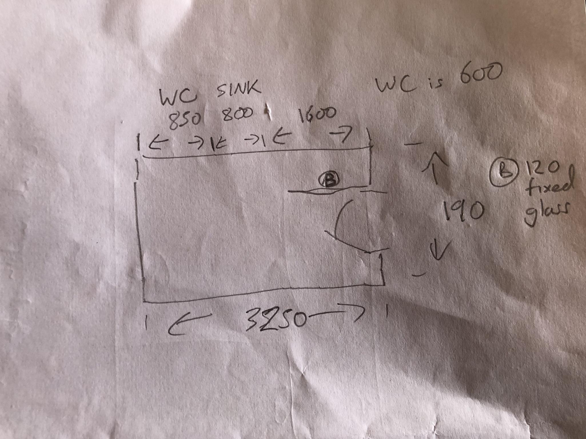

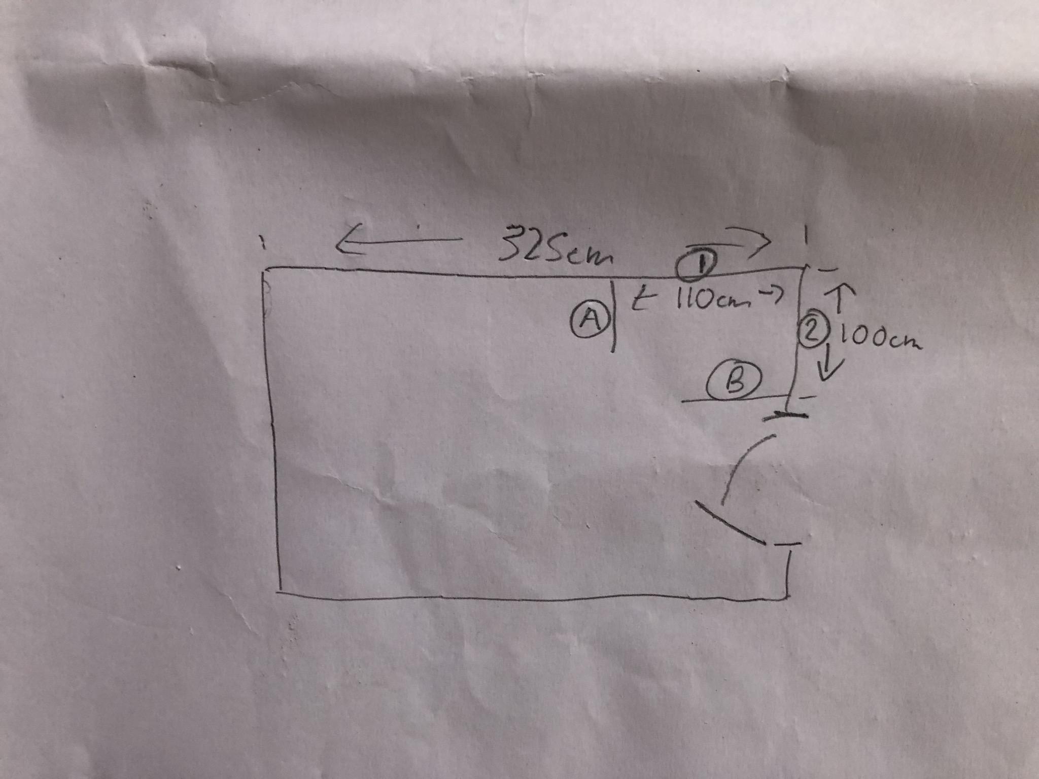

Pocster Posted October 14, 2019 Author Share Posted October 14, 2019 (edited) So ! Forgive crude drawing . My question is with just fixed shower glazing what length should B and more importantly A be to prevent splashing ? Intending a rainfall ceiling mounted shower but also boss wants a standard shower on a vertical rail - I assume it’s best to mount that on wall 1 ?? Edited October 14, 2019 by pocster Link to comment Share on other sites More sharing options...
Jeremy Harris Posted October 14, 2019 Share Posted October 14, 2019 3 minutes ago, pocster said: My question is with just fixed shower glazing what length should B and more importantly A be to prevent splashing ? Our screen is 900mm wide and I wish it was 100mm wider. Splashing only happens around the first 100mm past the end of the glass panel. I went for a 900mm wide panel to maximise the entry space, but in reality a 1000mm panel would have been fine. 1 Link to comment Share on other sites More sharing options...
Nickfromwales Posted October 14, 2019 Share Posted October 14, 2019 B = min 1000mm A = Moot, as it isn't stopping all of the water. 300mm fixed panel would stop water getting at the corner of the floor / tray junction. In honesty, this is too small a tray to be open. Minimum tray size for 'open ended' is 1600mm AFAIC, but 1800-2000mm better. Plus then you wont need the A panel. 1 Link to comment Share on other sites More sharing options...
Pocster Posted October 14, 2019 Author Share Posted October 14, 2019 10 minutes ago, Nickfromwales said: B = min 1000mm A = Moot, as it isn't stopping all of the water. 300mm fixed panel would stop water getting at the corner of the floor / tray junction. In honesty, this is too small a tray to be open. Minimum tray size for 'open ended' is 1600mm AFAIC, but 1800-2000mm better. Plus then you wont need the A panel. Yeah I can’t go any longer as sink and WC on that wall also . B at a min of 1000 not an issue ( could be 1200 ) . A 300 not an issue . Erm ; was planning an ‘open’ shower - not sure what to do now ? Link to comment Share on other sites More sharing options...
Ferdinand Posted October 14, 2019 Share Posted October 14, 2019 (edited) The two I have fitted recently have B as 900-950mm, but longer trays and full screens on the end. The latestalso has a 20mm upstand. Had a chat to the fitter at subfloor level, and I wanted it to be minimal and water retaining but not flat, and wheelchairable. You can always take 5mm off by using more screed or glue, but not add it back on. This tray is 900 x 1800. The sloping roof also means my shower is positioned so that spray would stay in with no door. I will probably remove that door and cap the screen end as I think I will not find a magnetic door seal easily. You could make A into a shower curtain or a hinged or multifold screen. Edited October 14, 2019 by Ferdinand 1 Link to comment Share on other sites More sharing options...
