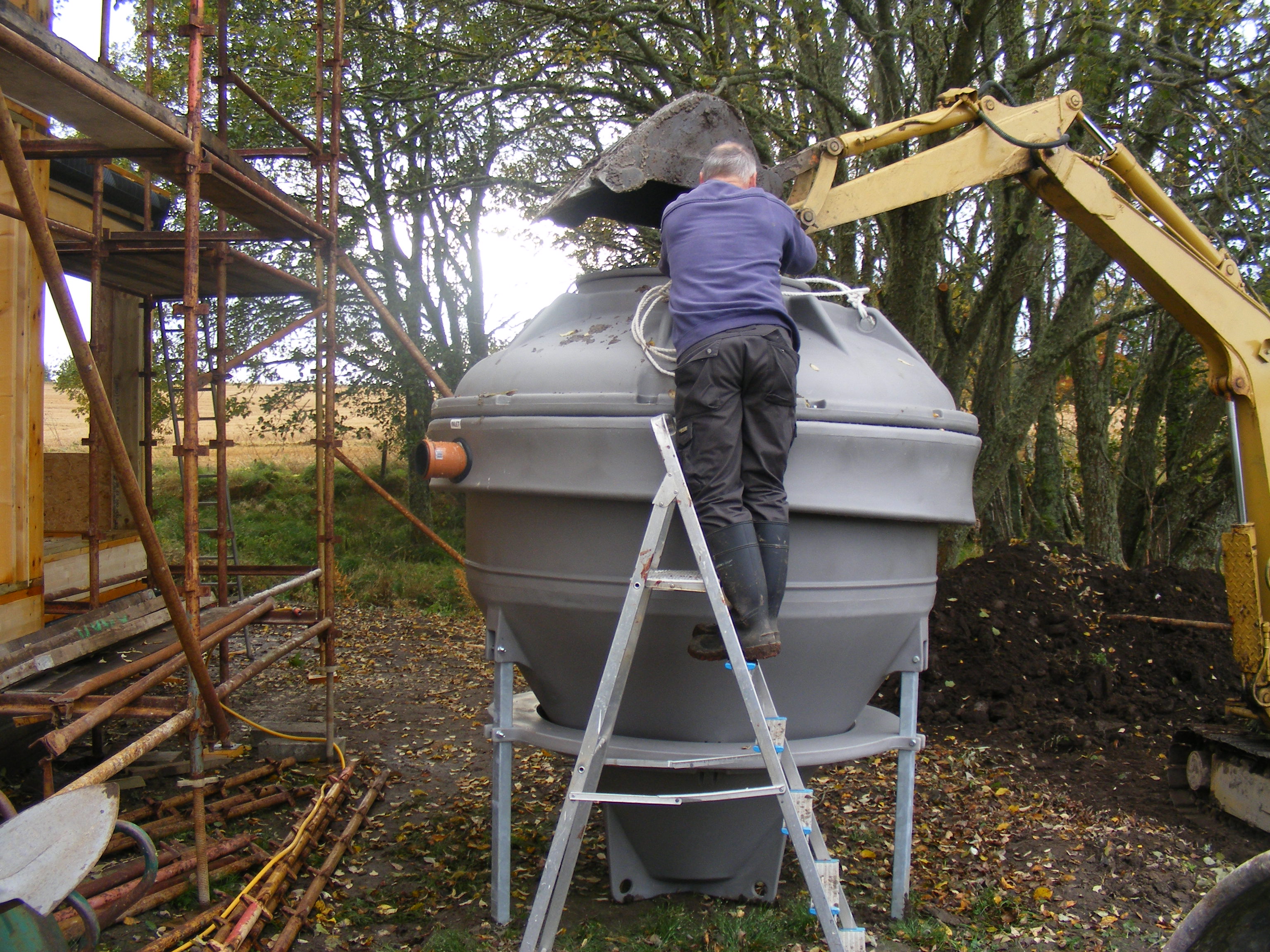

I recall Jeremy was looking into the option of sourcing a 12V air blower pump to replacer the mains driven one as standard. That would make it a lot more viable to power by it's own solar panel and battery (with a mains charger to turn on if there was not enough solar generation)
I don't know the outcome of his research.
Don't forget to look at the Conder as well (that's the one we have) The Conder, Vortex and Biopure all appear to be the best 3 treatment plants in terms of effluent quality that I could find when I was looking and all work on the aeration by an air blower principle.
Thanks everyone.
Dave, I must say the Conder ASP08 looks interesting, I like the fact that it has support legs which will make it easier to level the tank when installing. They also do a version with inbuilt effluent pump which is something we might well need.
It was the ease of self install that swung it for me with the Conder If you are paying someone to install it then it makes little difference, but with the Biopure, it has to be held upright while you pour concrete and wait for it to set.
Just a tip, of you chose that one, the best price I could get for it was from Travis Perkins.
Mine was the ASP06 but as far as I can tell they are the same size physically but the 8 has a bigger blower pump (there may be other internal differences)
