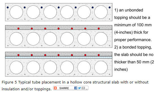

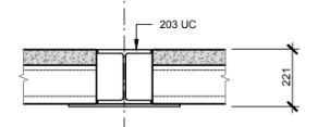

kxi Posted October 6, 2019 Author Posted October 6, 2019 Thanks all of the comments. Thinking about it today, I think there's flaw that in our case means we can't use the structural topping to lay the UFH pipe. The planks are laid on the bottom flange of asymmetric steel beams in a 'slim floor' style, in order to save height. e.g. (based on shallow-floor designs such as https://www.steelconstruction.info/Floor_systems#Shallow_floors) Since the structural topping doesn't in our case go over the top of the steel beams, the UFH pipes can't go through the beams (without complexity). However, if anyone is ever interested in UFH pipes in hollowcore topping, it does appear that it is (or at least was) tacitly supported by US and Canadian building codes: http://www.healthyheating.com/Concrete-codes-radiant-heating/Concrete-codes-radiant-heating.htm#.XZpJr0ZKhhF The middle one was what i was thinking of. @scottishjohn The ICF floor style is neat and something I would have looked into, but in our case this floor is over an agricultural-use ground floor, which could have vehicles, workshops, storage, etc in and I am very concerned about the effects of a fire down there on the house above. Any EPS in the floor soffit I would expect to last hardly any time before melting. In the EKONECT and quad-deck examples it looks like the EPS in the floor doesn't provide any structural aspect, as that's all handled by the cast/pre-cast concrete, i.e. the EPS melting might not affect overall floor integrity. I suspect had I looked into these in more detail 8 months ago, we might have made a different choice, but we are on course with the hollowcore now.
Temp Posted October 6, 2019 Posted October 6, 2019 We have a beam and block first floor that has two quite deep steel UBs to reduce the span of the concrete beams. The B&B floor rests on the lower flange just like your hollow core. The tops of the UB project above the top of the blocks. These were hidden in the insulation layer before adding UFH in screed on top.
