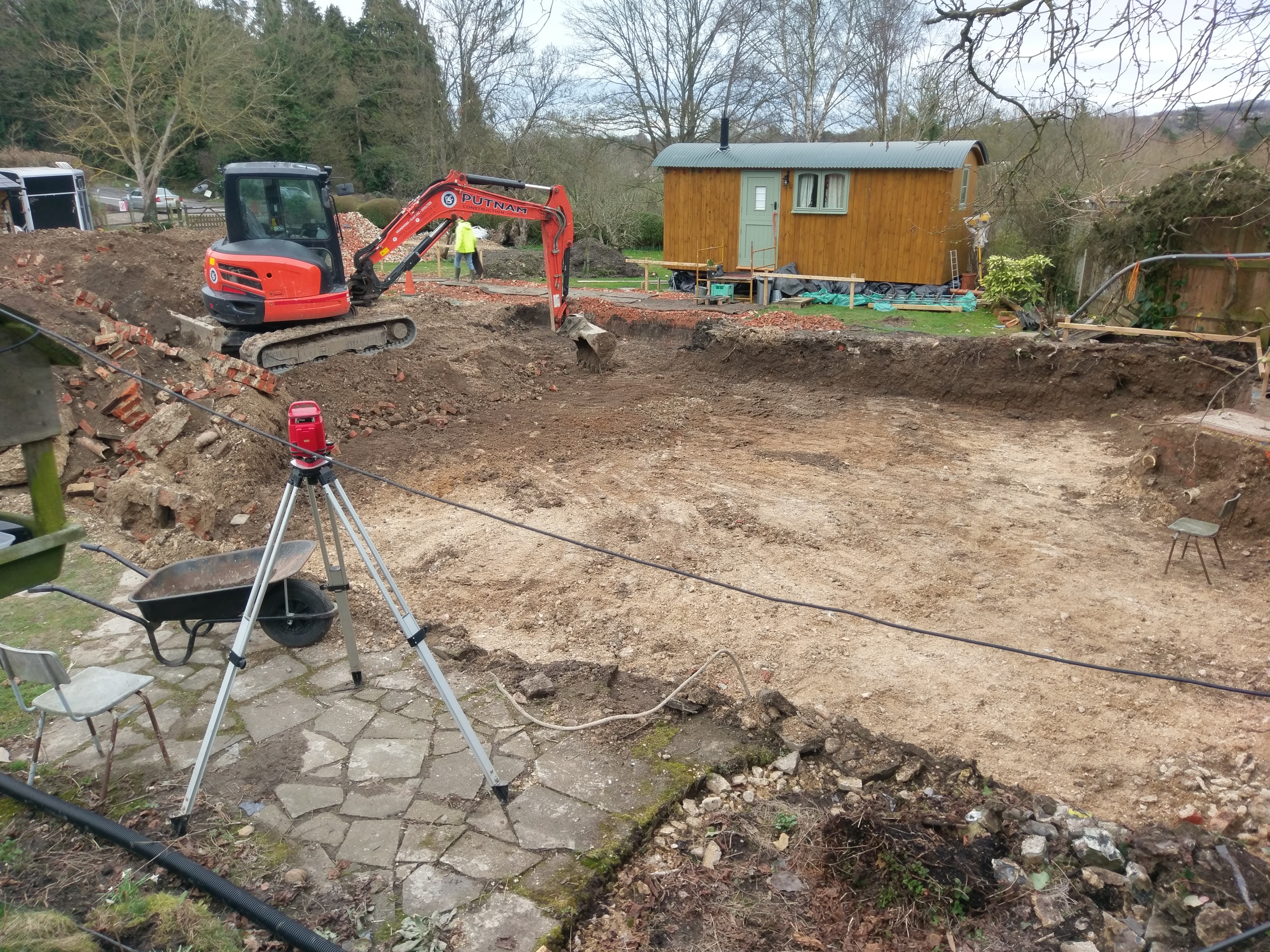

dogman Posted March 8, 2017 Author Share Posted March 8, 2017 At long last we have got going again. Due to some delays with slab design we lost our ground work team. However as is the case in building industry(apparently) i was passed from one contractor to another until one wanted the work. They turned up this morning with a five tonne machine so a bit smaller than expected but the operator is really good and has made good progress pulling out the old footings and levelling the base. Only slight issue is that the expected chalk across the site as found when we dug trial pits has become subsoil in the middle of the dig ( the dark brown stuff at the edge of the chalk) It is still very firm but Building Control have asked us to refer it back the the S.E The hole is currently 1m deep at the end nearest the camera but that will be lowered by 500mm when we finish Link to comment Share on other sites More sharing options...
