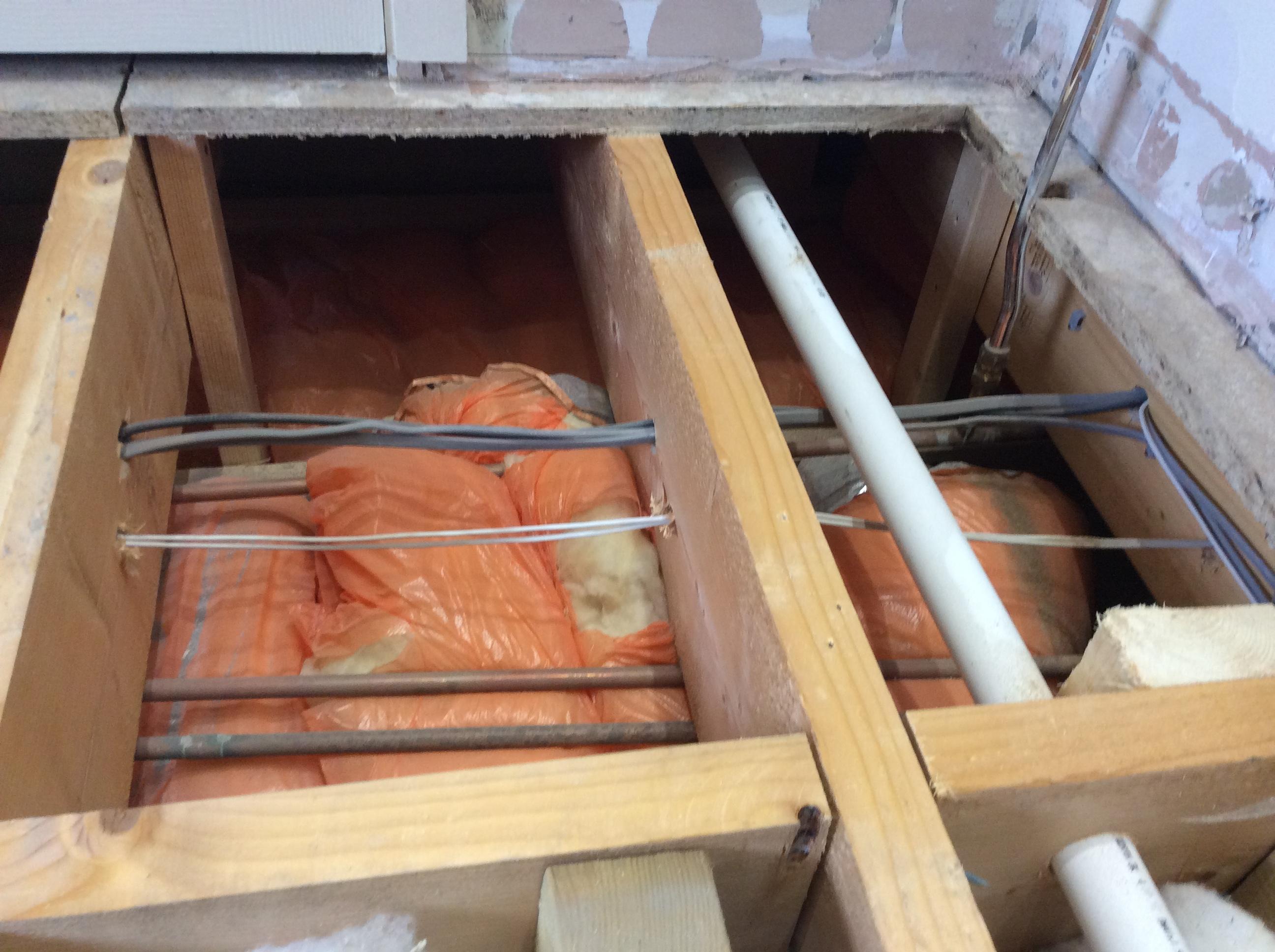

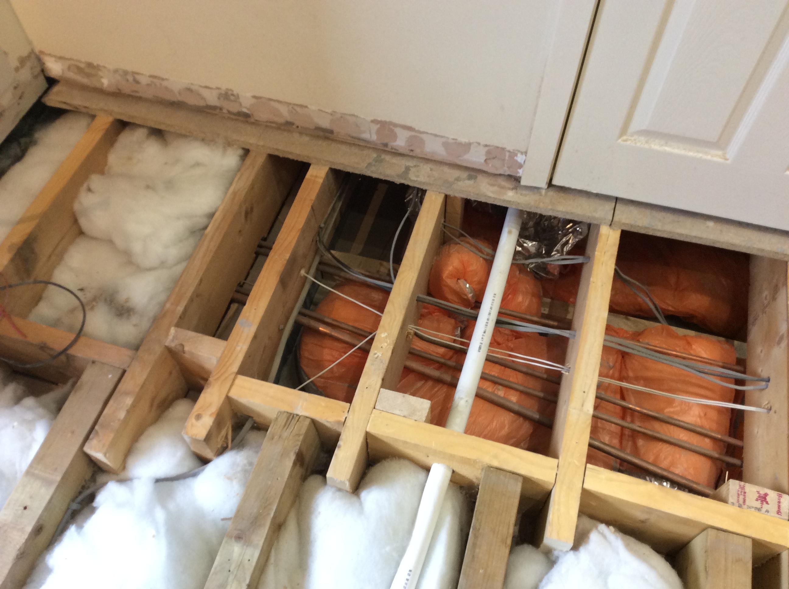

The refurbishment of my upstairs bathroom has started.
Today the filter took the floor up, and the sound insulation consists of stuff like teddy-bear stuffing, and is not fitted particularly tightly:
Does anyone know what this is, and can anyone suggest something better?
The type of noise is general plumbing noises. I appreciate that this will just tackle one mode of noise but it is a case of every little helps, and I will not be opening this up again.
I probably ave until mid morning tomorrow to source and obtain something, so it will need to be sourced locally.
I am wondering about mineral or glass wool batts, pressed in quite hard.
Al comments are most welcome me.
Cheers
Ferdinand

Not sure that this product is certified for use as an acoustic insulation. Building Regs require mineral (glass or rock) wool, min 100mm thick and min 10 kg/m3 density in this application. Other option is that the quilt manufacturer has a sound test result confirming the floor achieves 40 dB (for new build, if this a yardstick for your requirement).

The acoustic requirement for internal walls and floors (within dwellings) been in place since early 2000s. For floors the spec is as above and for stud walls basically the same but min thickness of 25mm. Not sure how that quilt will perform acoustically - BCO should have requested test data on floor and wall to show at least 40dB achieved

@Ferdinand sorry saw this late, as stated above this is polyester insulation, and is porous insulation, and will do its job for absorbing sound energy in that cavity space.
It is just a smidgen worse performing as mineral wool or glass fibre (of same thickness and density), but not enough to warrant changing it out, so i suggest just leaving it there.
what is the noise that you are trying to get rid of, water flow noise in those pipes? consider using a mass loaded pipe lagging to attenuate the noise from those pipes if that is the issue (e.g. superlag, UTUBE).

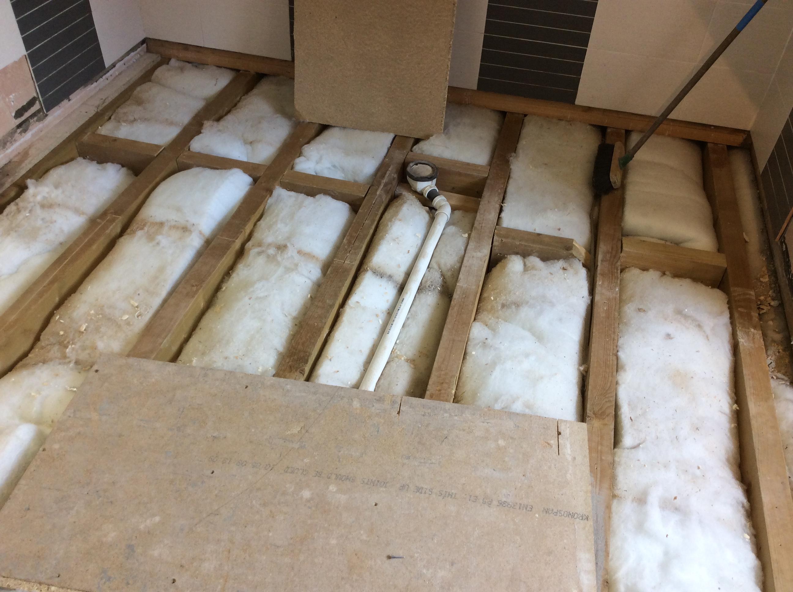

OK have resolved this.

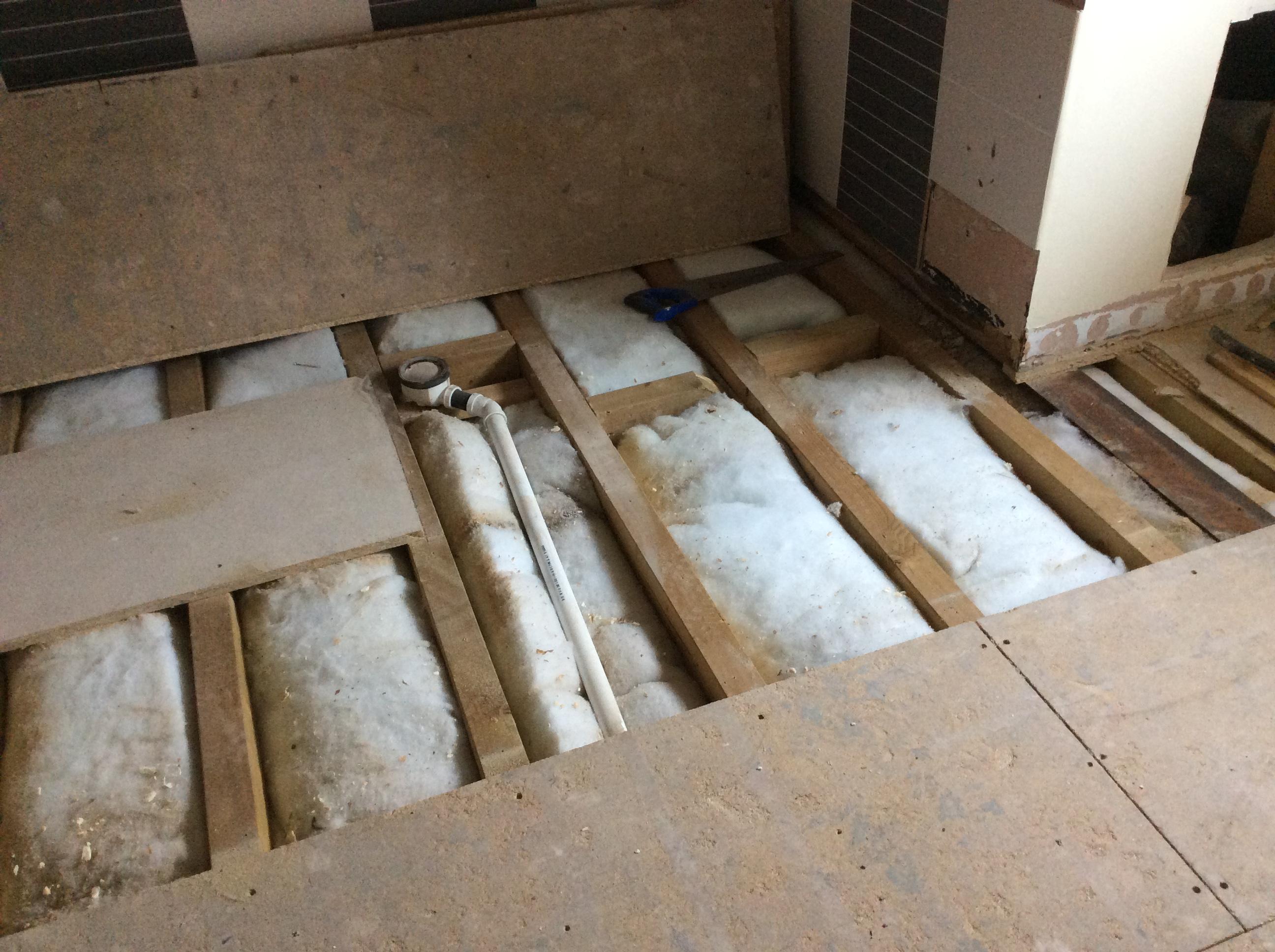

This is a self-build done by somebody before I bought it and the quality of the bathroom floor was shocking, and will need another thread.
There was a whole section with minimal insulation, and the floor build up was butted up 22mm chipboard, screed incl heating Matt, then tiles straight on top. But the joists are like the Forth bridge. In placed you can see the lounge ceiling plasterboard.
Some of the chipboard only had half a dozen screws. He also had not used flexible adhesive. Pic 2 is one of the pieces of subfloor.
A couple of piccies.
It is classic self-build later-on budget skimp as there was too little money to finish as it was started.
There Is also a huge issue here about variable build quality within one project, and how to prove it for sale later.

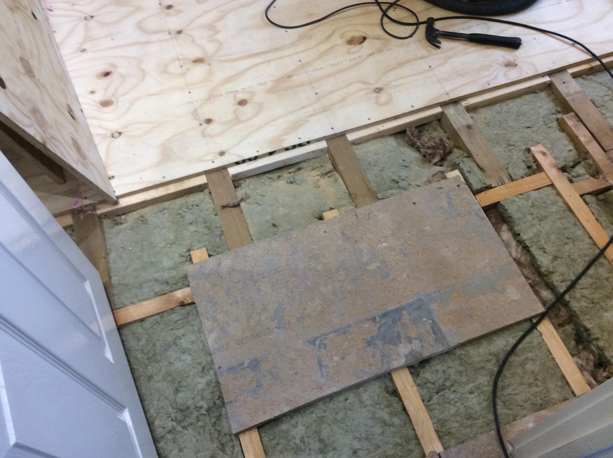

Have added a50mm layer of rock wool sound insulation, and a proper plywood subfloor screwed every 150mm, then will have tongue and groove as a base for the heating and tiles
