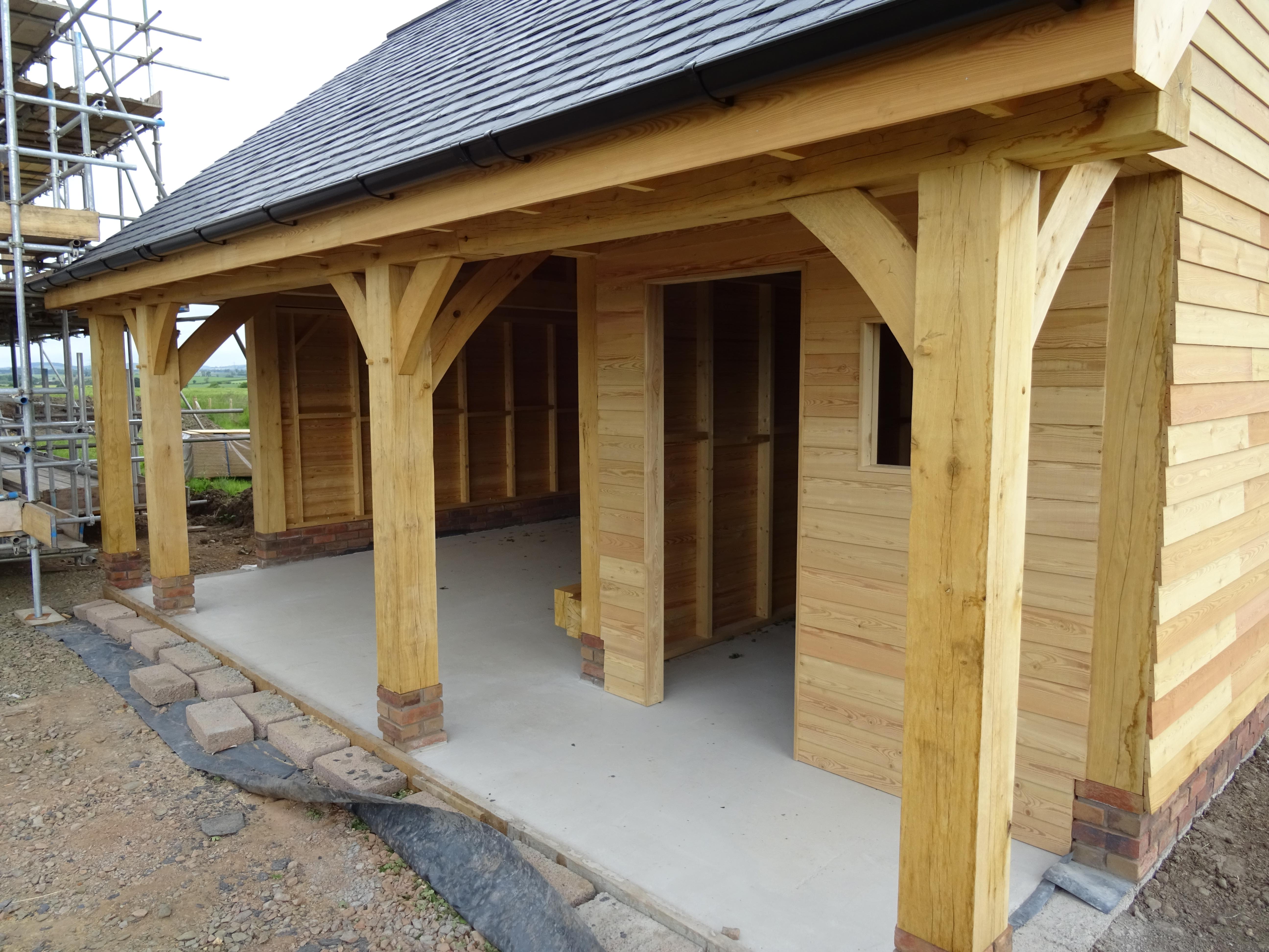

Redoctober Posted September 18, 2019 Share Posted September 18, 2019 We opted for an oak frame carport and integrated shed - cost of frame etc without roof slates and foundations came in at around £26k - no VAT payable as it was a design, supply and fit. Oak frame with larch cladding. See image - 7m wide by 6m deep. [Early 2018 prices]. Link to comment Share on other sites More sharing options...
