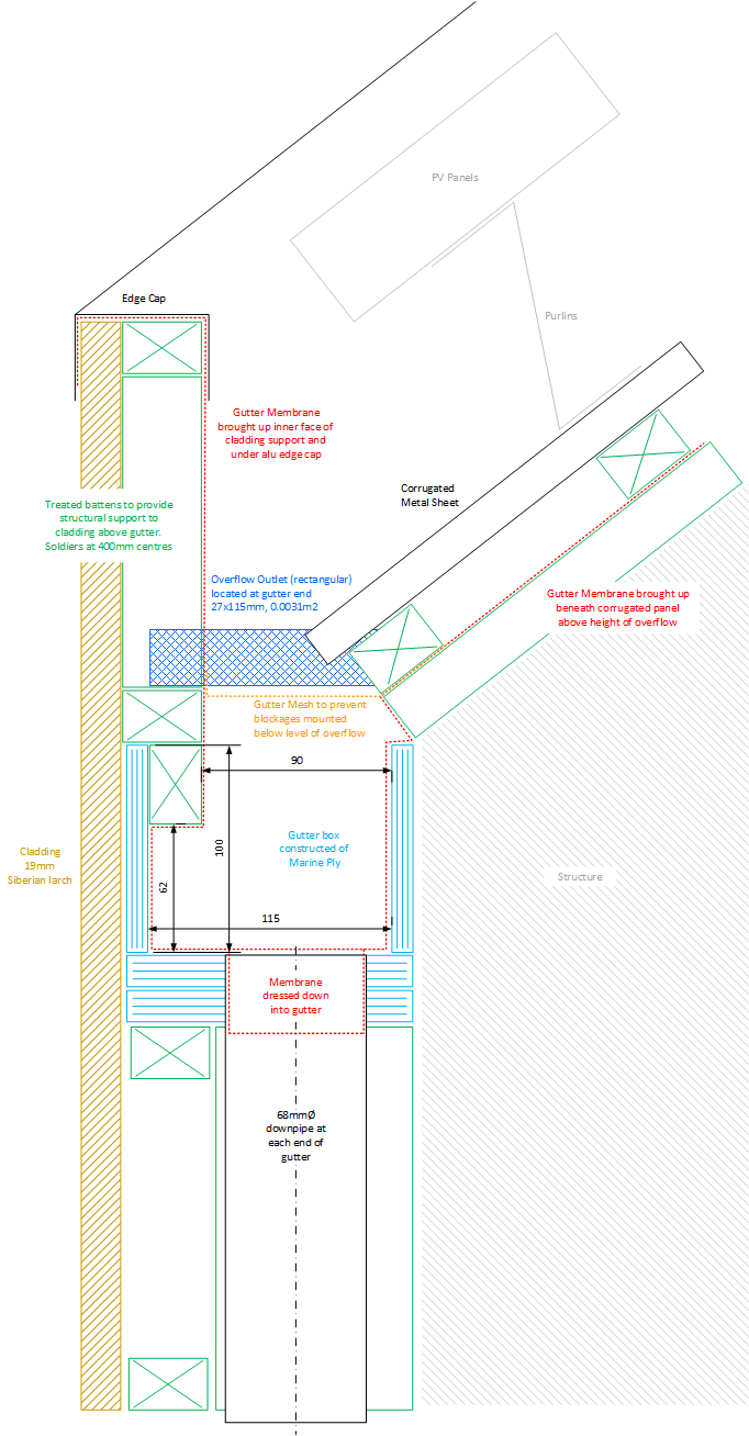

Visti Posted September 11, 2019 Posted September 11, 2019 I've looked at he H3 regs and can't find any requirements for access to clean the gutter. An issue with our design means we'll only have 30mm openning from the top between the roof and the edge. That seems like an issue to me, but nothing is stated in the regs, and there are few alternatives. Am I right to be worried?

Temp Posted September 11, 2019 Posted September 11, 2019 4 hours ago, Visti said: we'll only have 30mm openning from the top between the roof and the edge Sounds like you need to move the gutters outboard a bit? Sketch drawing might help.
Visti Posted September 12, 2019 Author Posted September 12, 2019 The gutter has turned into a bit of a bodged design. Originally the eaves of the roof terminated at the box gutter height, but as we've had to push these up at the gable ends, we've had to increace the cladding height to match. That means A structural brace behind the cladding above the box gutter is required to support the top of the cladding There is no more opportunity for overflow over the out edge of the cladding as it'd take so much water before going over that the weight would become too risky Access to the box gutter is now constricted from the top, making maintenance difficult. I like your idea @JSHarris, so may use that as a tactic. Checked with my warranty provider and they don't really care about #3 after all! A bit of mesh above would do fine to prevent stuff from getting in. #2 is the big stopper, so we're going to have to put in some overflow outlets just above the down-pipes to accommodate H3 1.7... just another day, another change!

Visti Posted September 12, 2019 Author Posted September 12, 2019 I hadn't even considered the PV run off given my focus on the roof and gutter, but that is a very good point! Thanks @JSHarris Thankfully we've brought the cladding up quite a way, but it still looks like it'd just shoot off over the edge. I may ask the question, but hesitant to unpack a new box of problems just now, hehe.

Visti Posted September 13, 2019 Author Posted September 13, 2019 21 hours ago, Vijay said: Is there anyway of fitting a course mesh to the bottom of the PV to break up the sheet of water coming off it? (so it creates an upstand) Only shallow so leaves wouldn't get backed up That should be an easier install as well I should think! I'll look at how we can build that into the counter battening before the cladding goes on. Thanks for that idea @Vijay!
