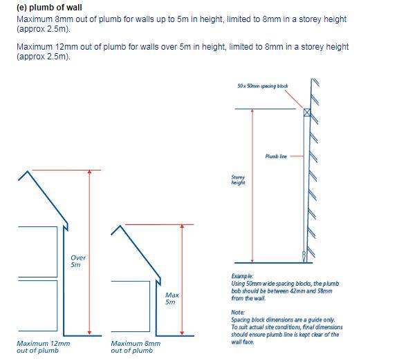

Vijay Posted September 6, 2019 Posted September 6, 2019 I've spent the last week getting my corners absolutely plumb. I suspect the corner bracing on my ICF, which was fixed to the ground may have moved as clay dried? Anyway, it made me wonder what tolerances are acceptable for wall corners? I asked a new build house and they said one of their walls was out by 30mm over 3m high :O which was done by a gang of brickies. They did go on to say they would normally find 10mm per floor (so I guess 2.5m) acceptable. What would you accept? Vijay

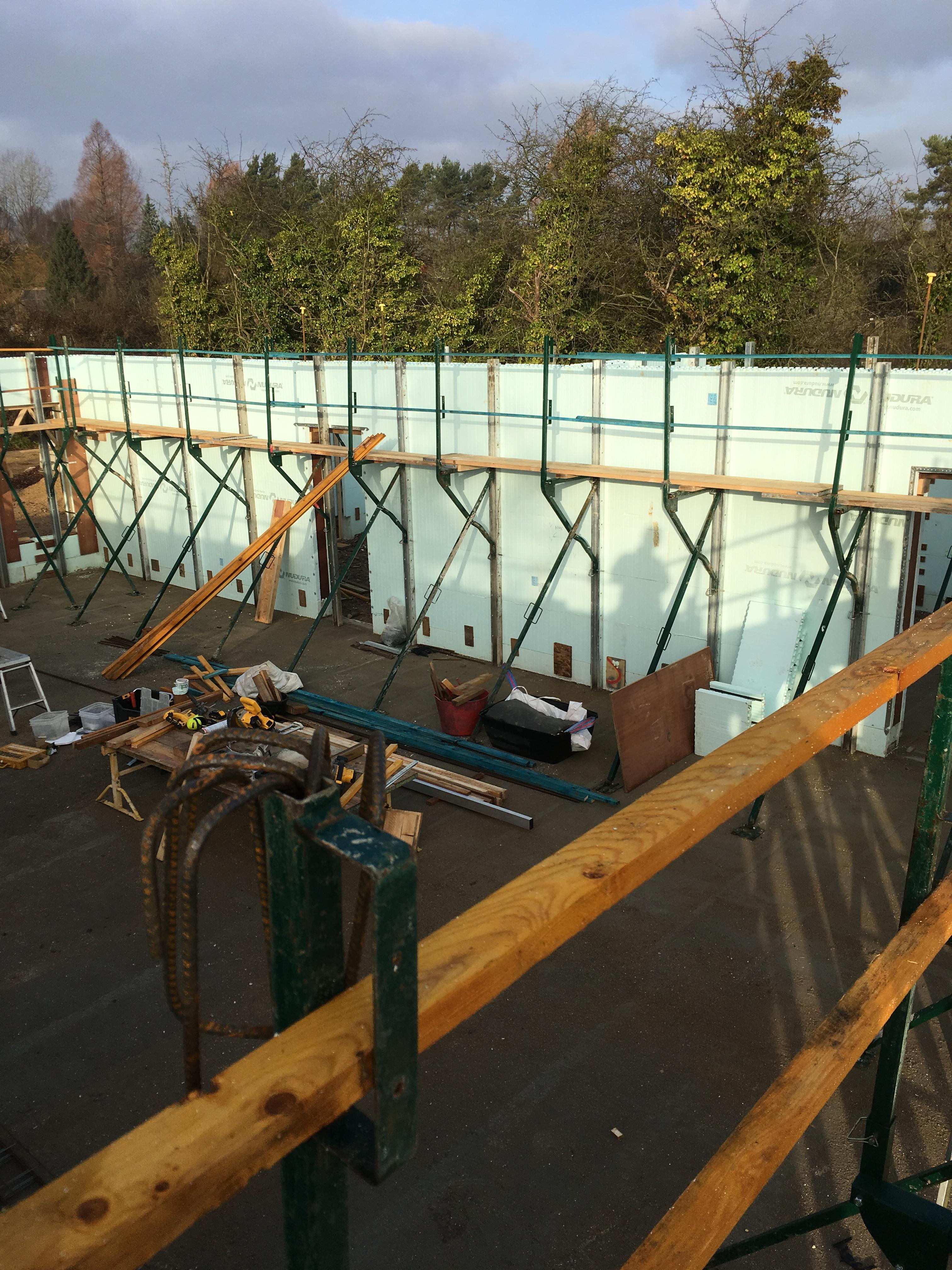

Russell griffiths Posted September 6, 2019 Posted September 6, 2019 Just be prepared for them to move and you will need to re plumb after you pour, I was surprised how much they move about with the concrete thundering in. Just make sure you have enough lads on site to carry out adjustments after it’s poured as it all gets a bit hectic.
Vijay Posted September 6, 2019 Author Posted September 6, 2019 Hello bud, Well I hope they don't move too much! They're now braced to the scaffold and I hope that by the time I've circled with the concrete pump, the concrete will have started to go off...........
ToughButterCup Posted September 6, 2019 Posted September 6, 2019 29 minutes ago, Russell griffiths said: [...] I was surprised how much they move about with the concrete thundering in. [...] Thats what 'got' to me. The wall rocked from side to side as if being hit by a huge hammer - 10mm back and forth maybe more. Mind you then final pour, I couldn't have cared less. I just prayed for no bursts - a 20mm wobble is nowt - but a burst 3.5 meters up is no joke.
Vijay Posted September 6, 2019 Author Posted September 6, 2019 Out of interest, how was both of yours bracing fixed?
Vijay Posted September 7, 2019 Author Posted September 7, 2019 Bit of searching and found this http://nhbccampaigns.co.uk/landingpages/techzone/previous_versions/2011/Part1/Section2/sitework.htm So who checks things are plumb??
Russell griffiths Posted September 7, 2019 Posted September 7, 2019 Nobody, except a self builder just out of interest what has your icf supplier told you to do with the bracing. We were told to lean the walls IN towards the bracing as when the concrete goes in the weight of it pulls the wall away from the brace and the whole system goes into tension. I plumbed mine 10mm out of plumb leaning hard against the braces, when the concrete was poured it was nearly perfect and just needed a tweak. As a word of caution, you can push a wall away from you but it is hard to pull one back, so lean them in, if they fall out it is a bugger to get back and you can pull the screws out.
Vijay Posted September 7, 2019 Author Posted September 7, 2019 He didn't say anything about leaning it either way, just get them vertical. I'm a little concerned now as I'm almost dreading pour day (when it comes around) What gave in your bracing? How was your bracing fixed into the ground/floor/any other way?
Russell griffiths Posted September 7, 2019 Posted September 7, 2019 The bracing is all steel, but comprised of 4-5 components, so a foot plate bolted to the floor SOLID a cross brace and a brace on the wall this is all really good, what happens is all components need to be taken apart so they are fixed together with a large steel pin and a circlip. This pin has a millimetre of movement in it, multiple this by 3 pins and you get a fair bit of play. What I found is that the wall doesn’t weigh much, so you plumb it up, but it’s not really tensioned against the brace as it’s so light, you then make it really heavy by filling it with 20 tonne of concrete, it then wants to lean one way or another so it tensions up all those little 1mm of play in the pins and this is when it needs a little tweak to get it lovely and plumb. Its relatively straightforward, but don’t underestimate how many hands you will need that day. For the size of your place I think I would want 5 blokes 1 on the pump controls 2 on the hose 3 on the vibrator 4 cleaning up spills 5 running about untangling extension leads, looking for blowouts, fixing stuff. You will need string lines setup but out of the way so you can eye along the top of the wall as you plumb it. If you look at stones blog he has some good pics to show how to set the lines up using little blocks of timber at the corners, but I’m sure you know this stuff.
Russell griffiths Posted September 7, 2019 Posted September 7, 2019 bracing is very good, but it’s not made like a formula one car so it has a bit of rattling in it that you cannot eliminate until it’s full of concrete.
