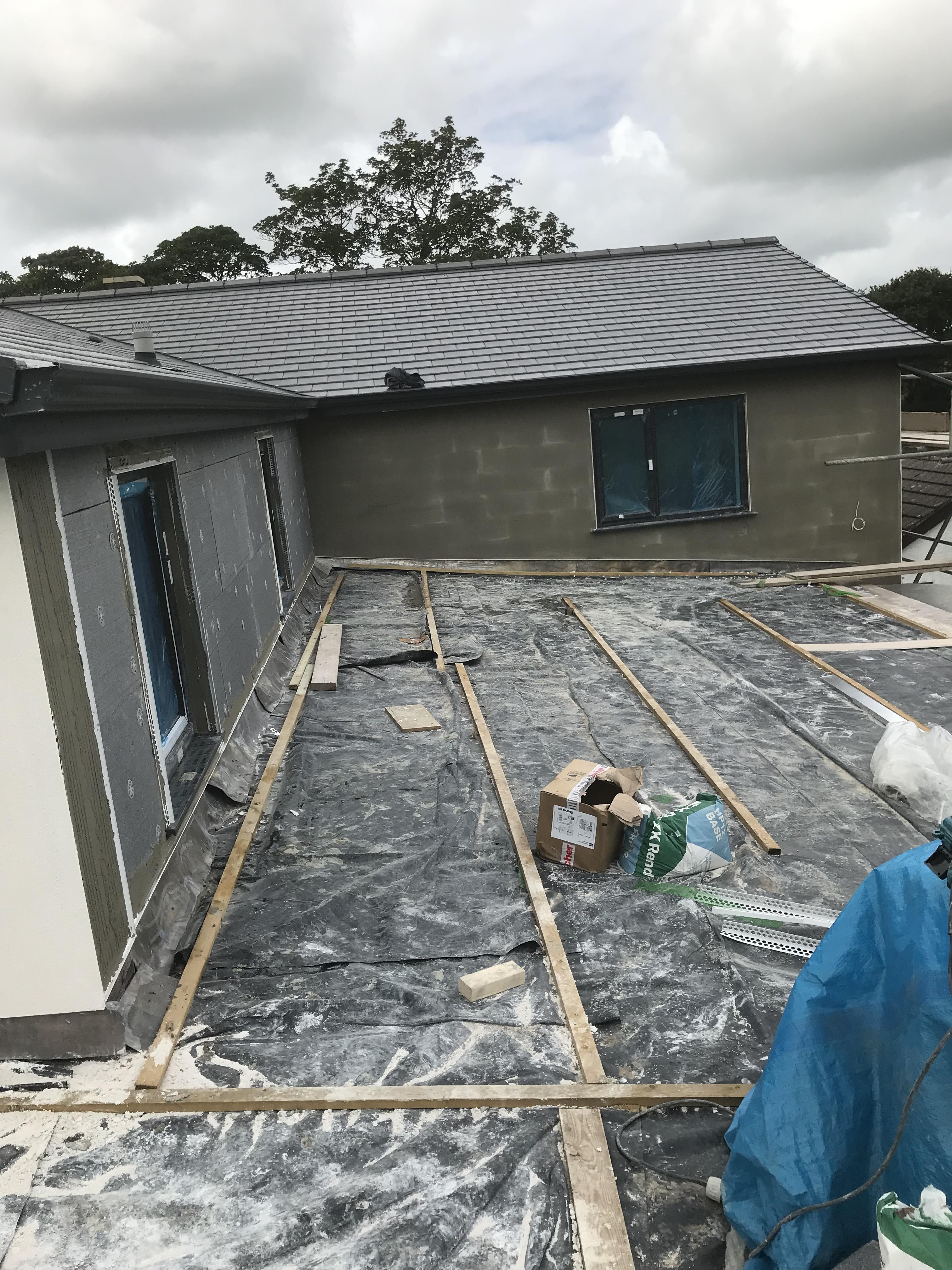

nod Posted August 17, 2019 Share Posted August 17, 2019 The majority that I render are simply pushed in place and the render bead does the rest I would stick them in place with stickall Then use basecoat to stick a render bead over Just lapping10 mil onto the lead Link to comment Share on other sites More sharing options...

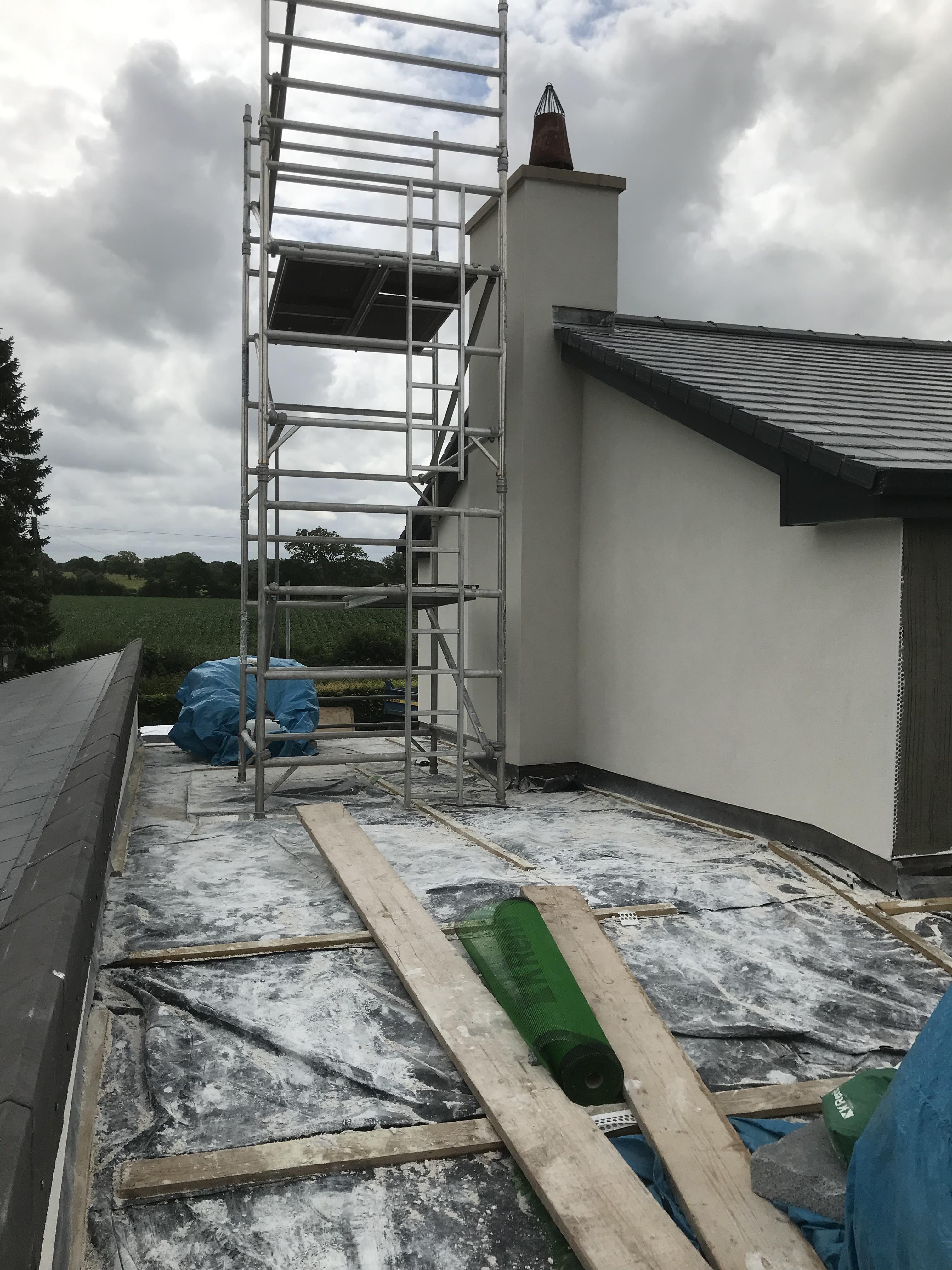

nod Posted August 17, 2019 Share Posted August 17, 2019 4 hours ago, willbish said: Thanks @nod thought the render bead would probably do most of the work @Russell griffiths yes ive' seen them, got a packet ready for the chimney lead work. I reckon banging them into EPS will just squash the foam and not create a good wedge but Ill give it a try. You’re welcome It’s quote surprising how strong a rendered bead over lead is and nothing will get through pictured below is a rush job on a roof we’re there is little holing the lead in place One the render has set its lifted up so that the rolled steel roof can be installed All done now No cracked render No where for the water to get in Link to comment Share on other sites More sharing options...
