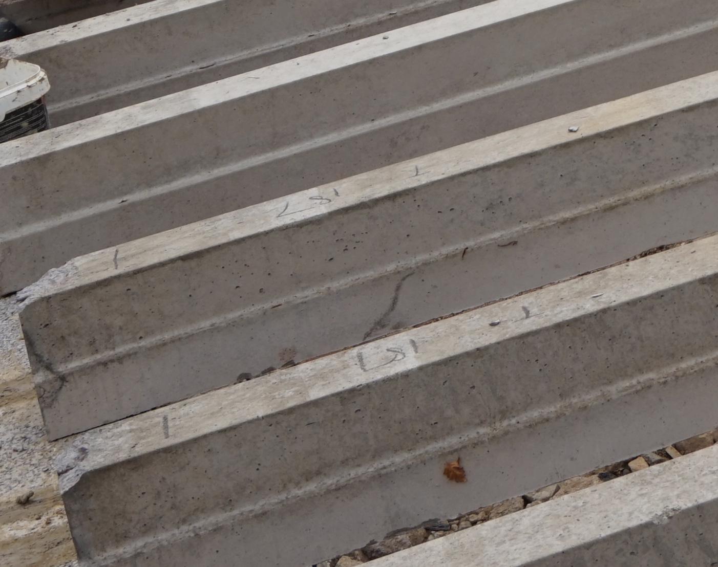

epsilonGreedy Posted August 14, 2019 Share Posted August 14, 2019 Is there any industry tolerance standard for how large a chunk can be missing in a concrete beam end before it needs to be replaced. This was transport damage. Most of my my beams are slightly oversized because they are dispatched from stock that is precut in 50mm increments, hence I can chop say 20mm off the end and still maintain a full beam end seat of 95mm. Link to comment Share on other sites More sharing options...
Russell griffiths Posted August 14, 2019 Share Posted August 14, 2019 (edited) I think you would be surprised how knocked about they get on a building site, it would need to be very damaged to not be usable. Picture. Try not to cut them as it’s a ball ache. Edited August 14, 2019 by Russell griffiths 1 Link to comment Share on other sites More sharing options...
Russell griffiths Posted August 15, 2019 Share Posted August 15, 2019 like this. Link to comment Share on other sites More sharing options...
epsilonGreedy Posted September 4, 2019 Author Share Posted September 4, 2019 On 15/08/2019 at 07:09, Russell griffiths said: like this. My chips were at the bottom load bearing point where the beam sits on the footing wall. Anyhow now the beams are installed I have been able to inspect the chips in the relation final installed position the the actual percentage reduction in load bearing seat due to the chips is tiny. Do your beams rest on a mortar + dpc bed? Link to comment Share on other sites More sharing options...
