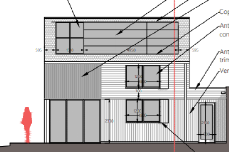

ToughButterCup Posted August 12, 2019 Posted August 12, 2019 The schema for our cladding is for mixed vertical and horizontal boards on two faces and vertical only on the other two faces. What if I'd I wanted to -say - put up some diagonal cladding? Who can make me take it down and put up cladding as per the architect's design? I know the Planners could Huff and Puff, but what the Hell bro! Stuff 'em!

ToughButterCup Posted August 13, 2019 Author Posted August 13, 2019 2 hours ago, Russell griffiths said: Do you need that membrane with your wall build up??? [...] There is a design requirement for a membrane (Kloeber Permoforte NG) , so yes. Here's the relevant quotation from our BR submission Quote New walls to timber cladding: [...], coated with Non-com fire retardant. Rainscreen type profile (see Russwood R014) TBC. Fix with stainless steel annular ring shank nails to ex 25x50mm treated SW battens and counter battens ( horizontal batten to have chamfered top edge to shed water) on Klober Permo Forte breathable felt or similar to thin render coat And here is an early draft of our cladding plans Later drafts changed the orientation of some of the cladding to horizontal The darker area of cladding isn't .... (isn't cladding that is) Its a breeze corridor (sorry about the attack of Kevin - McC terminology) . It surrounds that corner of the house - the Winter garden - and is outside the heated envelope. I'd like to create a small shadow gap between the boards - say 10 to 20 mm or perhaps less, and change the orientation of the boarding in the upper half of the house from horizontal to vertical. I'd like to change the orientation for a small area, like this (beneath the roof and above the lower floor) and having a really discrete shadow gap between the boards would give a quietly sophisticated look .
