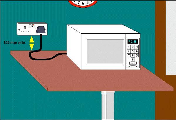

Onoff Posted August 6, 2019 Share Posted August 6, 2019 You may need the MK grid plate too if looking to change the duff DP grid switch from CED to MK and of course a second MK DP switch to match. It's good practice (as in it's in the electricians guides to building regs) for future reference, to have 100mm clear from the underside of a socket to say worktop (or in this case pipe) so the cable coming out of the plugtop is not unduly bent. Link to comment Share on other sites More sharing options...
daiking Posted August 6, 2019 Author Share Posted August 6, 2019 Obvs on the grid and plate. height is fine it’s the plumbing that messes up that space for the white sockets filling that plaster hole will be fun too ? Link to comment Share on other sites More sharing options...
